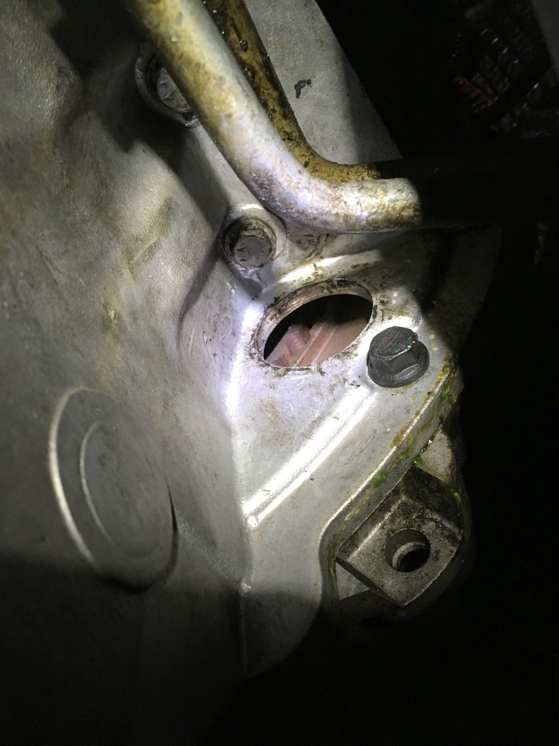

Hi guys, where can i get this part? I went to check if i have oil leaking but i found this. there should be a rubber cap. I just dont know where to find the part to get. I think its under the transmission. Not quite sure, I got disoriented that night this picture was taken. Thanks

This is what you want.
Oil Pan Grommet (Rear) (Genuine Part # ERR7229 ) - Land Rover gaskets and seals from Atlantic British
There is one on the starter side as well.

Another question please: Is the part inside need to be oiled? Seems dry inside, Thanks

Yea I took my oil pan off doing this HG job and I'm wondering what the purpose of that grommet is. Mine is way to loose to be any time of seal.

So yours is also dry? Im just afraid that a tiny pebble might got lucky inside.
You're looking at the ring gear for the starter (flywheel). It is supposed to be dry.
You remove the plugs to gain access to the 4 bolts that secure the TC to the flex plate. While you are in there, rotate the crank until each one appears in the open hole and confirm that they are torqued up 'cause they can loosen over time. If they are not, remove, apply blue loctite, and reinstall.
