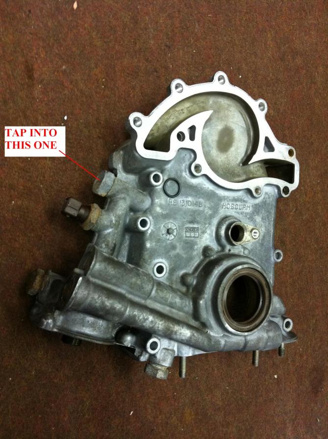

You can pull the plug above the oil pressure switch and tap a hole in it. That's what I would do.
See image attached. This is the cover from an '03.
Cheers!
