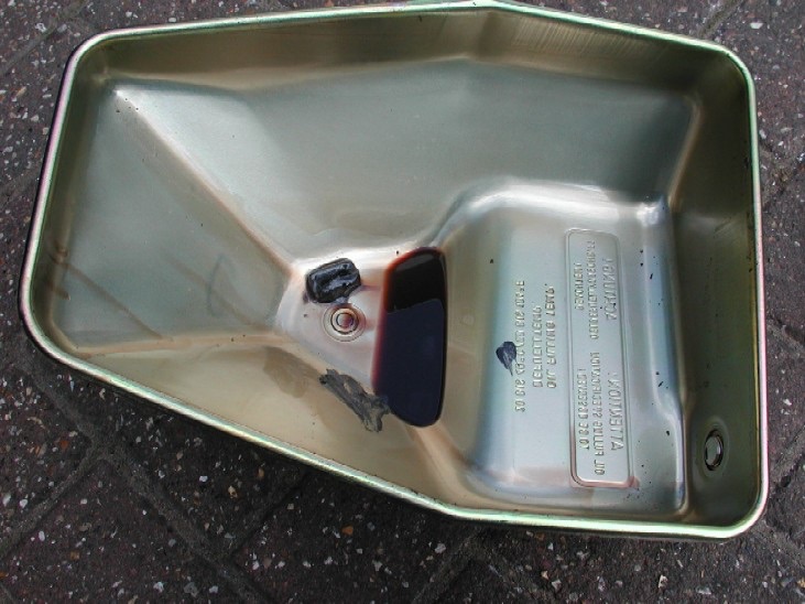

Old Nov 1, 2015 | 08:19 PM
  #38
chubbs878's Avatar
Posts: 1,387
Likes: 111
From: Dallas, TX
Default Trans sump
Similar to what my pan looked like when dropped
