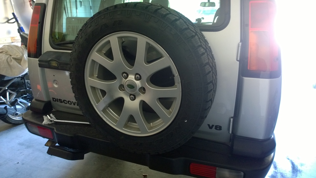

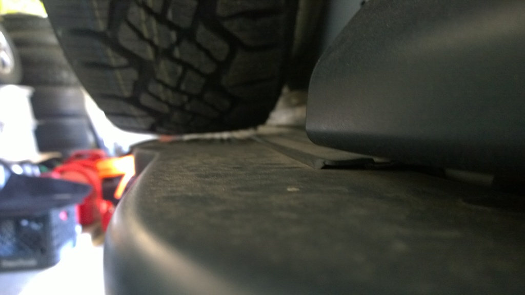

Got my spare wheel in yesterday. Took it to Discount Tire and had the tire installed. Mounted it up and it just fit 😊

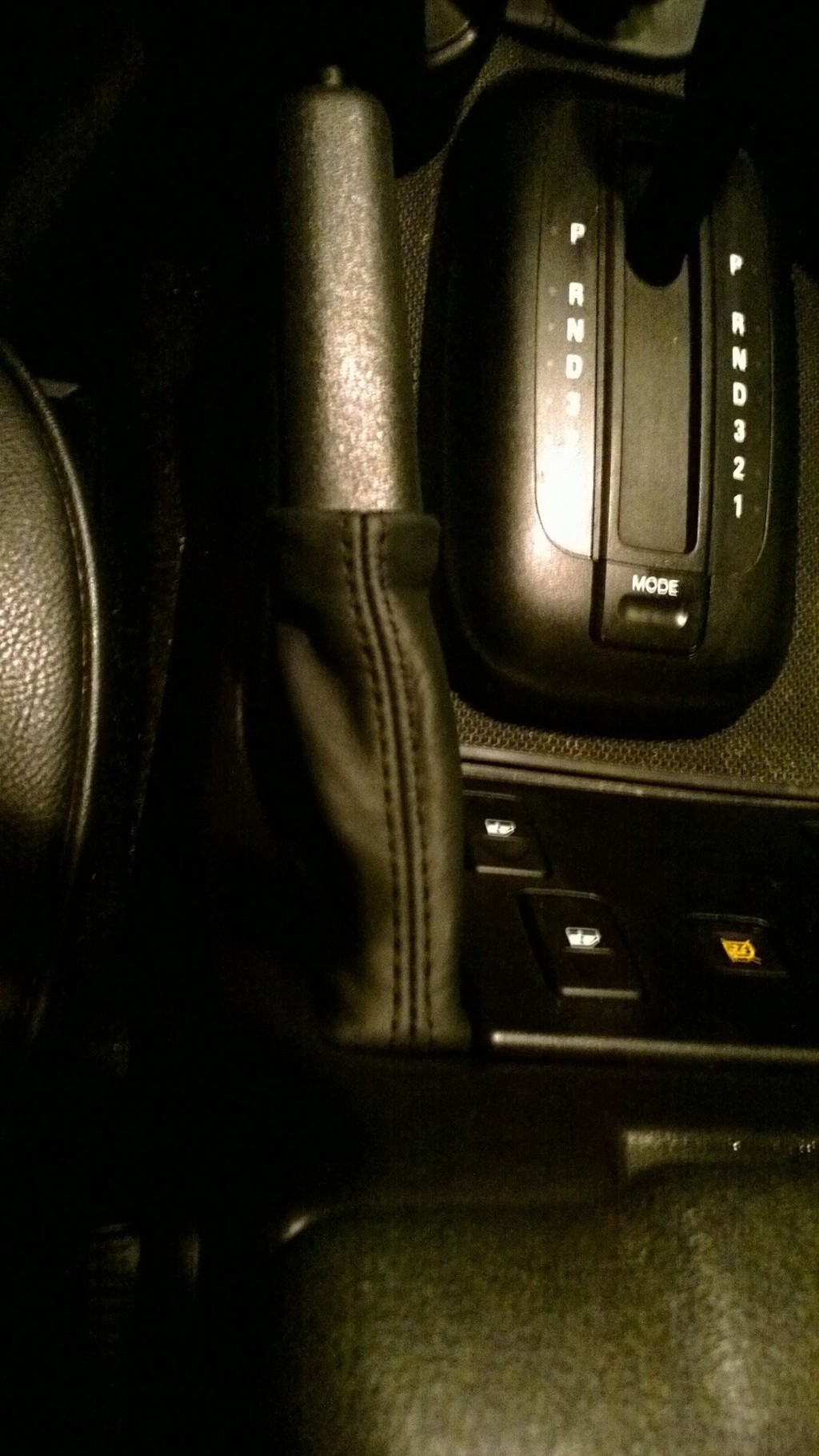

Installed leather parking brake boot and transfer case boot to replace those haggard original boots. Still working on cosmetics. Gotta hit the mechanical stuff soon!
