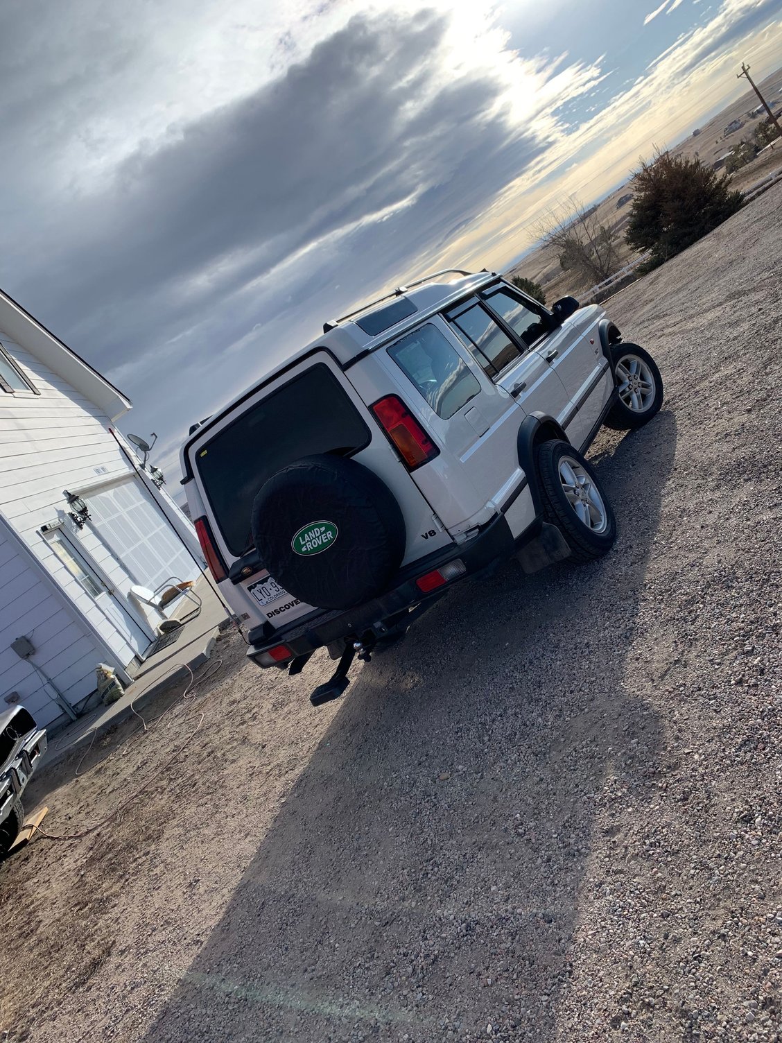

Just sorted out some leaks, turns out my exhaust leak was because, get this, there was no bolts left connecting to the headder on the left side, made a Lowe’s run and fixed that, also got a spare cover... looking to do a bunch more fun stuff with this bad boy once I get my silly dirt bike sorted!

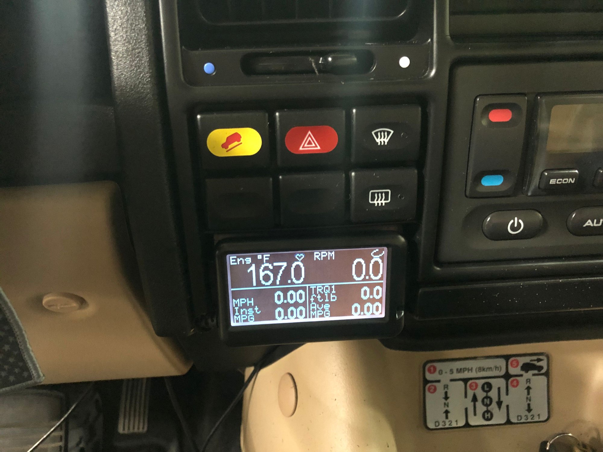

Like that screen size. Is this an Ultraguage?

Yes just got it for Christmas

If it's 167F ...while it's not running...so much for globe warming being a theory...lol.

Was messing around with the power on settings so the engine was running at some point . Still messing with the alarms and stuff currently
