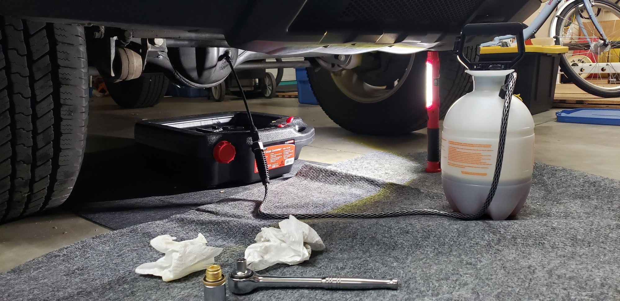

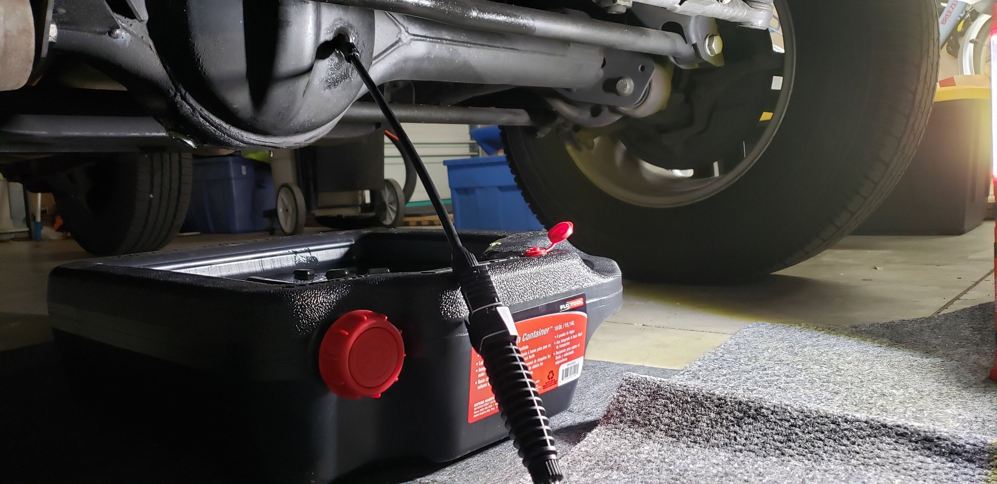

Front and rear differential fluid change using a Home Depot 1 gallon sprayer and Velcro to hold the handle down. Super easy.

Human ingenuity knows no bounds. Great idea.
