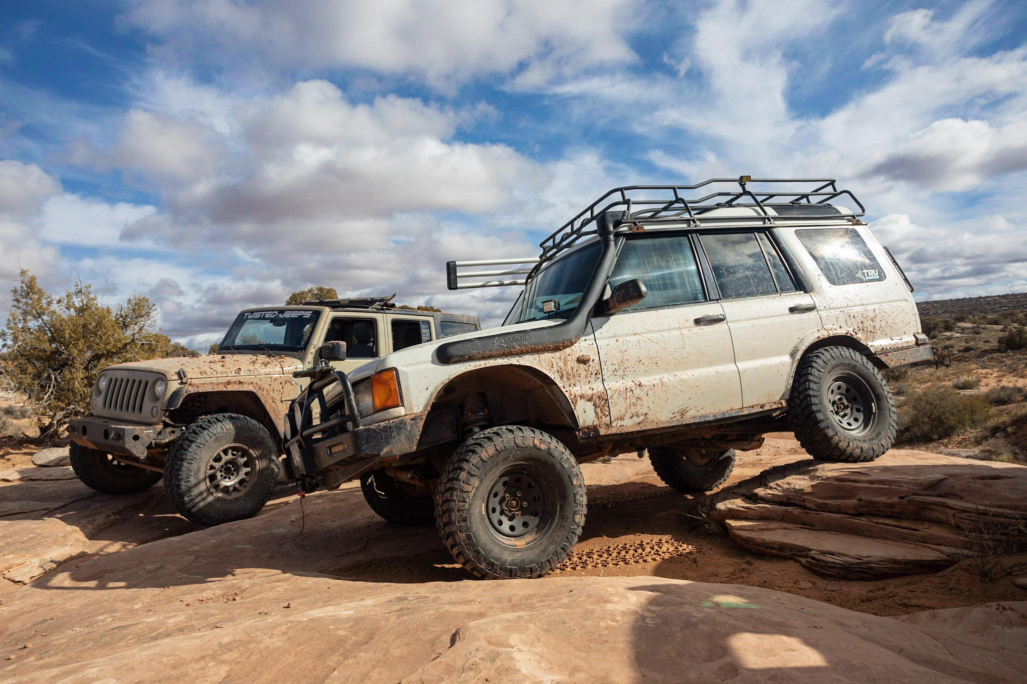

waiting on some video footage to see just how much flex she has now but there's plenty more than what this photo shows!
Big jump to get out of the drivers seat for the picture!

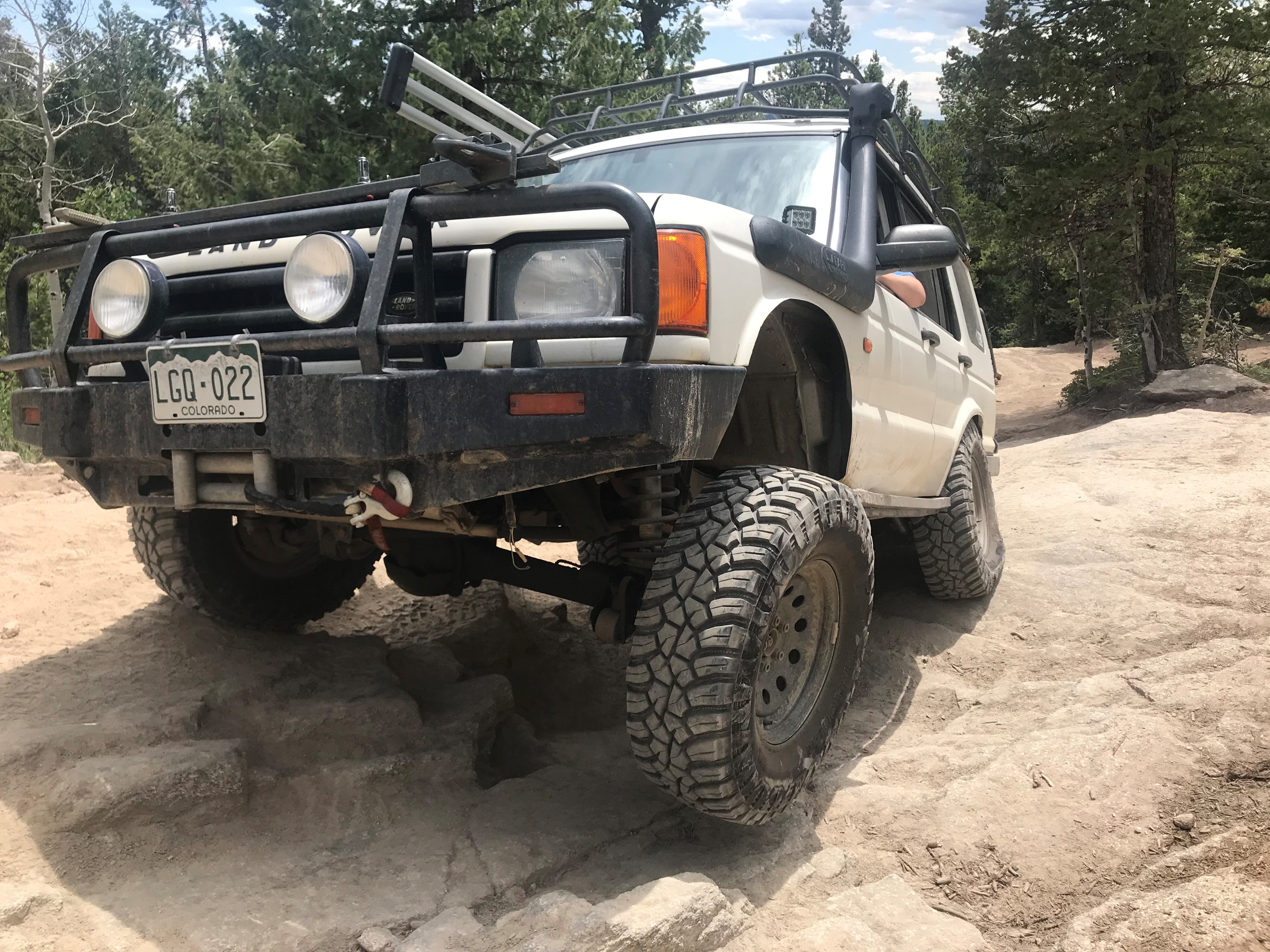

what’s your rear setup?
RTE 3" springs with TF +3" adjustable shocks, so roughly 11" of shock travel per side. Relocation cones and spring retainers. This weekend I plan on throwing 1" spacers back in the rear just to level things out a little more. I plan on picking up a RTE extended watts linkage this spring hopefully. Oh and no sway bar and extended brake lines. The tire will tuck up inside fender, pic for reference on old worn out springs.
