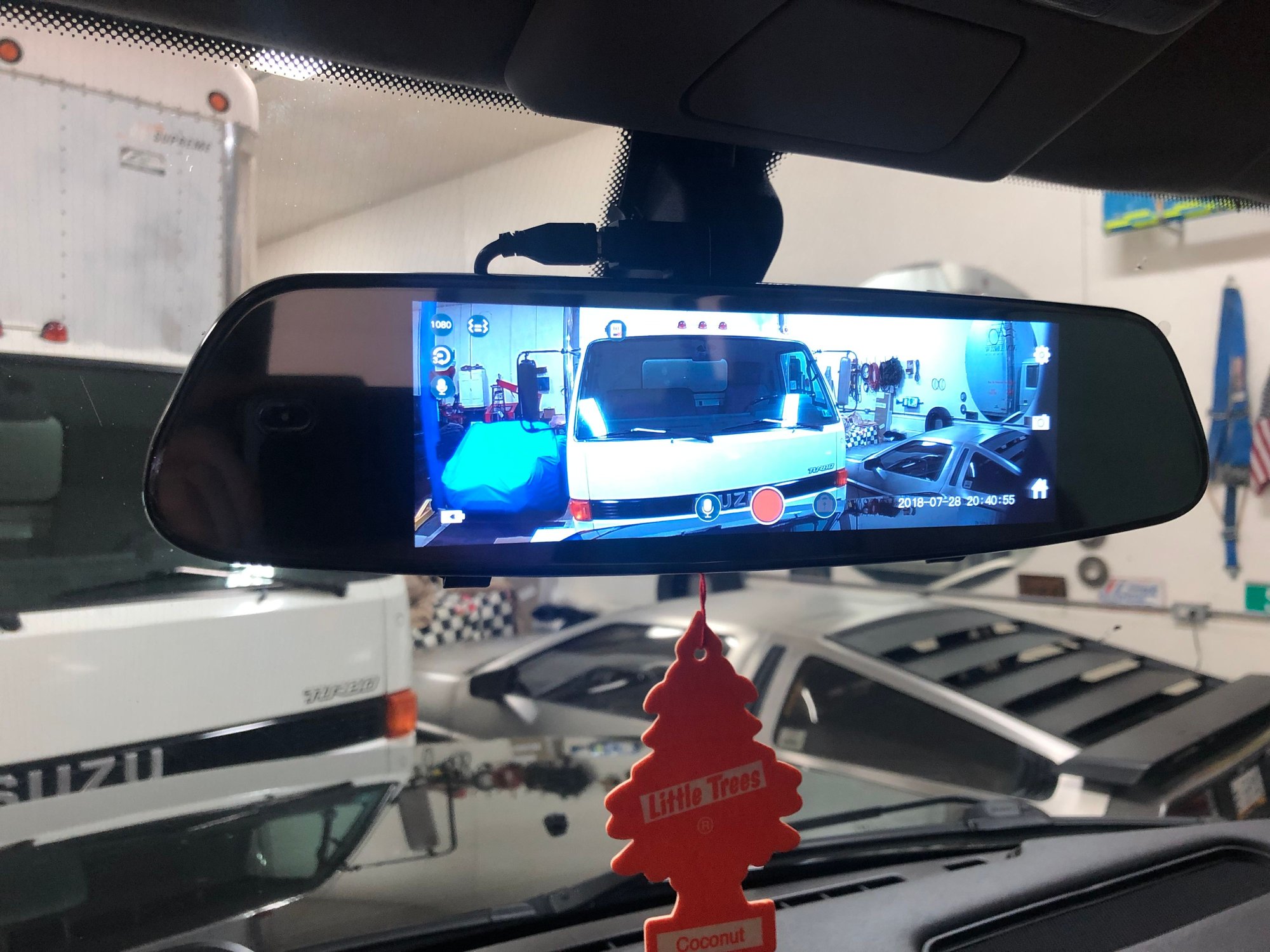

Installed a rear view mirror that’s also a dash cam and has a rear view camera that mounts in the back that also records

I need to get one of these.

It was only 80$ , it’s not the most impressive camera on the market but I didn’t want to have a dash camera stuck to my windshield this is a very discrete looking mirror

that is beautiful! Can you tell us which one that is

Dood! Is that a DMC DeLorean?
