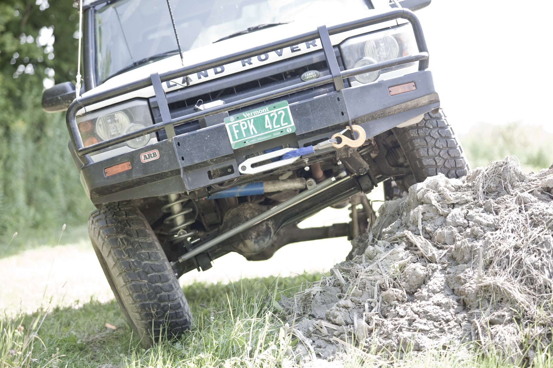

From: Burlington, VT
Installed new HD steering kit STEERING ROD SET HEAVY DUTY DISCOVERY II PLS006HD, TF255 - Rovers North - Classic Land Rover Parts
and Terrafirma adjustable panhard rod Product Details - Rovers North - Classic Land Rover Parts
Then did an alignment, it drives MUCH better now.
