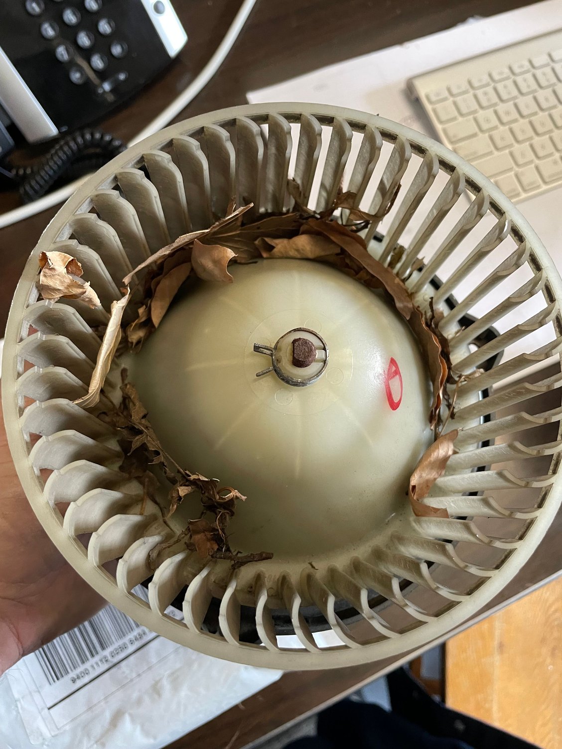

Replaced the A/C blower motor in my ‘03 Discovery due to weak airflow and it intermittently cutting out. Air output is much better and hopefully the cutting out is also fixed.
Just did the same this weekend but found a bit of a suprise as to why my airflow was so bad! Leaves removed and problem sorted!
Mine looked the same with leaves which definitely explains the airflow. Cleaning it out likely would have helped! I went ahead and installed the new one since it had been cutting out. I found a couple weeks ago that hitting the blower started it back up so hopefully my replacement solves that.

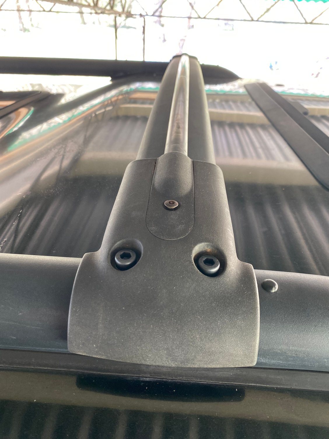

Finally got the second crossbar installed.
i had to drill out the plastic screw plugs.
m8x1.25 tap
M8x1.25 x 35mm length Allen head bolts do the trick.

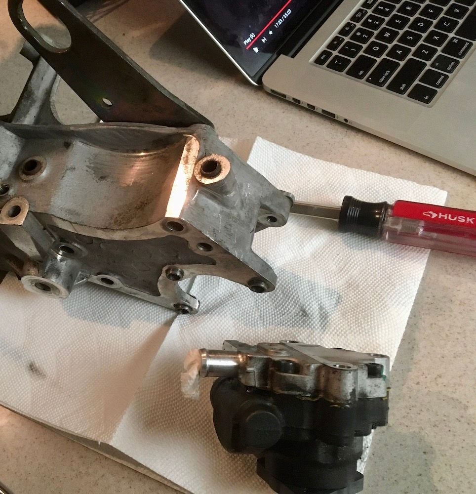

Replaced the main seal for the power steering pump and now my steering is working great; there are no more (new) leaks in the driveway!
