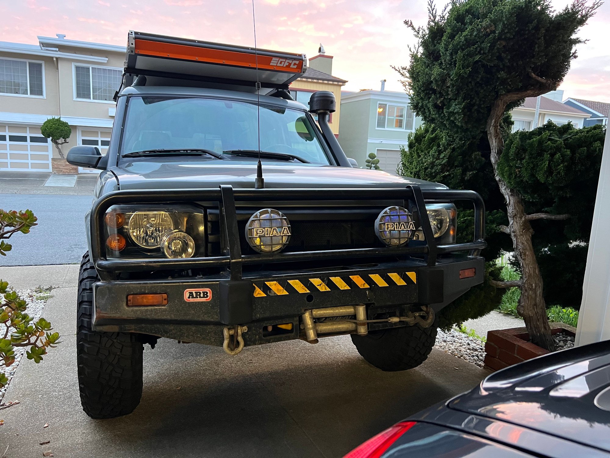

Headlights were getting a little foggy again so I did a quick polish on the car. Need to take them off and do them proper followed with a sealant so they don't fog up again. Also need to install my synthetic line and new fairlead and fix that bent one LOL. A never ending list of tasks for this one.

I did you seal the headlights? I tried with silicon but that didn't last long. I probably need to put them into the oven, rip the lens off and seal them with new headlight seal properly.

I haven't disassembled them that far but I'm planning to do a retrofit sometime this year. I just meant I need to seal the plastic lenses because I polished them and they'll turn yellow if I don't finish them with a UV stable spray.
If you took yours apart, I'd recommend some butyl to keep it from leaking.

I did you seal the headlights? I tried with silicon but that didn't last long. I probably need to put them into the oven, rip the lens off and seal them with new headliner seal properly.
pull them apart and redo the seal. Theretrofit source sells the gasket material as you might as well do an HID projector retrofit if you're pulling them apart imo.
