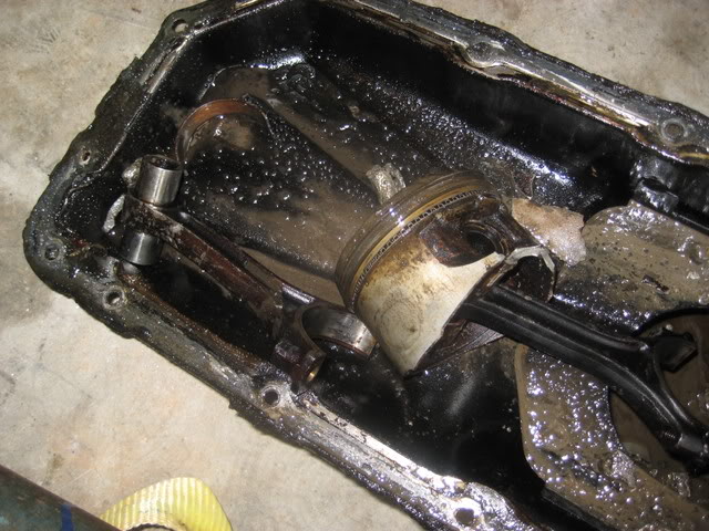

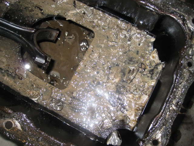

Sorry to hear about the engine, drain the oil and look to see if there are any metal flakes and its probably mixed with coolant and that will give you a better look at things but other than that the only way to tell is tear the engine apart and find out. been there done that and here are a few pictures of the disaster that i bought. Its never good to give a car to a mechanic when you don't know what needs doing and before you get quotes, i don't trust mechanics and im only 17 hah
These are the pictures of my oil pan with the pistons i had to remove to turn the engine over

And its never good when you see this in your oil pan

No problem. Thats what happens when you use block sealer to fix a head gasket. Previous owner of course hah
