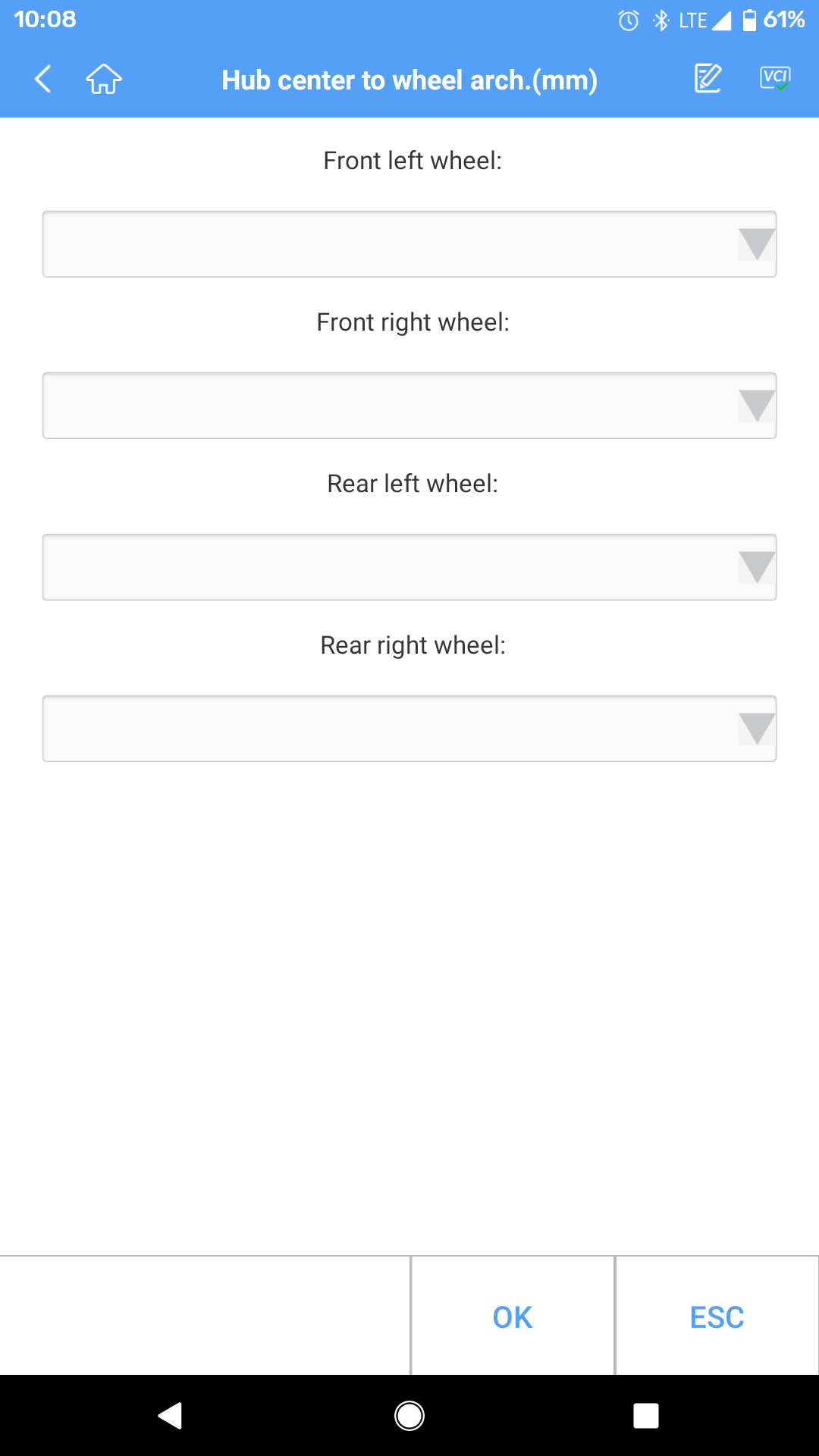

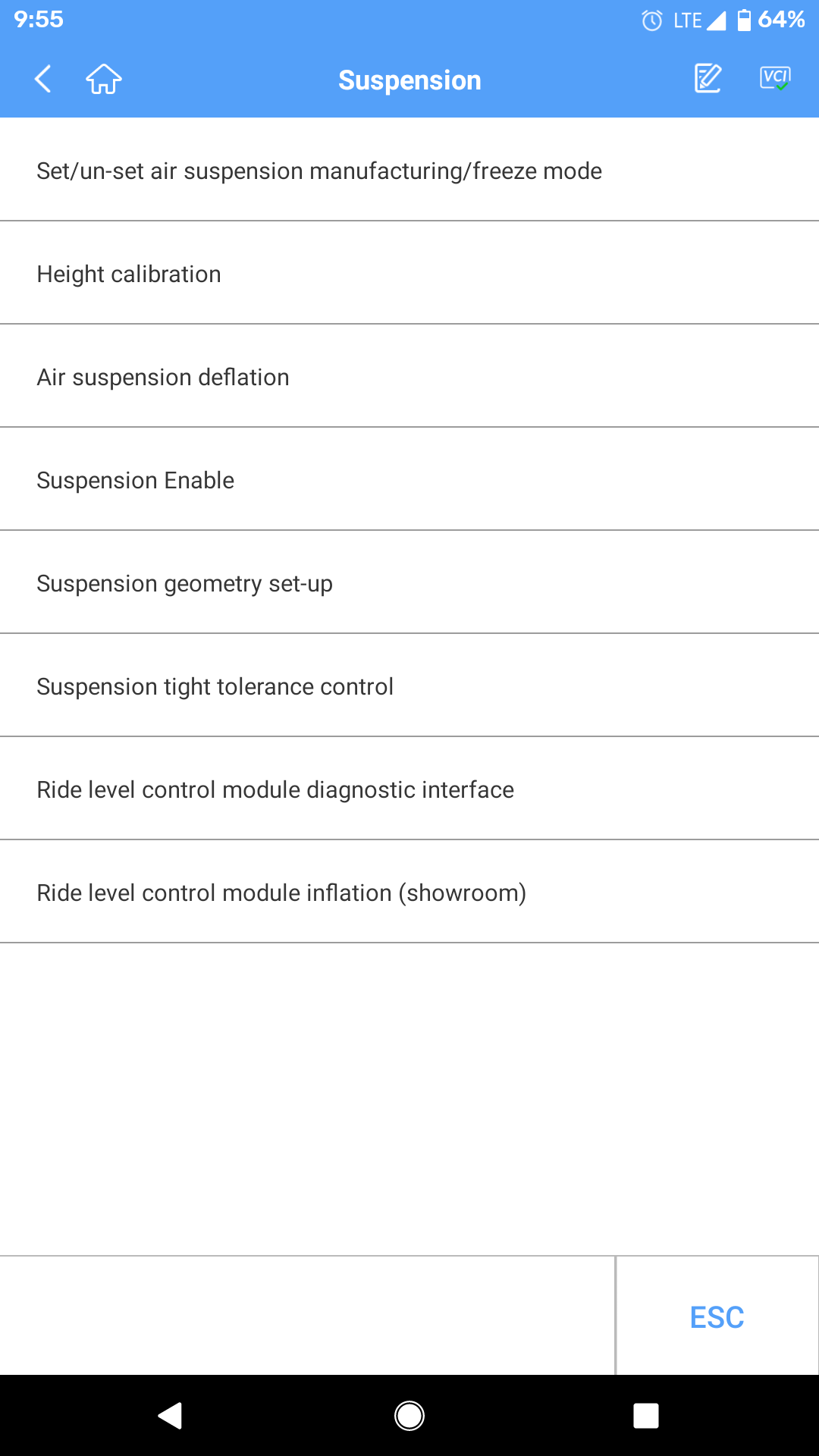

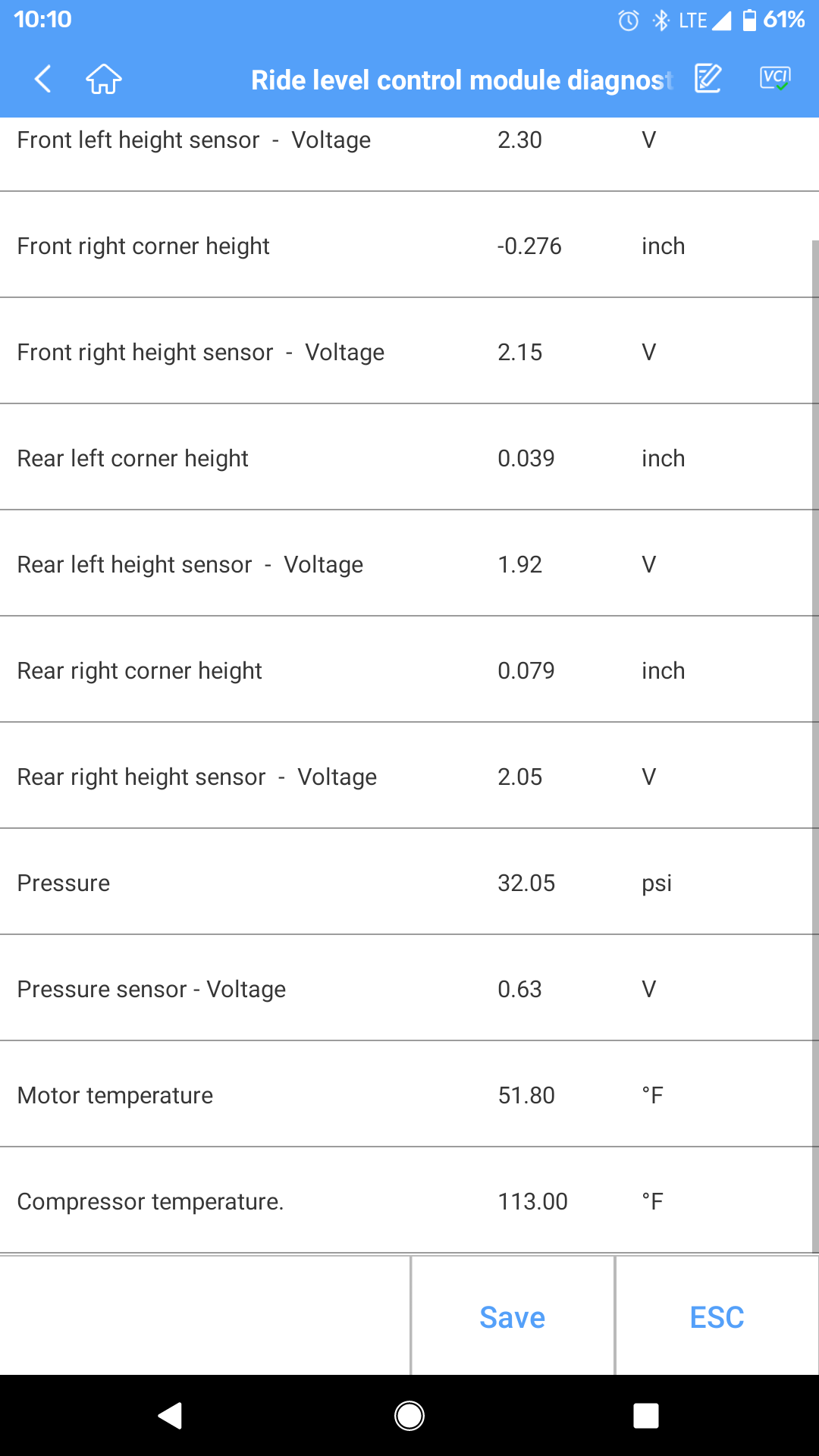

Today I re-calibrated with it, worked great. I think? I didn't make a major change, just leveled it out better and added 10mm, barely noteworthy. It does save logs of all changes and files that you can recall I suppose. I didn't save it as a new lowered position or new raised position, I just did a recal of my normal ride height, which you could lie about of course to raise or lower them all together. Perhaps I should have tried to do it another way but I was just playing around having fun with it. I didn't track much in the way of changes but it appears at the moment to be leveled out better and I believe it included the small 10mm lift, which is just under a half inch, slightly hard to confirm because it's so minor.

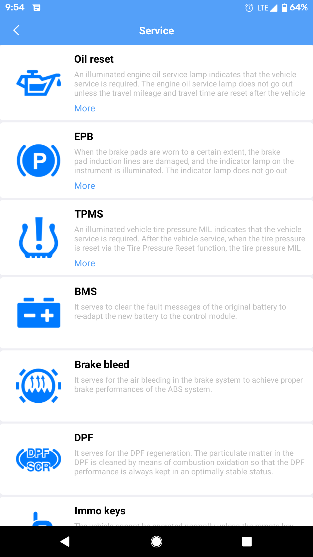

I tried to fix mine in my scanner tool and it seemed to be already fixed...... that's when I realized the spare tire sensor is included in the sensor pool data.

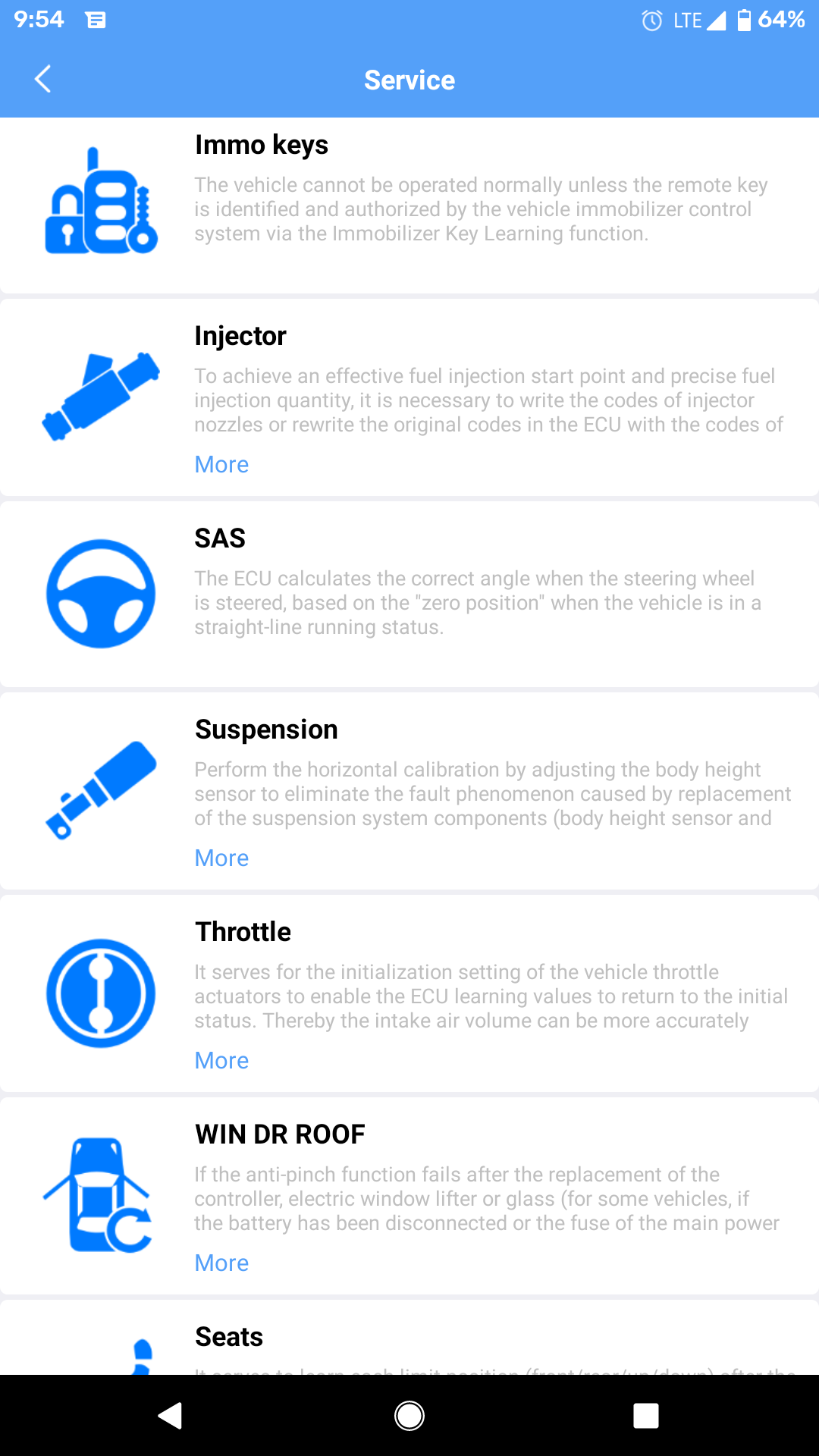

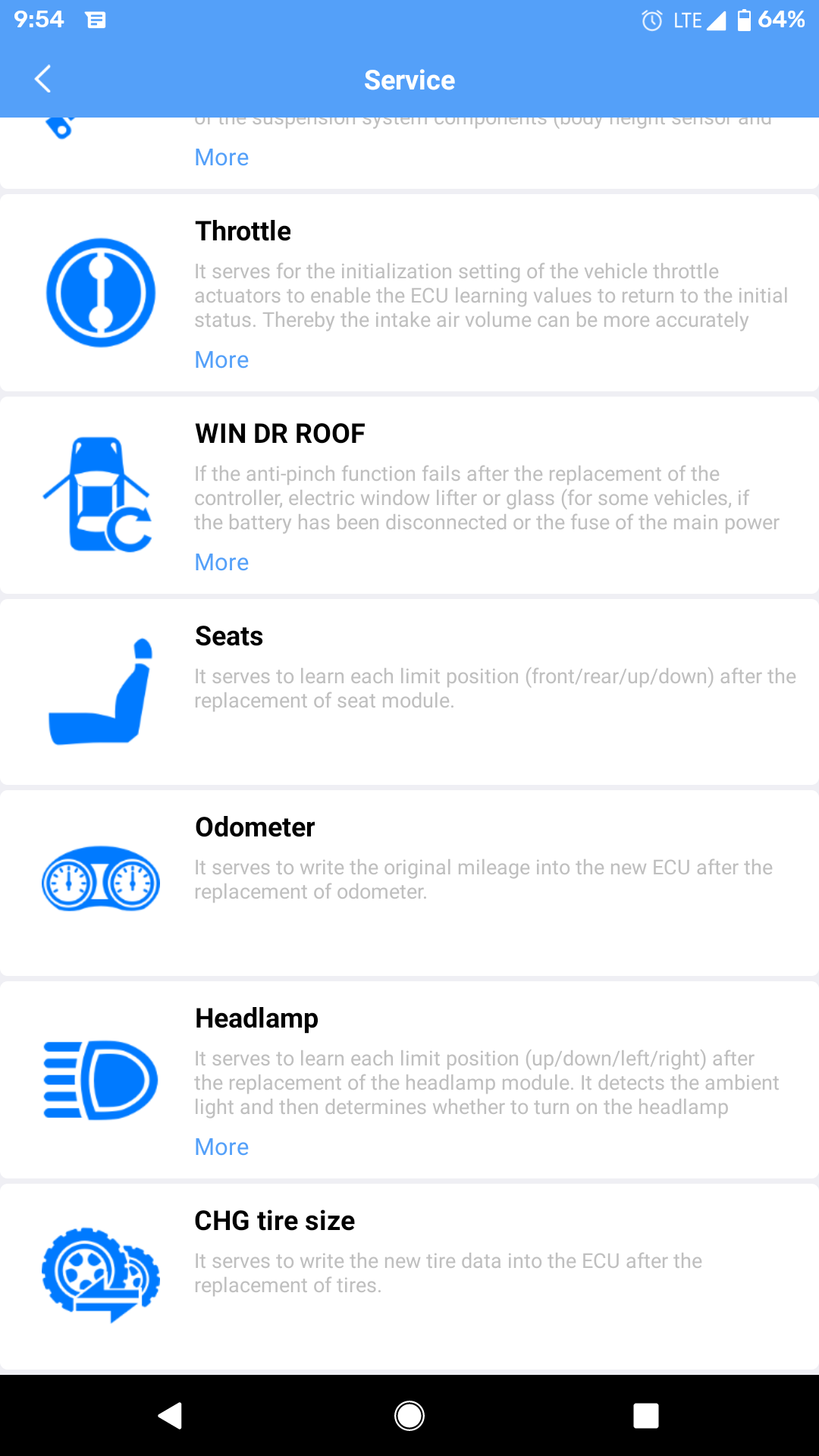

Here's some screenshots I saved for folks to look at this tool if they're interested. Hell it's amazon prime with free returns.....no risk.
