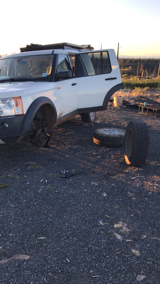

Put on my spare tire.
I had noticed my front left was a little low before a weekend trip to the Fremont-Winema National Forest. Topped it up, checked for any obvious nails, found none, and then drove hours from home and then miles into the desolate and beautiful Oregon Outback. Decided to check the pressure Saturday night, and seating the gauge was the straw that broke the camel's back for the aluminum TPMS valve stem. Cracked. With tire deflating fast I got the spare installed by sunset. With miles of washboards and then highway to go on Sunday, my decision a few years ago to buy a full size spare wheel and tire to replace the space saver in my SE truck was vindicated. Knew it would come in handy one day.
Did research tonight and ordered a couple of new sensors (one to replace, one as a road spare). I hadn't heard of it but did find a few threads on here of others who've experienced the same issue. Apparently in 2018 the original Siemens TPMS design was updated with a compatible unit made by Continental with upgraded hardware. From a vendor website:
Notes: TPMS 315hz. OEM by VDO please note to a change by VDO in 2018 Part # SE53001 was changed to SE52081 From an application stand point, they can mix and match; SE52081 will work with SE53001. The difference is in the sensor design. SE52081 is the newer TG1C design with upgraded hardware compared to the old TG1B SE53001, but they are functionally the same.
Only other fault for the trip was the flashing red PARK brake light coming on after a severe washboard up Paulina Peak. I waited until home to mess with it, but setting and resetting the EPB cleared it up. Despite the issues a great 600+ mile weekend.
