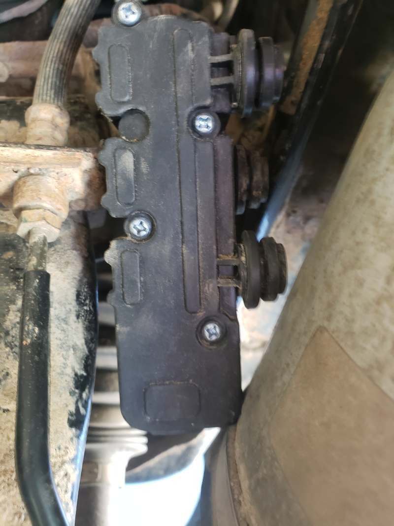

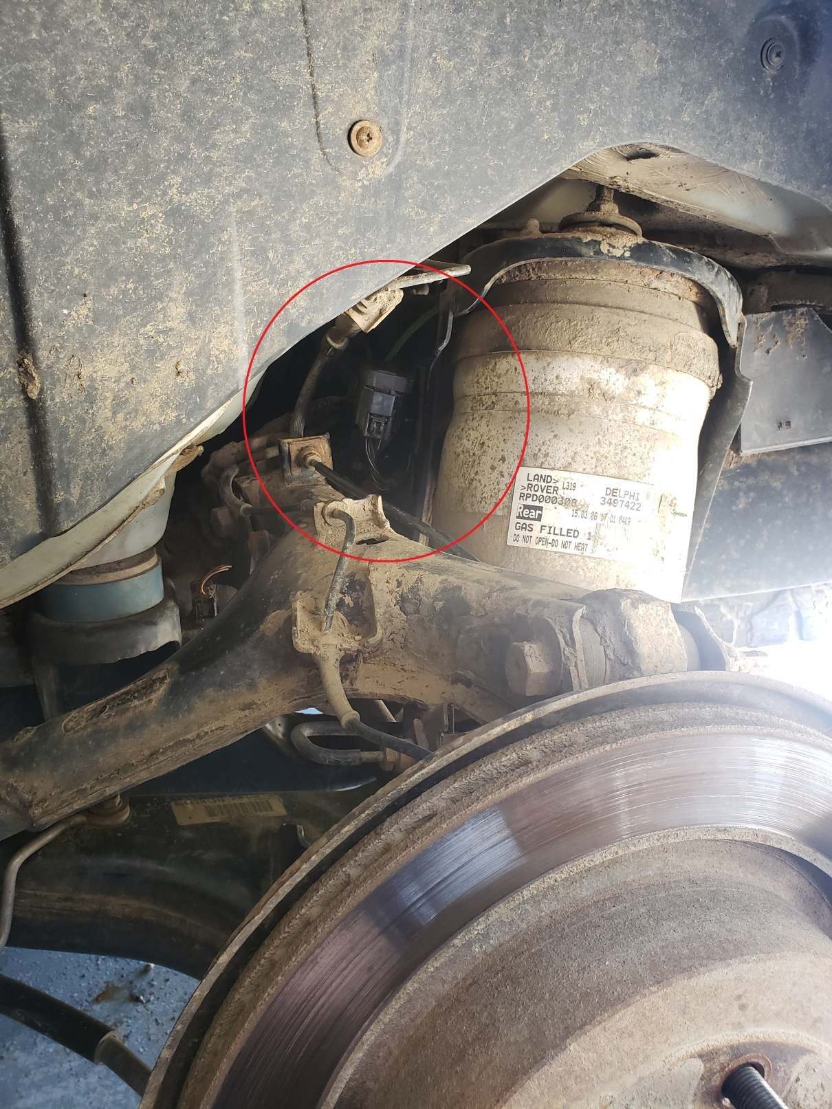

Replaced EAS rear air valve block. Fixed my sloooooow sinking. Learned my lesson on the front block leak to not ignore it and wear out the compressor prematurely. Maybe I lucked out and have slightly longer air tubes, it was easier than the front to swap out.
PSA - The replacement I bought on ebay was clearly counterfeit, but seems to be working. Should have bought it from the normal L8 or AB. The OEM have torx screws and LR logo on top. The Ebay ad conspicuously did not show this side:
Old Sep 3, 2019 | 08:38 AM
  #1118
Well either way glad it is up and working
