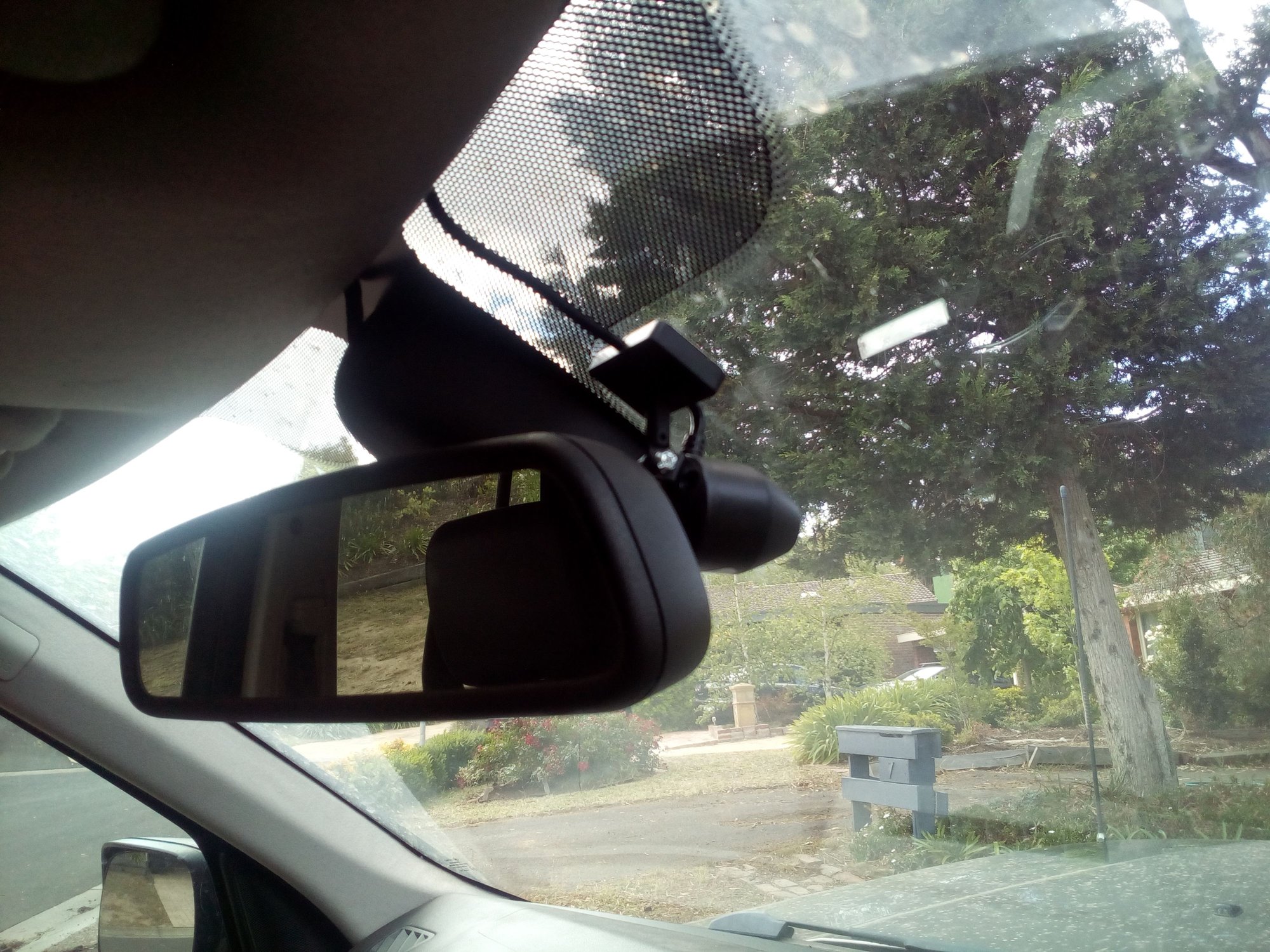

Fitted a dash camera to my android head unit and put it behind the mirror with the cable tucked into the headlining and then down the A pillar and under the dash to the stereo.

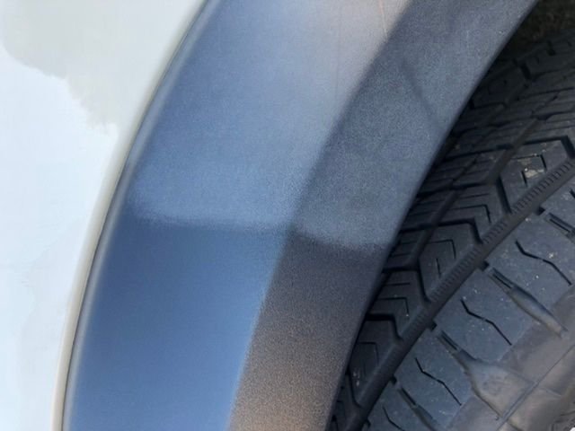

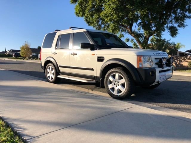

Today I finally got around to putting trim dressing on all of the exterior plastic trim and painted the intake vent grille black. I also moved my exterior temperature sensor to the small opening in the front bumper to get a more accurate temperature. Ever since I got my LR3 in September I noticed that the sensor would heat soak in traffic or after sitting parked when out doing errands and not recover and show temps higher outside than they really were.
Final product for the day.
