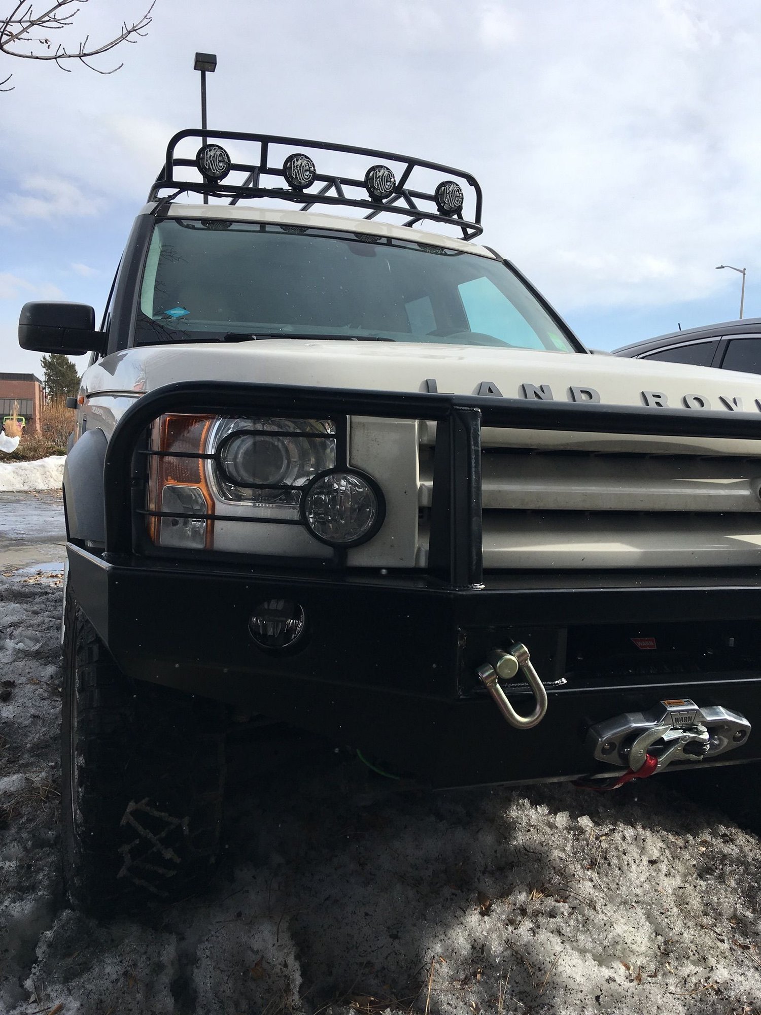

Converting my 2008 LR3 from daily driver to overlanding rig. Added Voyager rack, Proud Rhino bumper, and Hi-lites.
