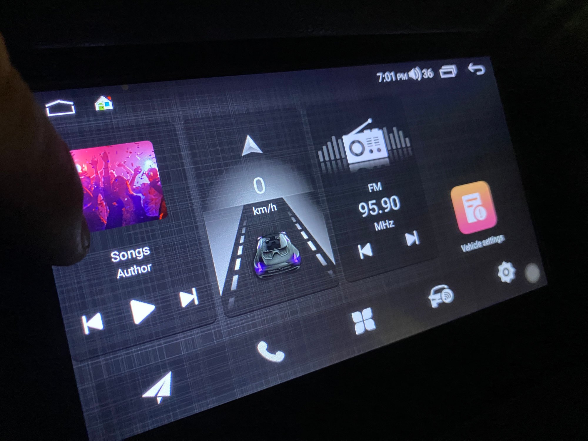

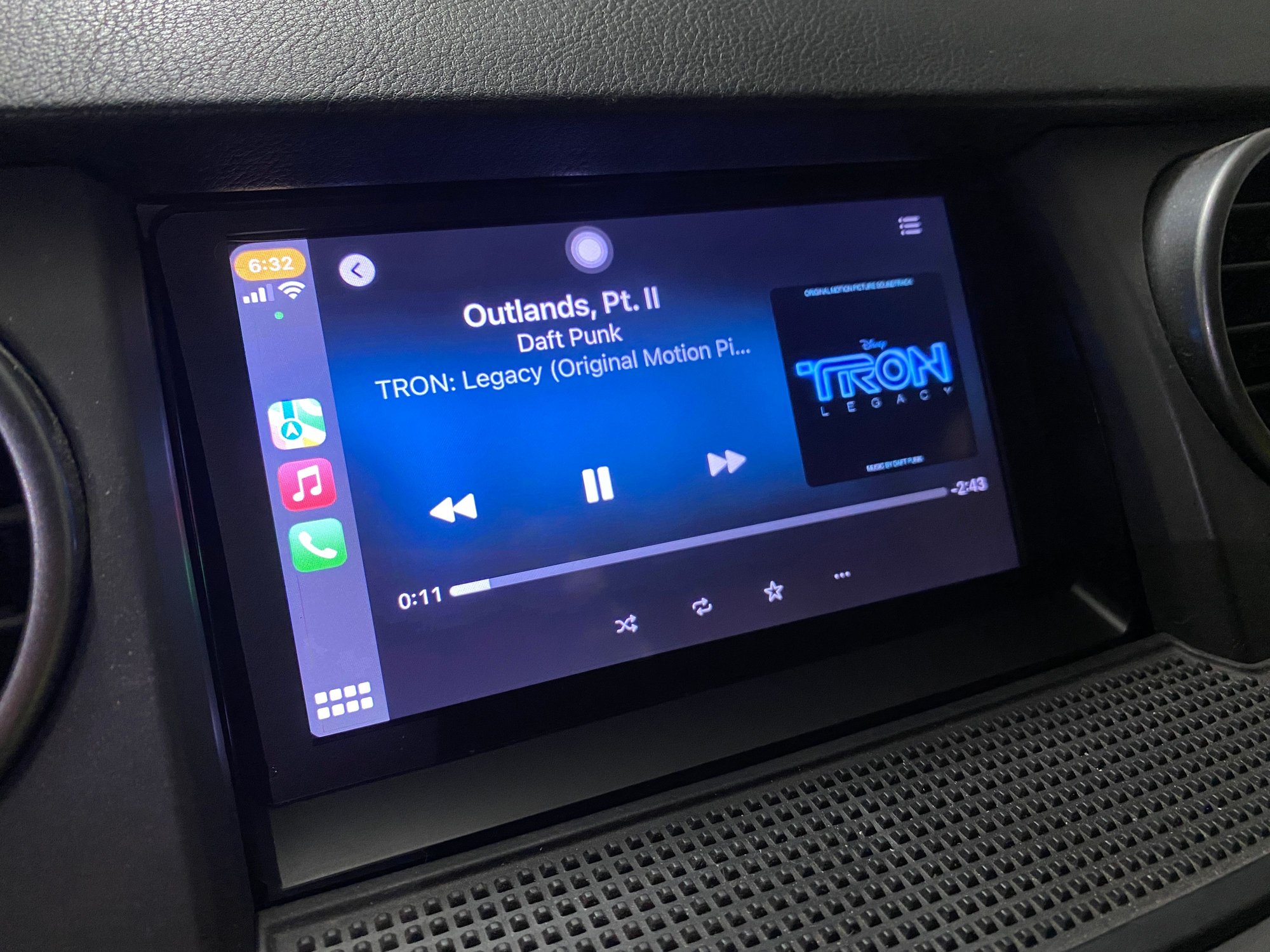

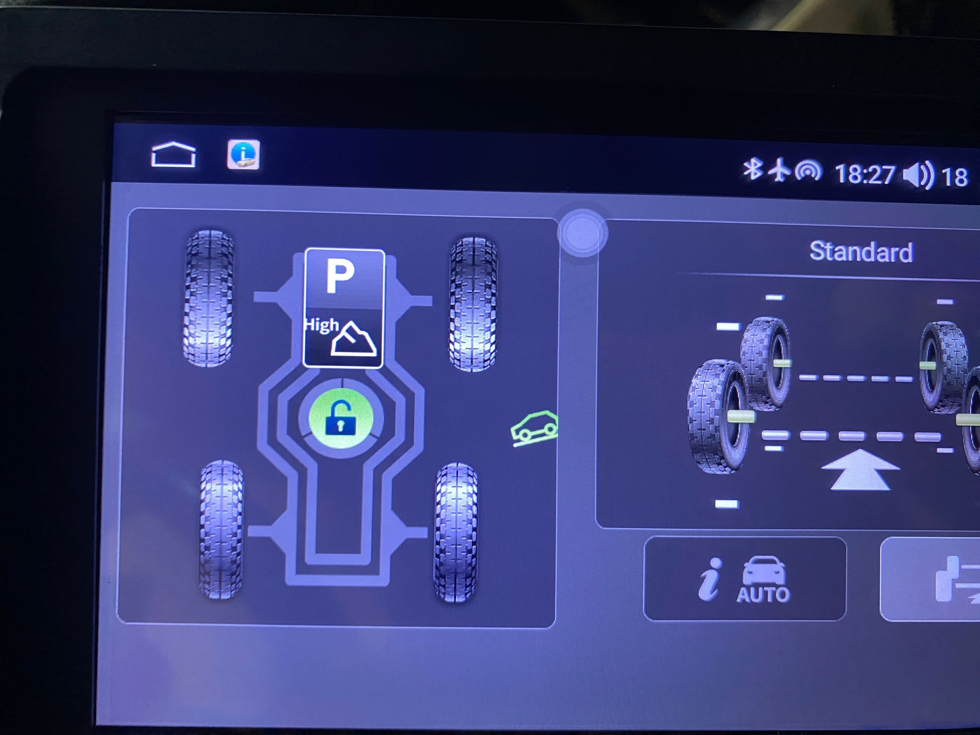

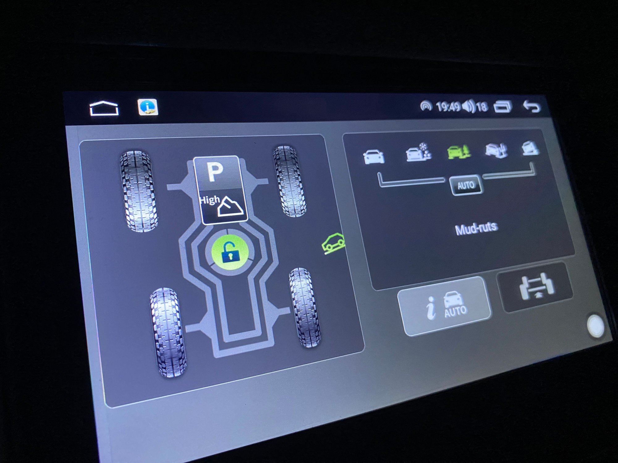

I did this today. I removed my LR4 display that has served me well for years and was a nice upgrade for any LR3. Then I tossed this thing in. I will have a write-up at some point about it. So I never really wanted to swap my Nav screen because I liked the 4x4 info. But recently at least one maker has taken care of that issue, sorta. By sorta I mean my rear locker does not show up, it may not for anyone I think. And the ride height display shows standard all the time yet the terrain selection screen does show the proper height selection. There are some other small quicks, but there is some pretty cool stuff too that I did not know about at all!

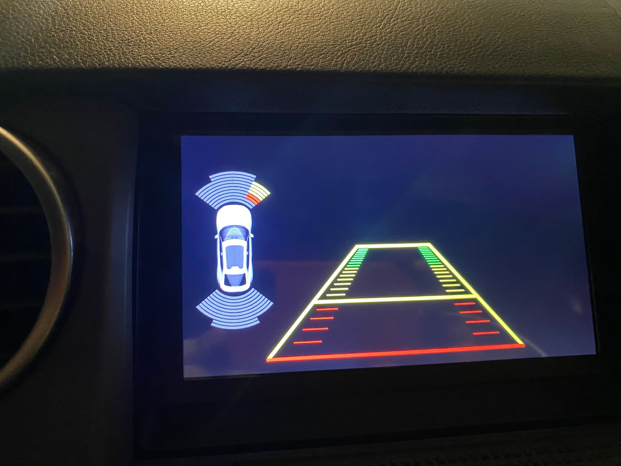

The steering angle sensor is read, so the 4x4 info screen actively shows the front wheel direction all the time. And the rear camera overlay (my camera is broke) bends the grid based on steering angle too.
If you open a door, an overlay of a generic vehicle pops up and shows you which door is open. Not sure about tailgate yet, but it does show the specific door.
When reversing you also get parking sensor overlay and it shows the specific sensors that are being triggered!
There is more to go over, I will put that in the write-up. But I gotta say that install was super easy, just messy with A LOT of cables.

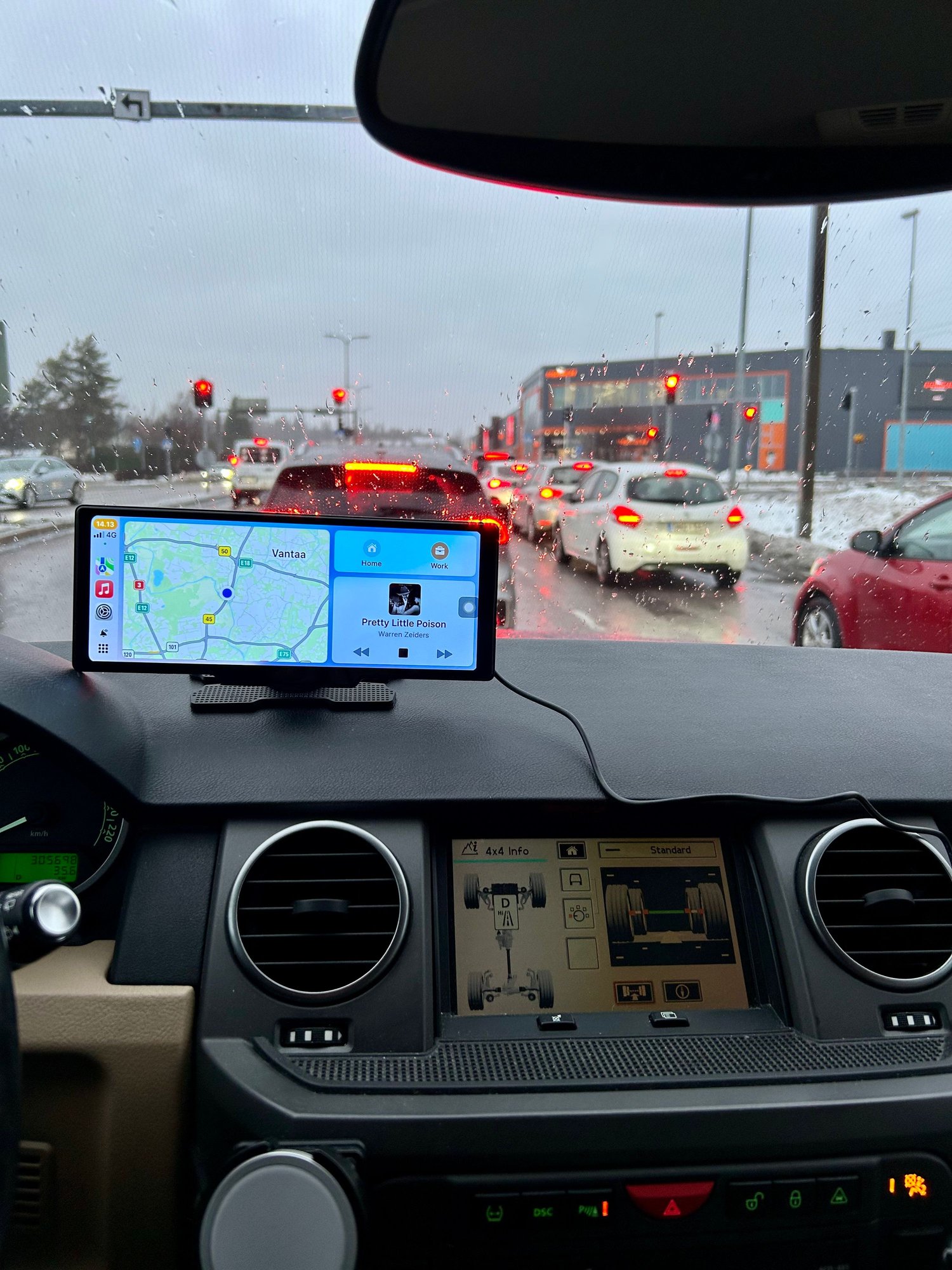

I got a few weeks ago a cheap CarPlay display for my D3 and eventually installed it today. Temperatures were above freezing so I figured that the adhesive would stick. In hindsight I should have installed it more center and slightly closer. The teens sitting in the right hand seat demand control of the playlist nowadays… can’t only listen to country music 😎😂
The display is crisp, responsive to touch. No idea about audio since I configured it so that the iPhone talks BT directly still to my mObridge over Bluetooth for calls and streaming (A2DP) and keeps that on the MOST bus. The phone also talks Bluetooth CarPlay to the display unit.
All that remains is to hide the USB cable better and add the rear camera.
