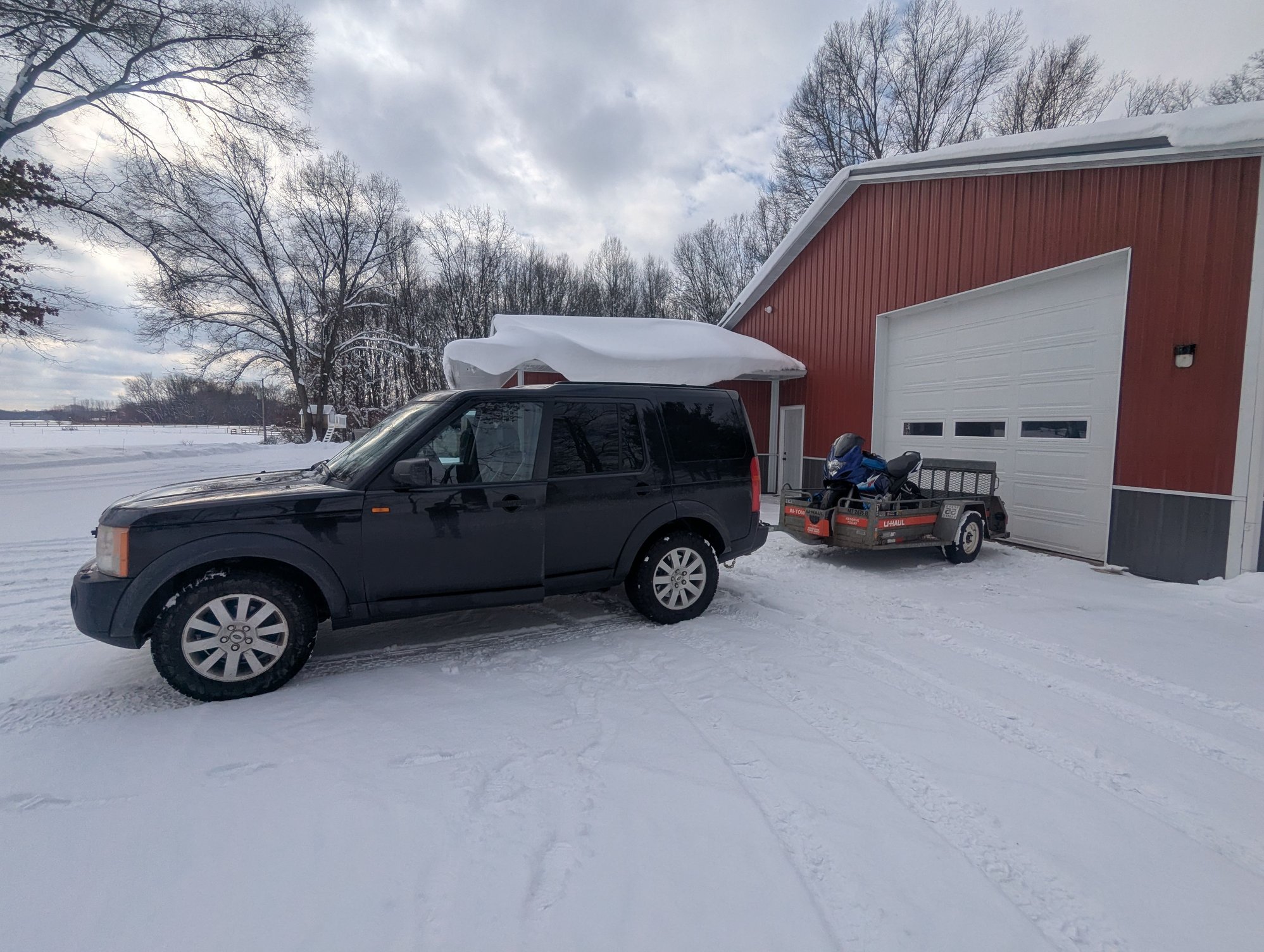

Hi guys!
Finally got to do something cool with my Disco! We picked up a Suzuki gsx650f for my brother. About three hours and 200 miles round trip and the truck didn't miss a beat. Not all that far I know, but my Disco has fought me on everything since I bought it. So I'm thrilled and genuinely surprised that this trip went great!
