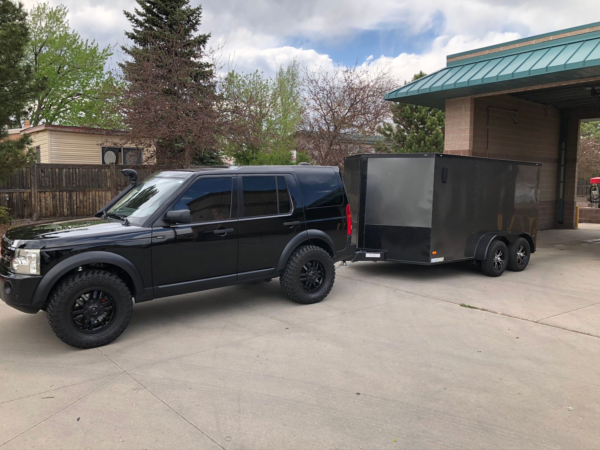

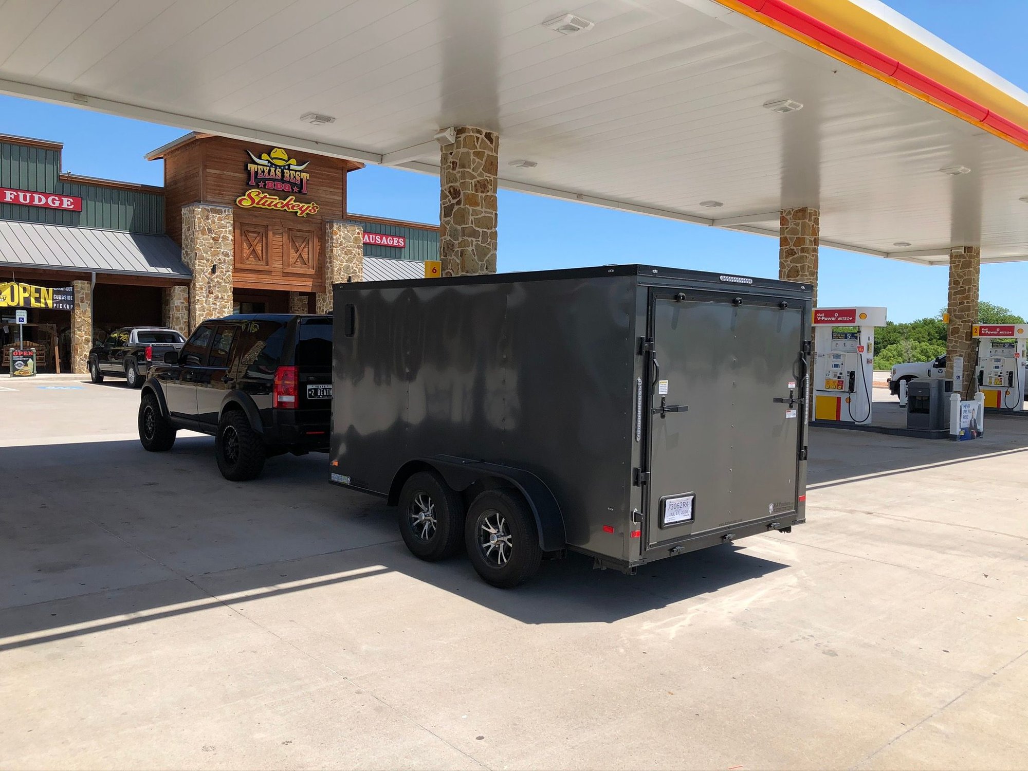

How was your LR for towing the trailer.
I have a 26' trailer, and would like to tow it with my LR3, but I have heard they have a tendency to sway a lot when towing at highway speeds. Don't want the tail wagging the dog if you know what I mean.
plenty of power just be prepared for your MPG’s to go bye bye. I find myself at the gas station more. I easily lose 75-80 miles per tank.
