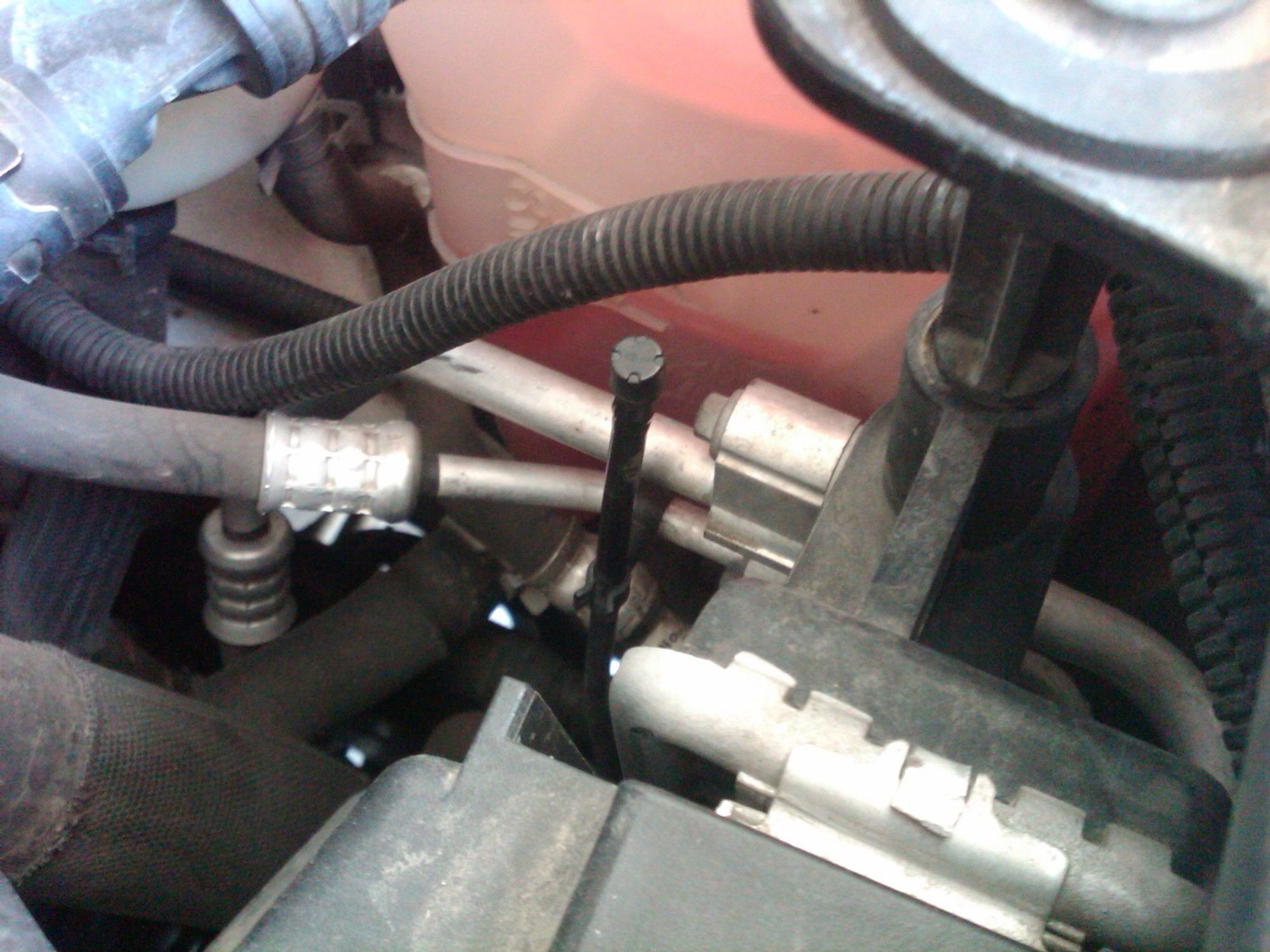

If you have a set of pruners or a sharp knife, you don't need to pay anyone. Just cut the old ****** off and push the new one on. Done and done.

Well that is true but when the temps are in the negatives, it is not so much fun plus sometimes the plastic can shatter rather than slice.
I am also a softie; my 3 is a grocery getter per the jpg attached so it has to go or I get hungry. I was going to get groceries the day I took the picture.
I note that the existing is best cut off at a 45 degree angle facing the rear for some reason per the second jpg in the bottom right corner.

Default Blow thru both the cut off old one and the replacement.
Below is what the factory installed breather looks like - just a cap on the end of a length of tubing.
When I cut the original off, I tried to blow thru it and it was not easy.
Also blow thru the new one before you install it and see if there is a the difference; I expect there will be.

Well I looked and got surprised, already have the new mod!

That's probably a good LR3 you found....the mod being there tells me that the PO knew some stuff about the LR3. That TSB was so uncommon that my local dealer didn't know about it. I had to print out a PDF of it and bring it in. So that is one thing I always look for when checking out an LR3 for sale. Hardly ever find it installed.
