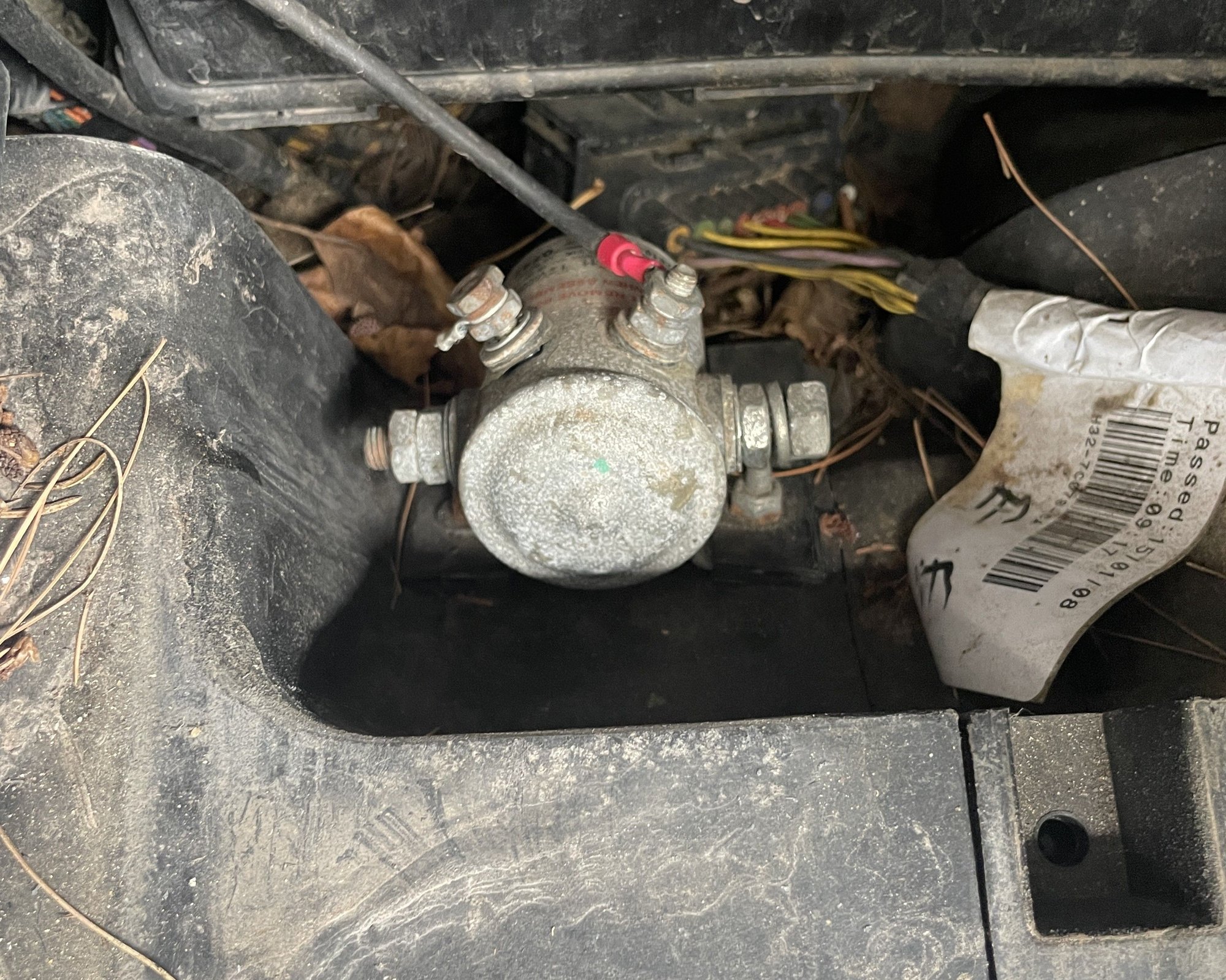

I had the battery out and found underneath the battery in a space that looked intentional what appears to be a starter solenoid or a really heavy duty relay that has one good wire conneccted and another that has broken off at the connector-those are a lighter guage control wire. The load terminals have nothing connected. Any idea about what it's for?
I cannot speak to your specific situation but the Factory Land Rover Winch accessory kit has a relay that tucks in behind the battery much like you described. It id connected to the ignition so it only works when the engine is on. It is possible that the relay was added by the previous owner for some other purpose.
Did this Rover have a factory winch at some point?

Here's a picture if that helps!
As far as I know, there was never a winch on this rover. It does have a couple of options I've not seen on other rovers, the wheel arches are body colored, the mirrors have chrome trim on the upper side, there are rock rails, metal grills protecting the taillights, very small "G4 Challenge" stickers on the doors right below the marker lights, and a locking rear. How much was factory done and how much was a previous owner having a laugh I can't say!
Anyways, since it is there and if it seems to be a factory winch relay, I can make use of it since I plan to install a HF winch. This install does look factory, and definitely wasn't installed by the guy I got it from.

Def clean those leaves out, there is a drain hole at the bottom. If that bay fills up with water so do your computers although it would take a lot. But that looks like a battery isolated for a two battery setup. Might say on the label if you can get a pic.

As for the mystery device under the battery, it is a Trombetta 974-1215-011 which research tells me is a "contacter" or a fancy word for high power relay. It might get used when I hook up my winch. Also cleaned out the crap back behind per Dakota Travelers suggestion, a timely idea, the stuff towards the bottom was damp.

I dont see why you would use that for your winch.
