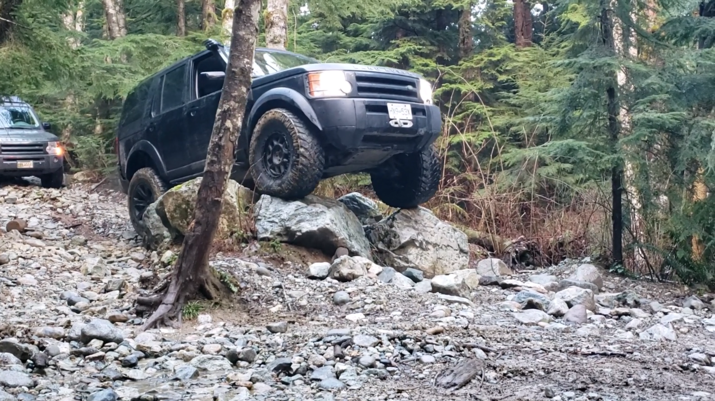

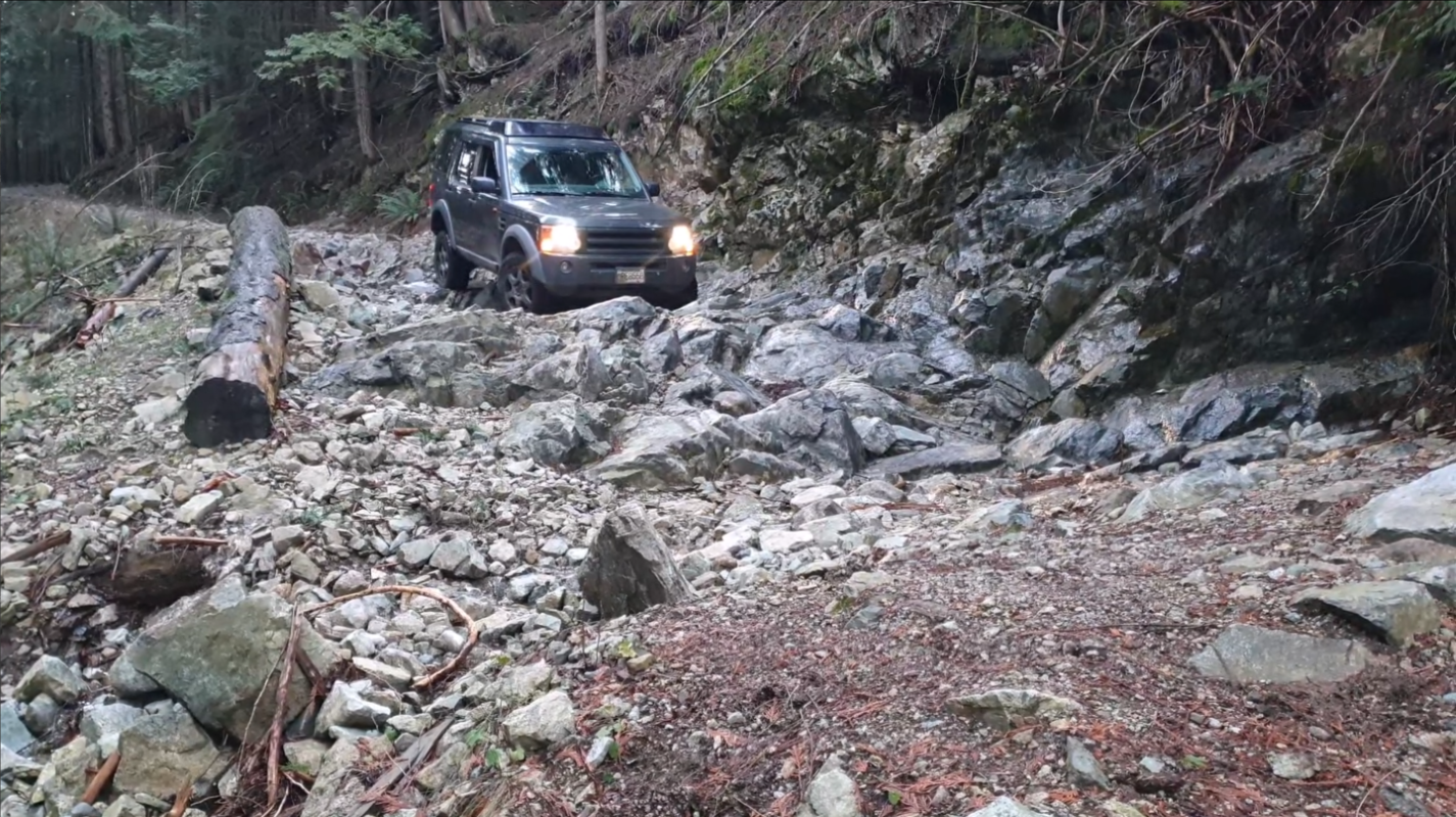

Default Land Rover Discovery 3 rock crawling in Canada
I am looking for answers about the unresponsive terrain response mode, as shown early in this video. The LR3 on 31s goes *almost* everywhere the LR3 on 37s does! And both trucks perform well in all these rocks, but why isn't it moving forward when in low range, rock crawl mode, DSC off, manual 1st gear?

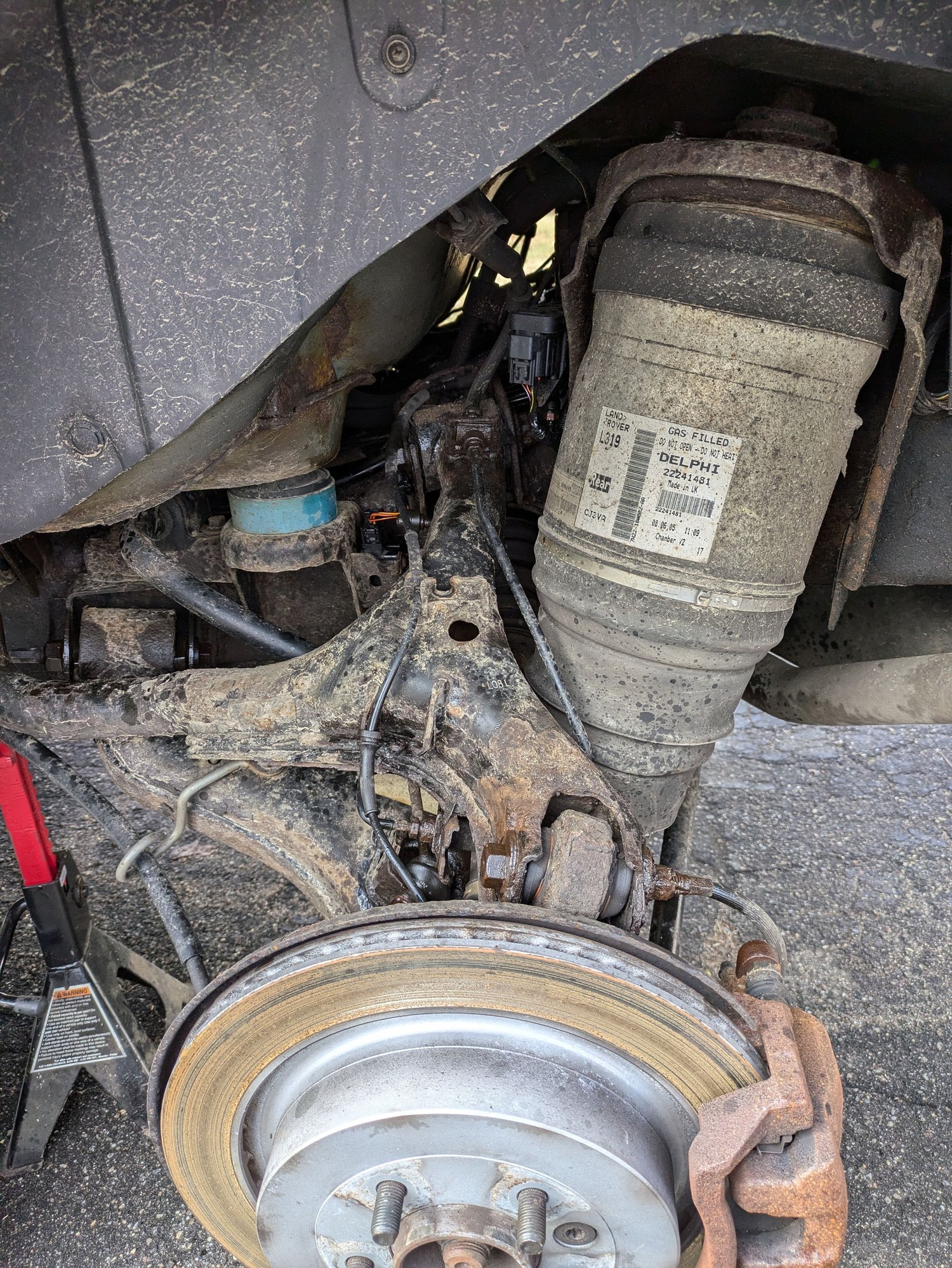

Default Started rear control arms and struts
Got one of four rear control arms installed. 215k miles of New England rust burned through 13 sawzall blades. Two of the three bolts came loose but the last one was not moving.
Any tips for me if the least accessible nut on top of the strut is rusted away? Access seems to be the main problem.

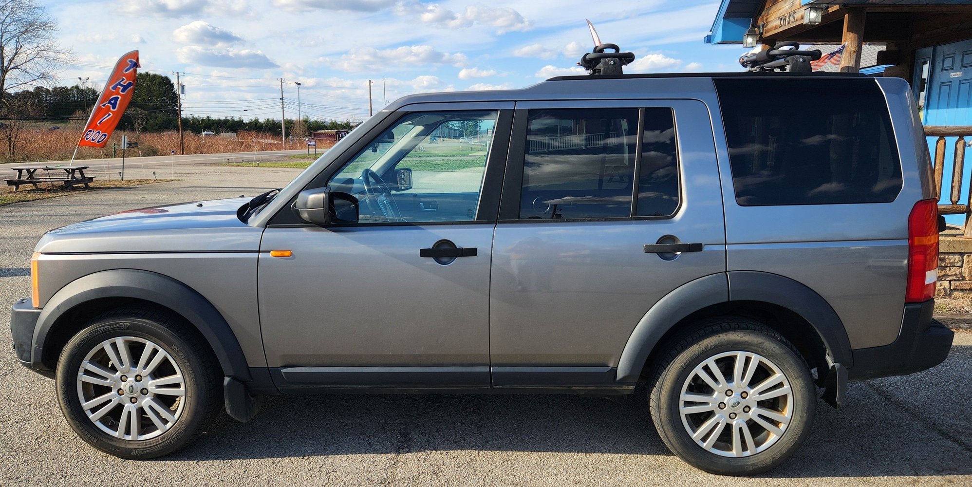

Default Rebuilt Air Suspension system on the 2008 LR3
Replaced AMK Compressor, Air Reservoir, Front, Rear, & Reservoir Valve Block and 2 rear height sensors with harness connectors, reprogrammed and recalibrated
It only has 239,701 miles on it
