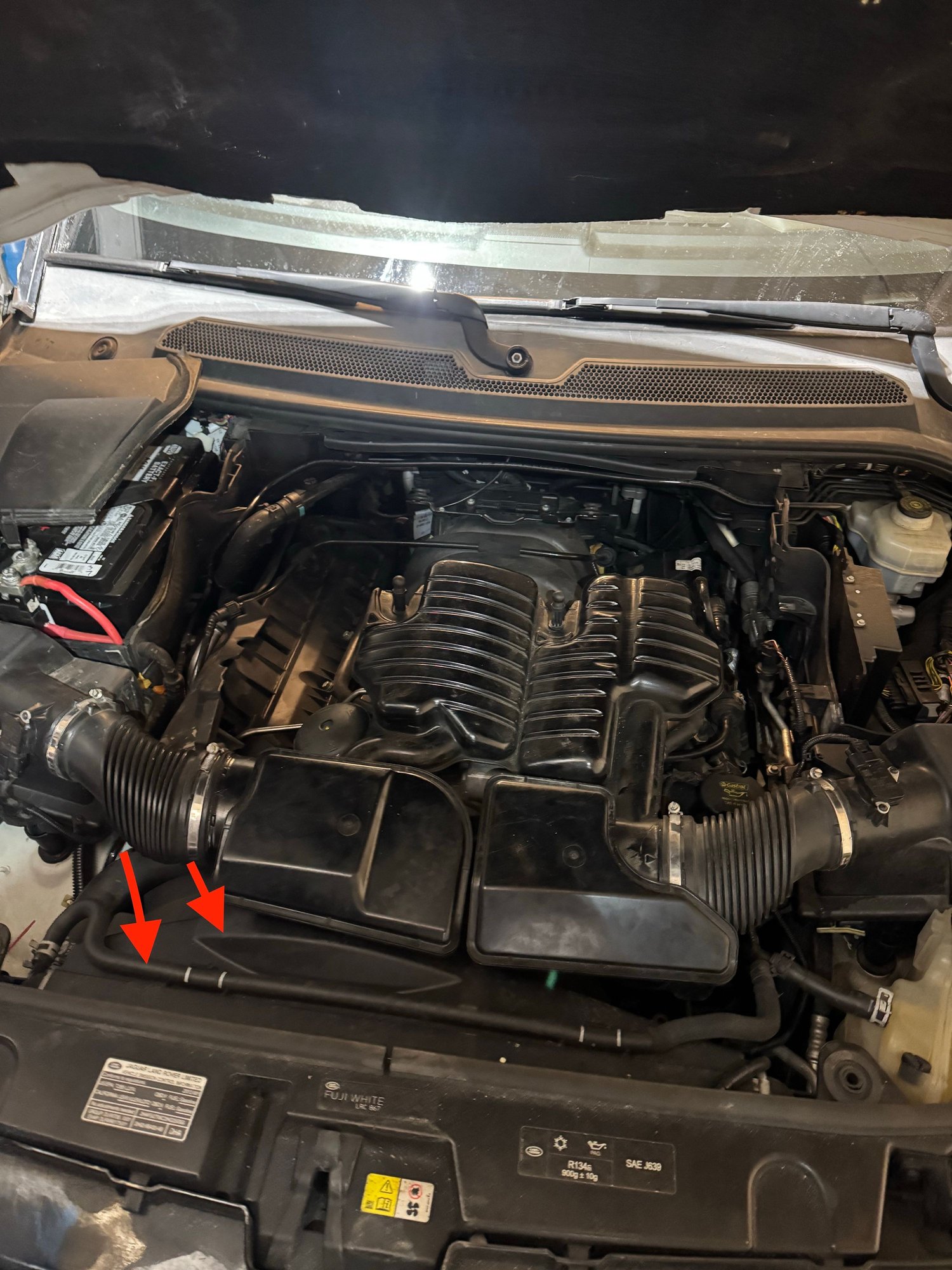

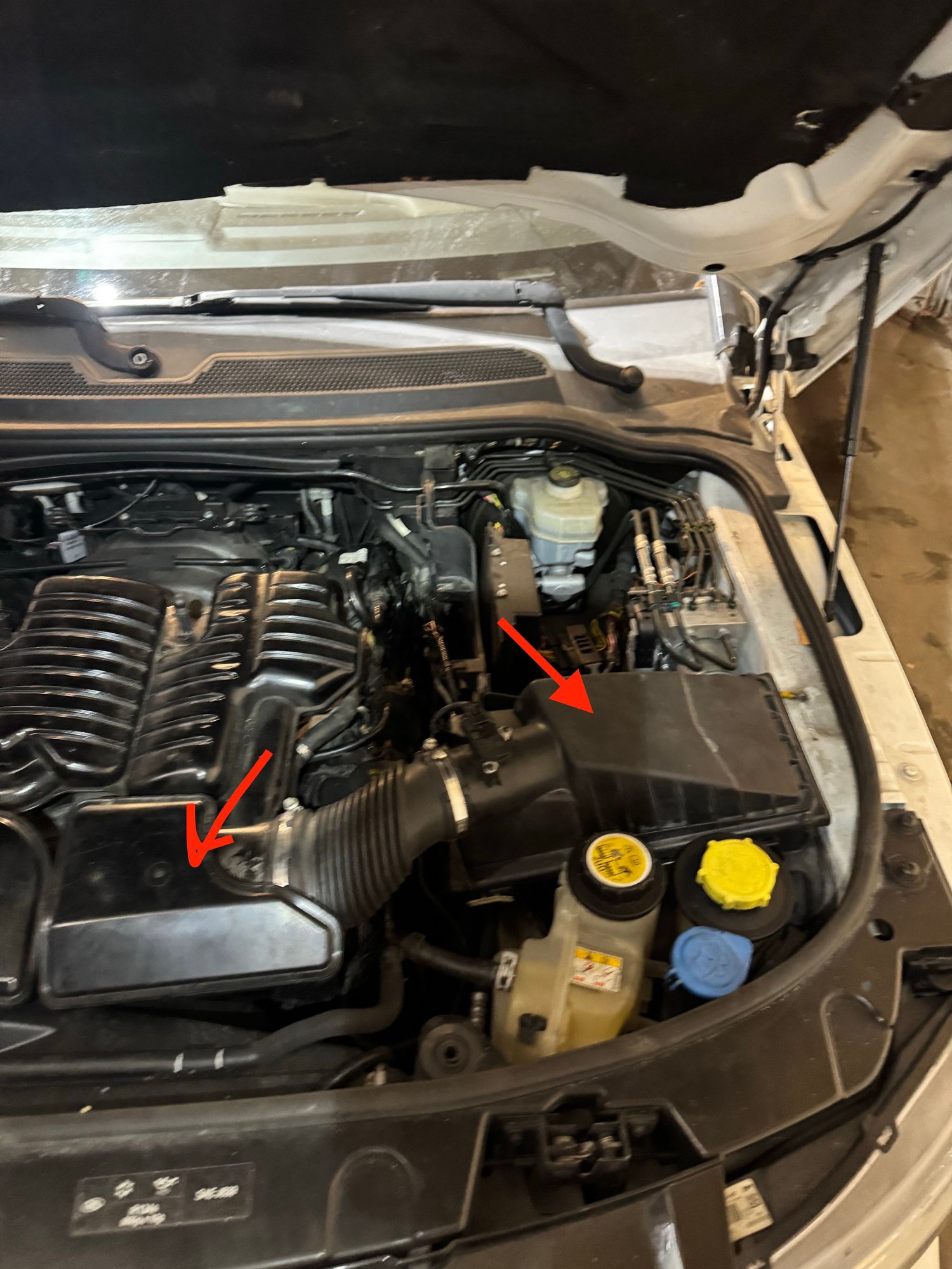

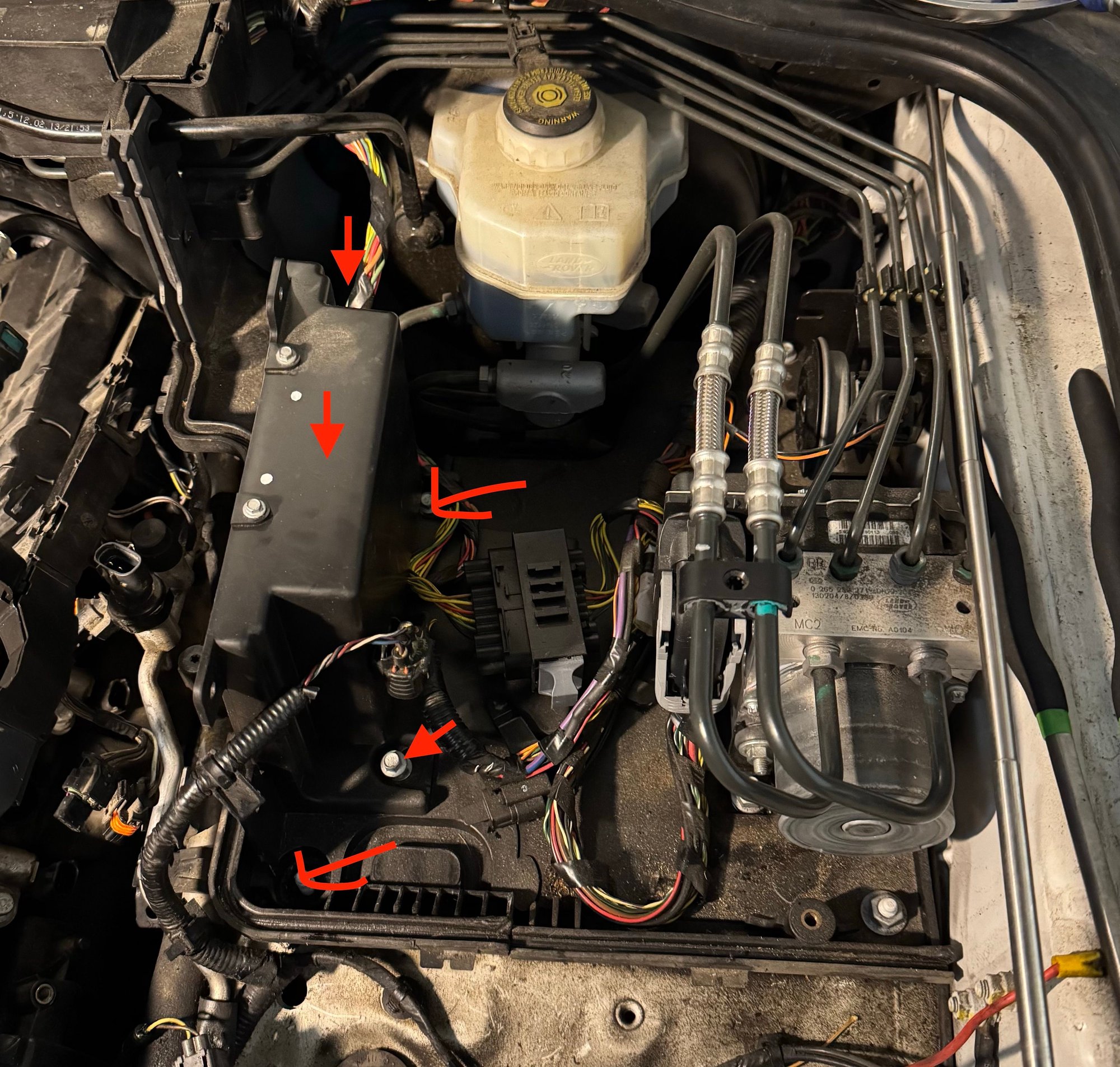

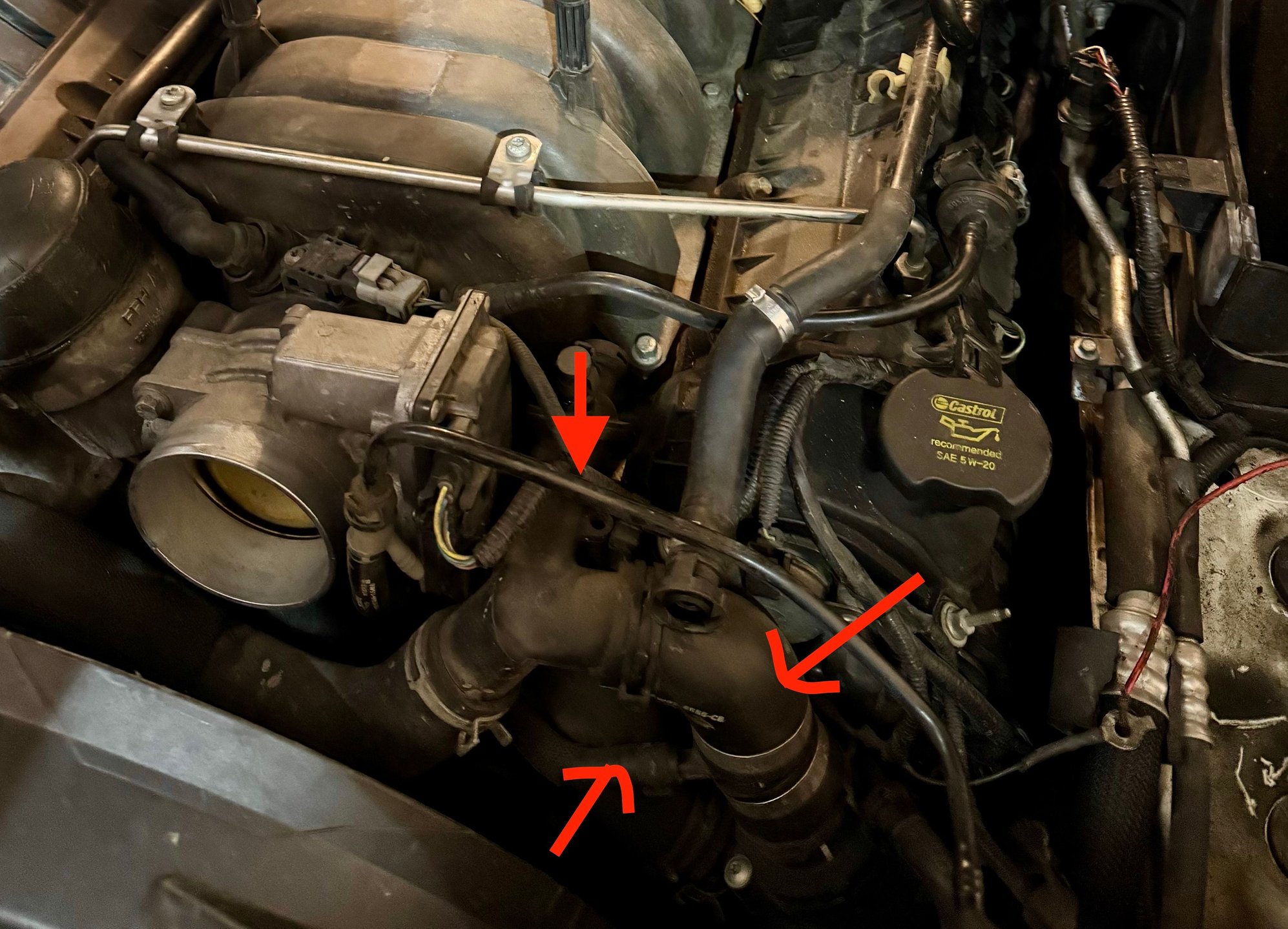

I thought I would follow-up on this in case others run into a similar problem. It turns out it was a bad O-Ring on injector on Injector #6 (second to back on LH side). It wasn't too bad to get to, it took me 3-4 hours mainly because I was figuring it out as I went. If I had to do it again it would probably take a couple of hours. Here are the things you need to remove. Unfortunately, I wasn't thinking about documenting it so don't have great pictures, but I did take some for my own reference as I went which I will attach:
1. Engine cover
2. Intake Pipes and LH airbox
3. Coolant line that goes from reservoir to radiator and then Upper Fan Shroud
4. One little section of coolant pipe right above the thermostat housing. Also the little hose that goes from that larger rubber hose to the throttle body. I just removed it from the hose side and left it inserted to the throttle body. There is also a hard plastic coolant pipe that connects to a rubber hose right next to the throttle body.
5. Now you should be able to start. undoing all of the connections for the wires that come out of the wiring loom that sits on top of the the fuel rail. They were all fairly easy except for the very bottom one that goes into the temperature sensor. You have to work you hand down next to the fan and contort it in a weird angle. If you have the ability to take the fan off that would make it much easier.
6. Ok next take of the plastic box next to the LH bank of the engine. It comes off in several pieces. First the top just comes off after releasing a few clips. Then the side of the box comes off with a few more clips. Next the very back side piece that goes into the fire wall. Then you can take off the bottom. It splits in two. You need to take off 2 bolts for the electronic box and then there is a nut that goes on a stud underneath. There are two other nuts on studs that you have to remove, one on the front and one on the back, then half the bottom of the box comes off which is what you need.
