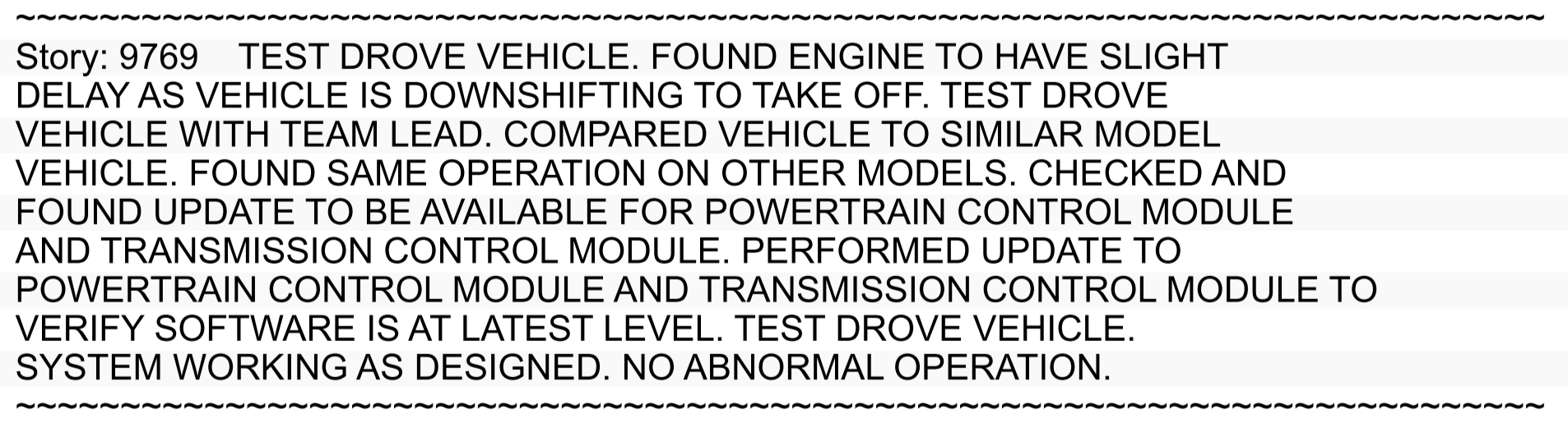

After a full week at the dealership for various smaller issues (all covered under warranty), I'll be able to take the Disco for a test drive tonight. Curious to see if their transmission and powertrain update fixed the laggy acceleration:
So by that note, I cannot tell if the update cured it or they are saying it was fine to begin with. I'll be interested to hear if it helped. I think it is dangerous as is.

I will absolutely keep you posted! Yesterday, I haven't had the chance to trigger the delay in down-shift, but while stopping (slowing to a halt), I felt a more pronounced down-shift from 2nd to 1st (presumably at higher rpm). However, another forum member said the problem was gone after bringing it to the shop for software update. (search for LR4Top in this thread (click me). If the problem is gone, I will tell my service advisor that this update should become a standard procedure due to safety risks.....
