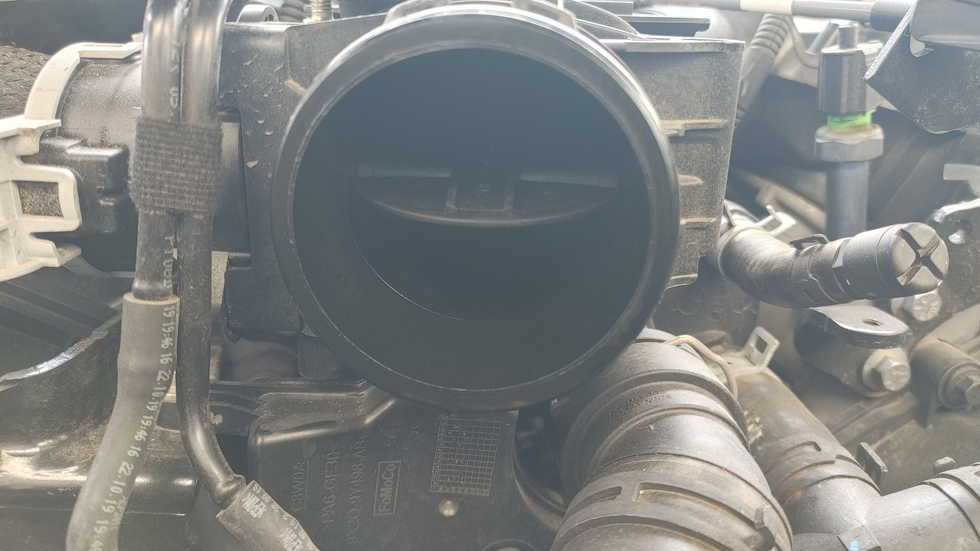

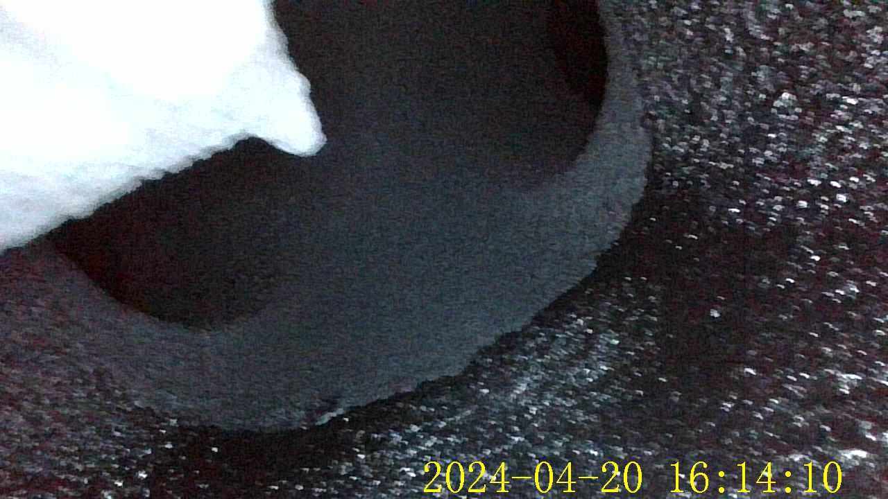

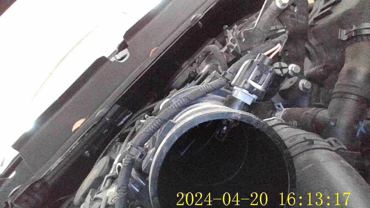

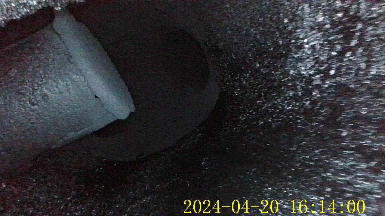

I tried opening the throttle body but couldn't get the locking clip off. Removed the air intake hose instead and used a borescope to check the carb build up.
Interestingly, to the naked eye it doesn't seem so bad @35k miles. Borescope camera makes it look a lot worse (I'll post pictures shortly).
I hope to take another swing at it over the weekend.
Did you attempt to clean any from only removing the intake hose? Did it appear to stick at all, when you open and close manually?
Thanks for the pictures!
whatever carbon I was able to remove didn't seem sticky. valve operated normally as well.

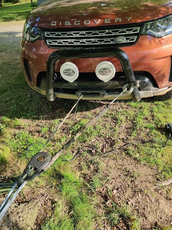

Fixed my bent in bull bar. I bent it in, up against plastic on the trail in Uwharrie.

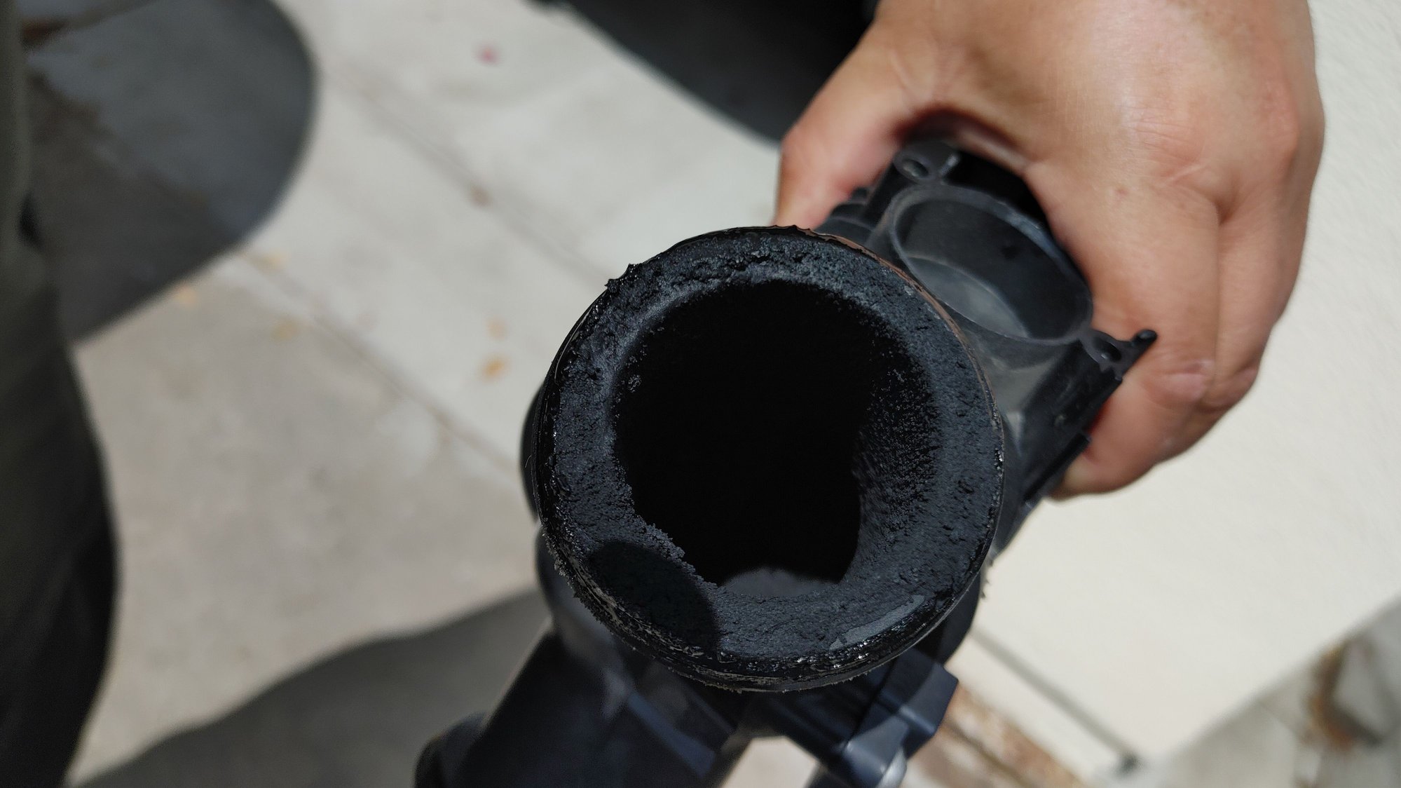

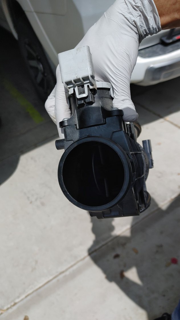

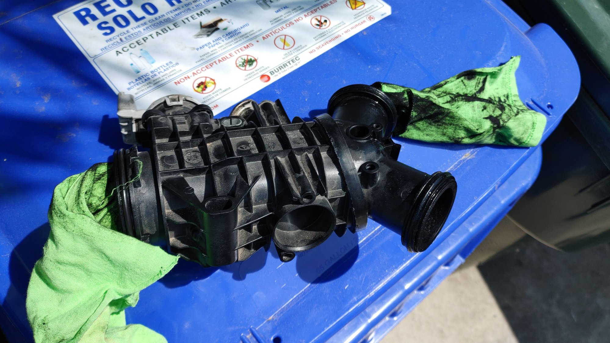

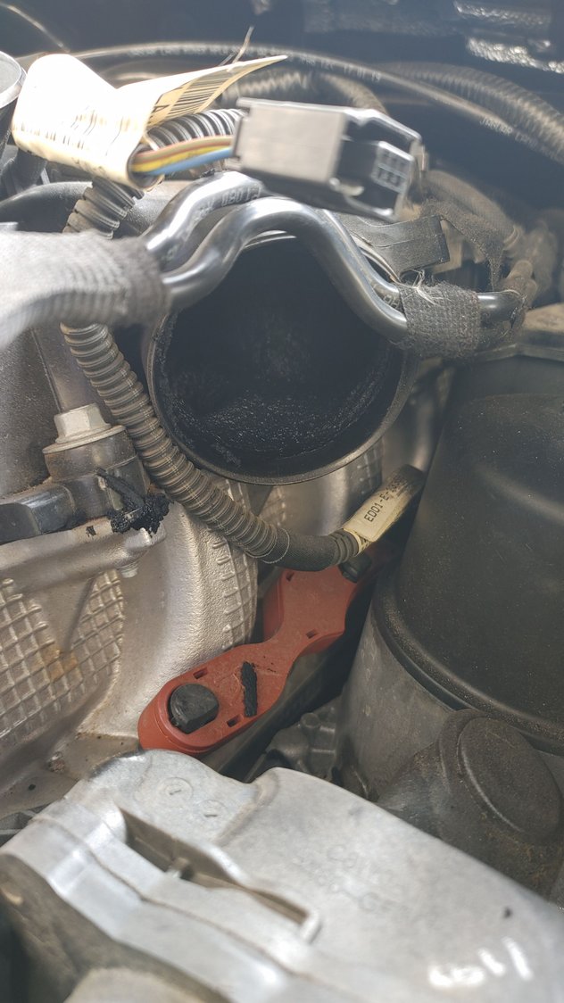

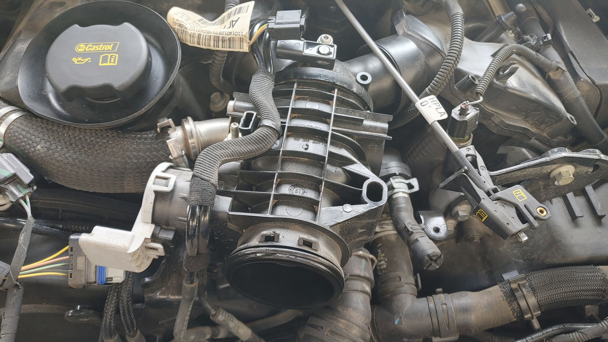

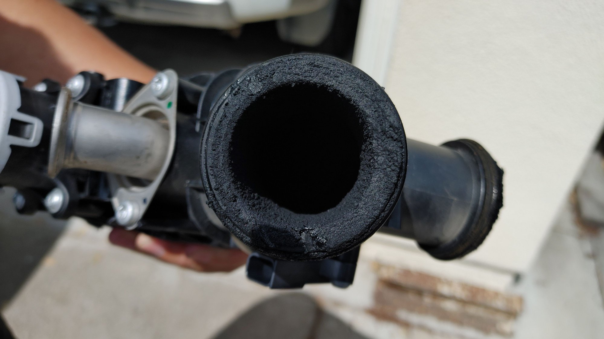

Attempt # 2:
Old May 19, 2024 | 06:41 PM
  #259
adam5's Avatar
Joined: Nov 2021
Posts: 215
Likes: 131
From: Southern CA
The throttle body cleaning wasn't too difficult. It had a decent amount of build-up at 35K miles.
  • I soaked the internals with carb cleaner in the first round
  • followed up with brake cleaner
  • used old toothbrushes and rags to scrub out the tenacious soot
  • gave an hour in the sun to dry out the throttle body before re-install.
Please remember to remove the MAP sensor before you start spraying, I nearly forgot that it can be damaged by the brake cleaner.
My main worry was needing to re-adapt the throttle body after the reinstall, but thankfully the motor didn't skip a beat.
Things were messy so I didn't get a chance to take pictures after the cleanup, but the results were satisfactory. I can see myself cleaning this every 20-30K.
Interestingly, the back of the butterfly valve had quite a bit of build-up, something I can easily see causing the valve to clog.
Fortunately, it was very easy to cleanup with a toothbrush.
Perhaps, I will try the Heisenberg hack from Christian in the future, but it's not super necessary imo.
Great job!
