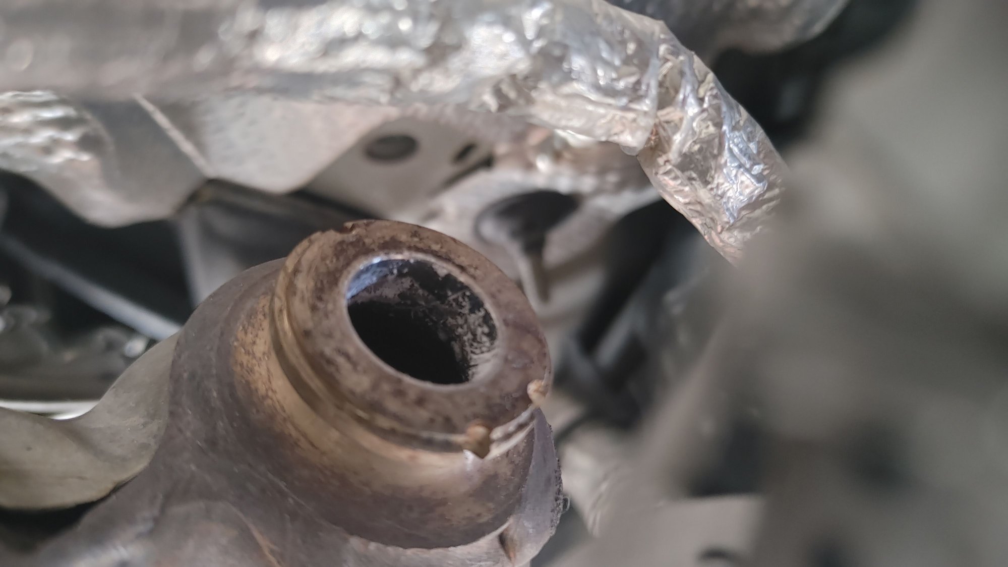

I did also manage to change my oil today. Going to the woods tomorrow. Can't turn that down!
I know its 5w-30
no oil leak, just dried mud LOL.
dry
dry
no metal 97K
every oil change MAP
good to go

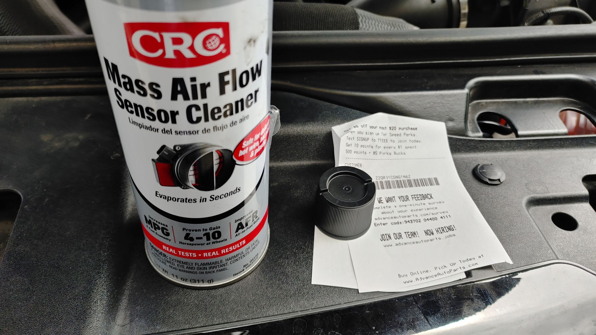

Could you post a photo showing where the gunked up MAP is. Did you clean it or replace it?

I clean it every oil change.
Also clean DEF injector. ( I ran out of time to clean DEF injector)

I prefer not to use the MAF cleaner.
I just wipe the outside. Then carefully loosen soot with a pick, Don't go to deep, then use a Qtip/cotton swab circles not in and out.
No compressed air! ($85 dollar mistake) https://www.rockauto.com/en/moreinfo...=11207&jsn=395
you can gentle tap it to get final soot out.
Good luck!

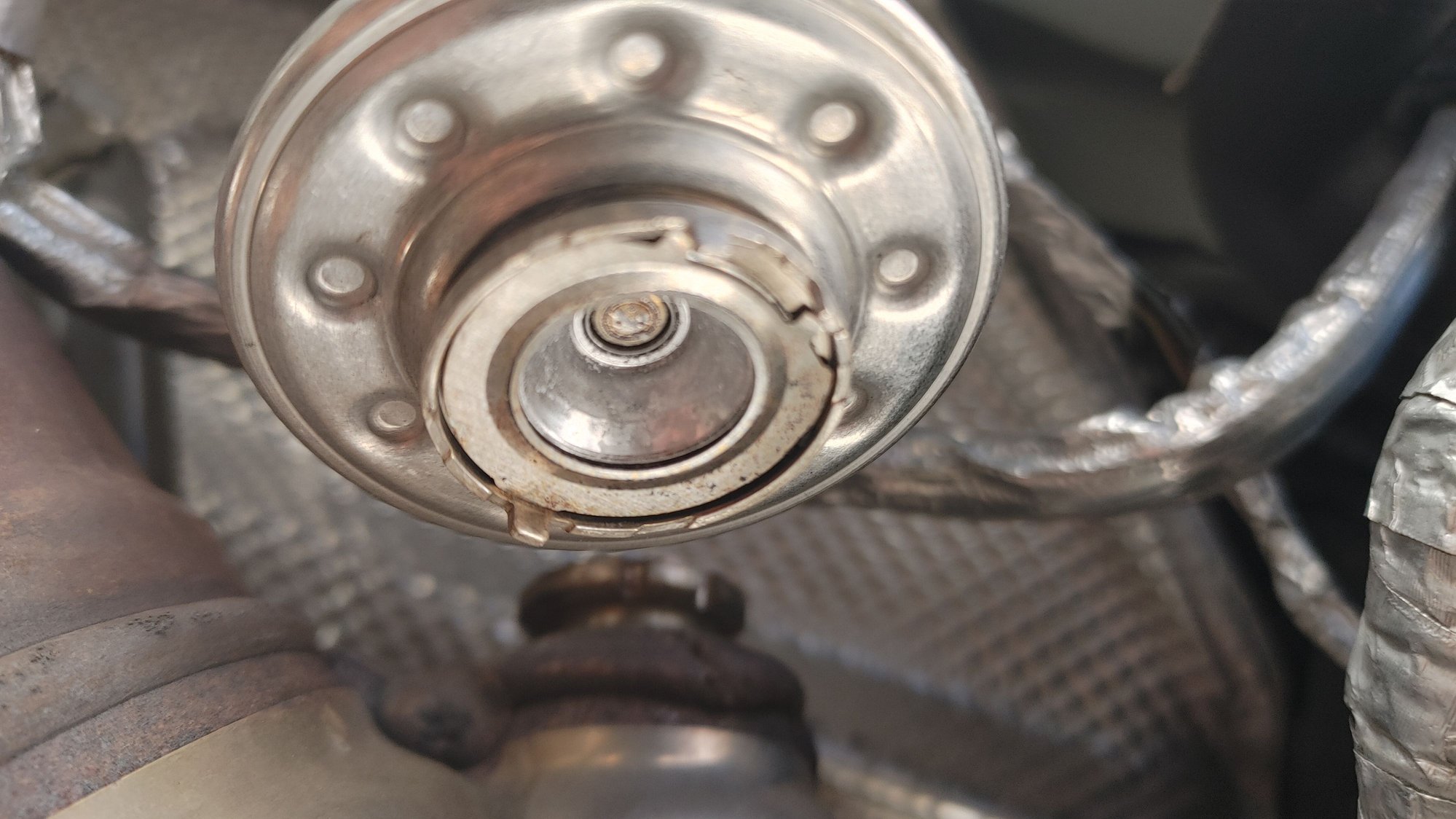

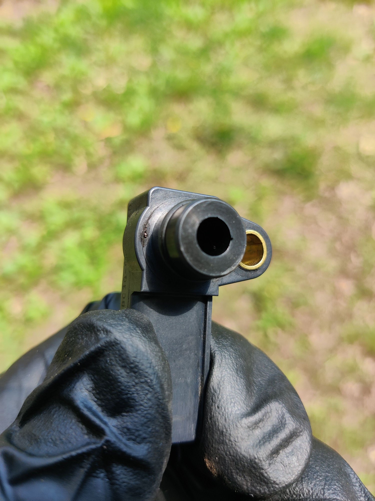

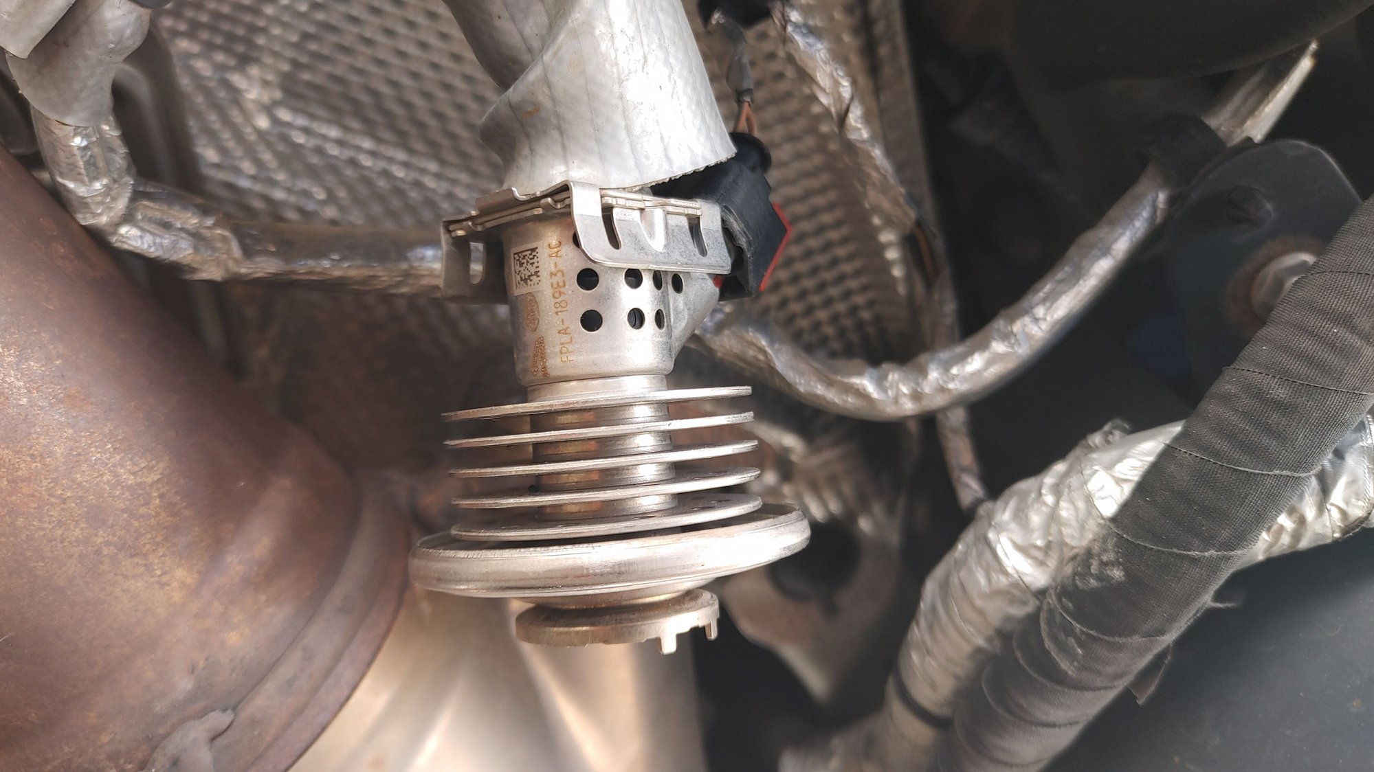

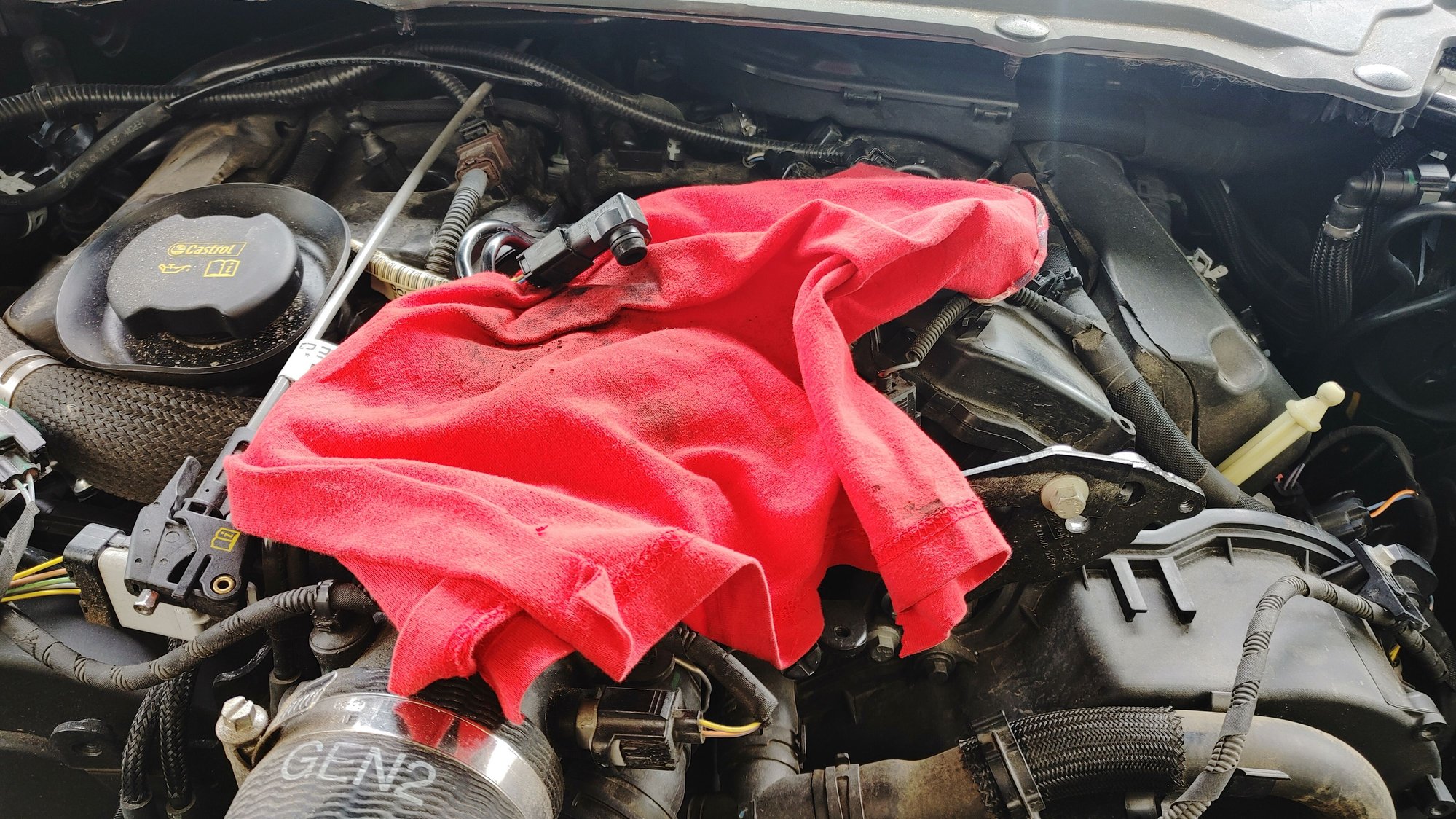

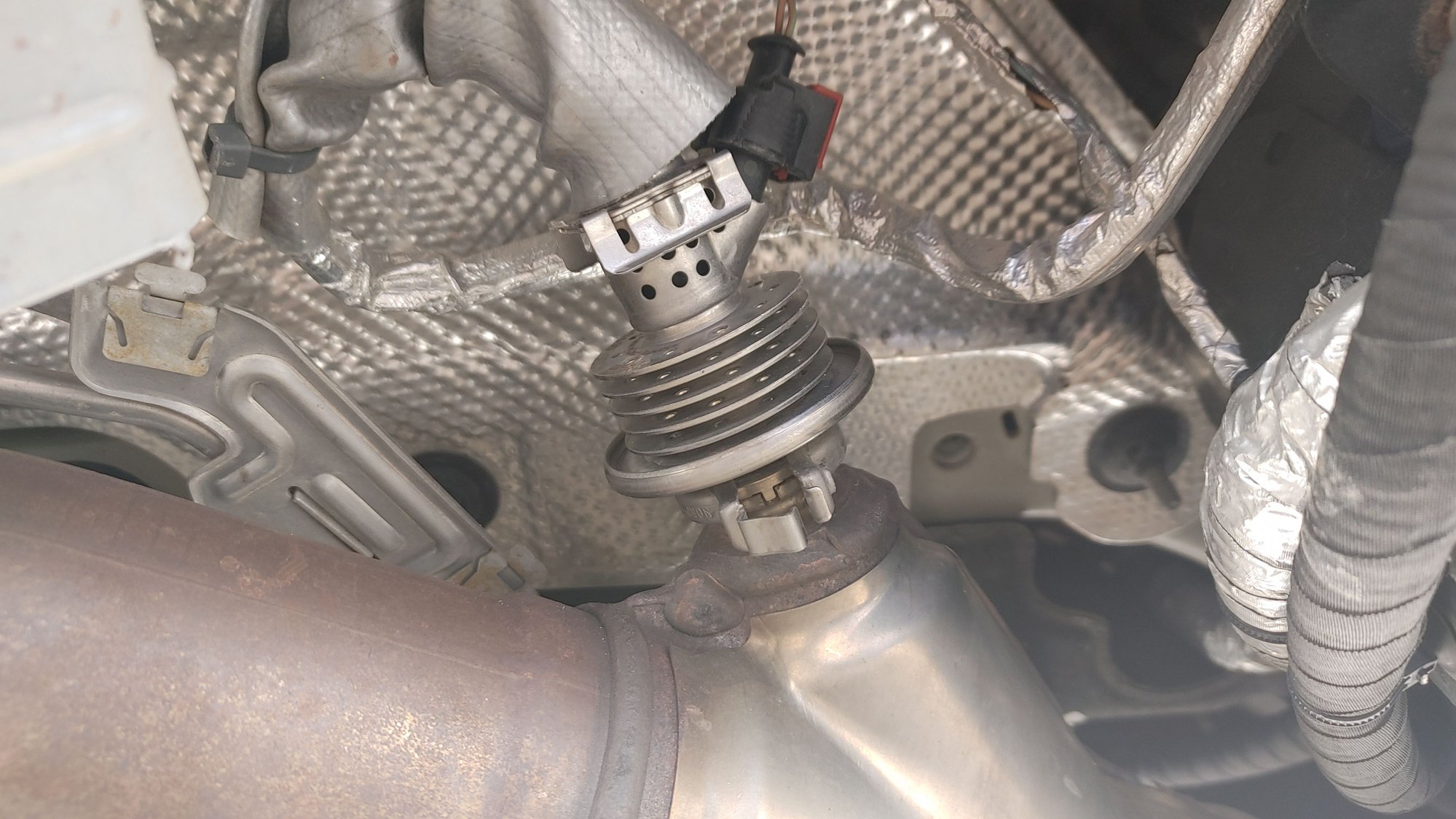

Thanks to @gmfain for sharing his knowledge with us. I was able to clean the DEF injector & MAP sensor. Both turned out to be super easy maintenance items
T25 Torx to remove the bolt
Minor build-up at 39K; it all fell out with a touch of hand
few finger taps is all it took to drop all the build-up on the ground
Initially had a challenge to remove the sensor
Then realized there is a tab to push in; voila!
