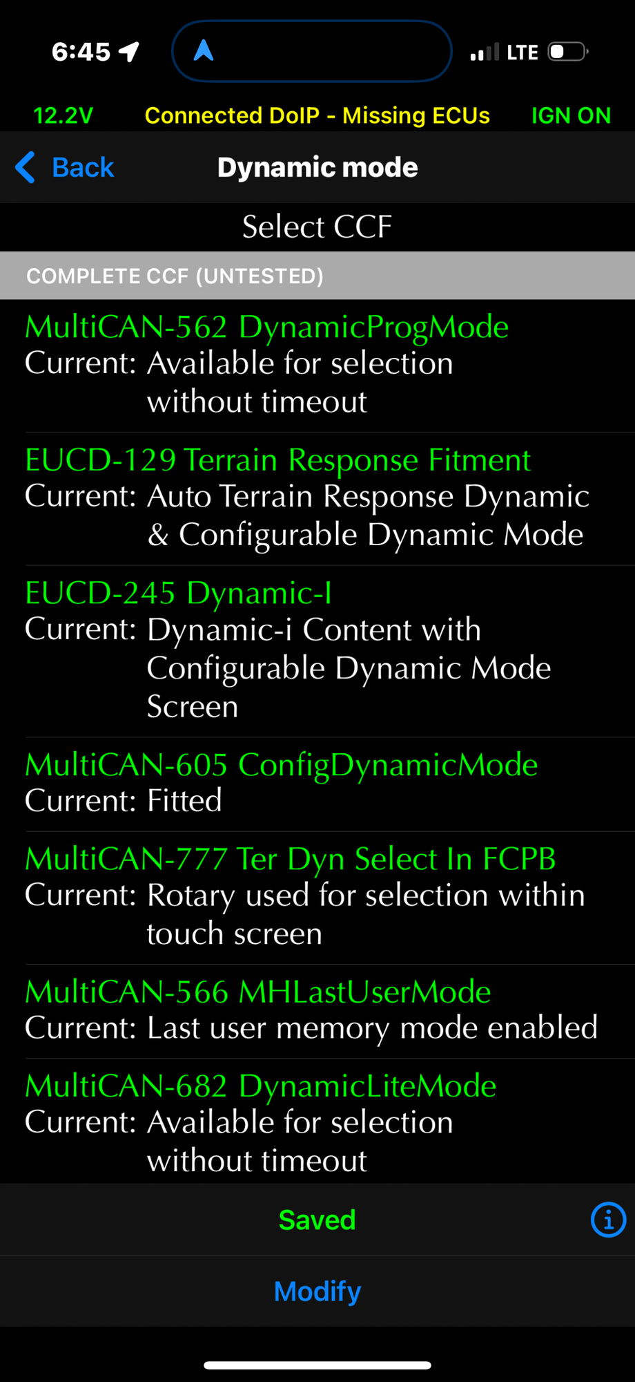

I would check all of your CCF for dynamic mode, specifically:
MultiCAN-777 Ter Dyn Select In FCPB
Standard: Control interface not available in FCPB
Changed to: Rotary used for selection within touch screen

Thanks, but it appears that is exactly where I have MCAN-777 set….

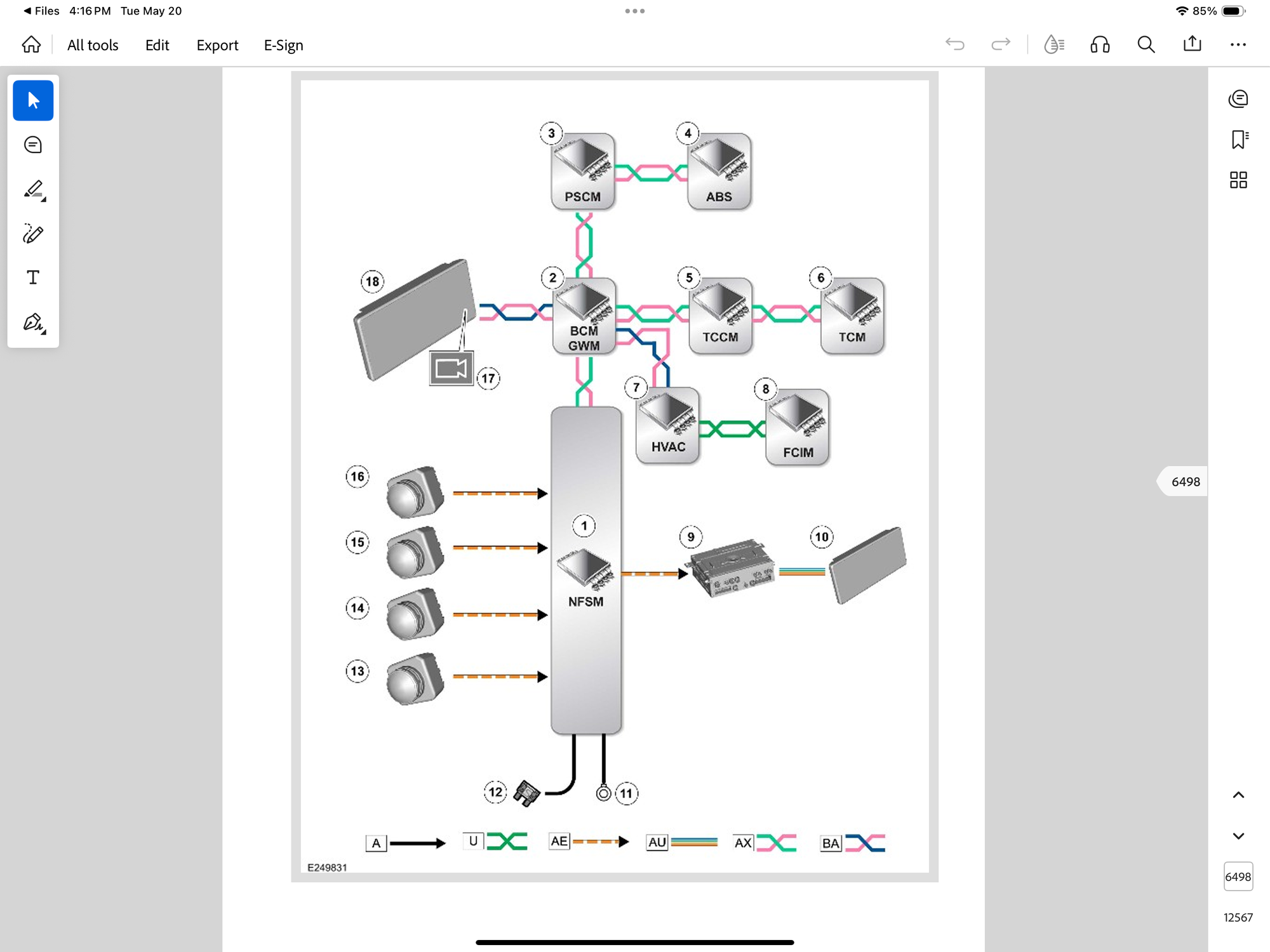

One of several I’ve been studying…still no luck.
