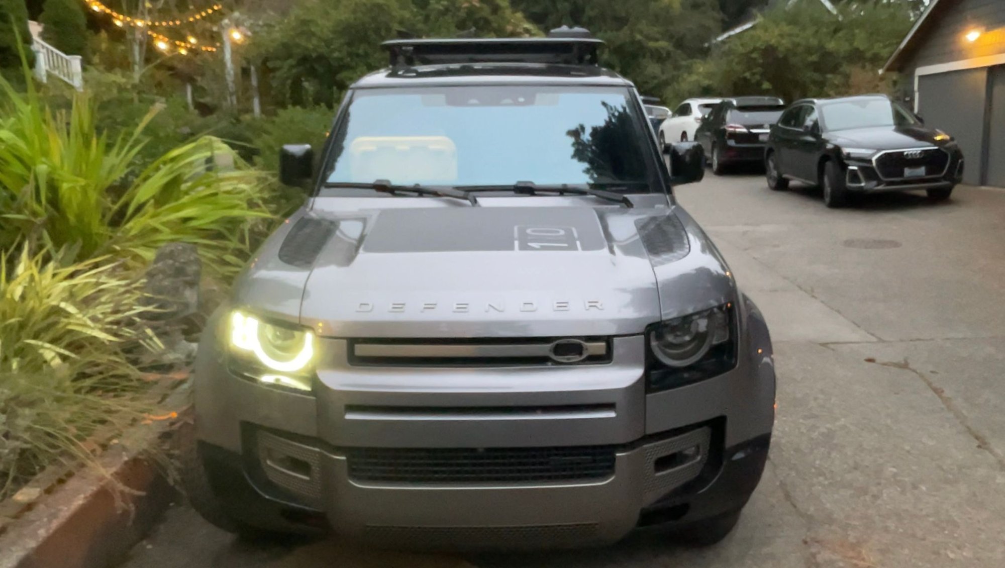

Glad I found this thread. The right-side DRL ring on my 2022 Defender went out (it’s 5k miles out of warranty ). The square “marker” lights work for a few seconds, and then cut out. I recorded a video: https://share.icloud.com/photos/0207...UqK13AFCIYhy_w
Has anyone tried replacing the module inside the headlamp? https://www.antparts.com/products/la...ht-drl-module/

IID tool doesn’t work with the new Defender, right?
Old Oct 21, 2023 | 11:19 AM
  #100
nashvegas's Avatar
Joined: Oct 2007
Posts: 2,767
Likes: 1,979
From: Pacific NW
IID tool absolutely works with the new defender. You can code the DRL's off if you'd like.
