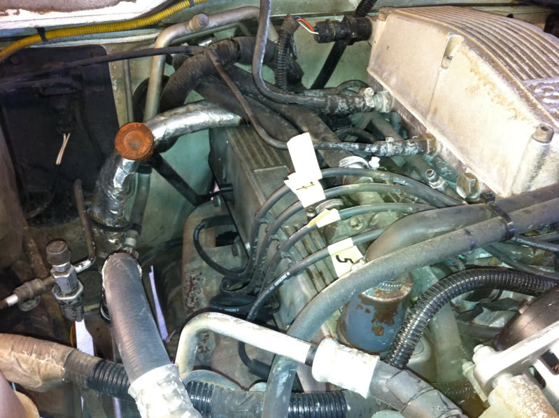

Midday progress:
Labeled the plug wires to make reinstallation easier
Cap rotor and wires removed:

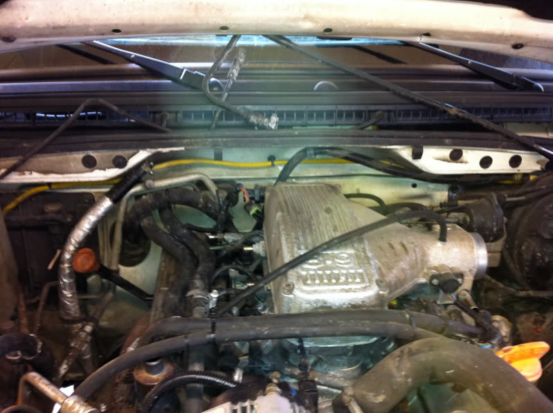

Drained the oil, while that was dripping I removed as much as possible from the intake:

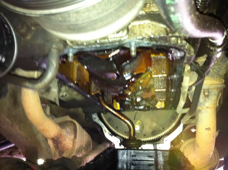

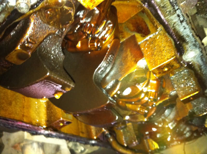

Removed oil pan:
Lower end is about how I expected for 190k miles. No metal particulates seen.

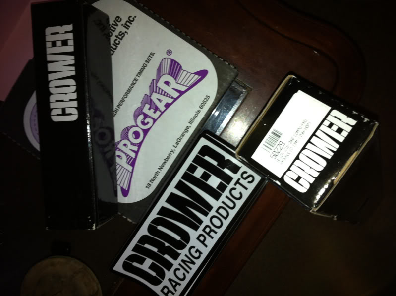

Posted that in the other thread. But here you go!

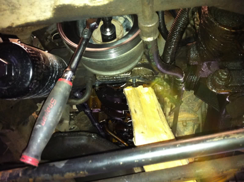

Used wood to lock up the crank and remove the crank pulley bolt, worked like a charm!

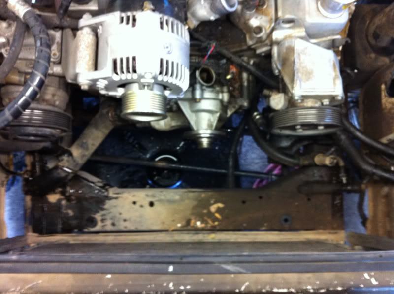

Pulley off:

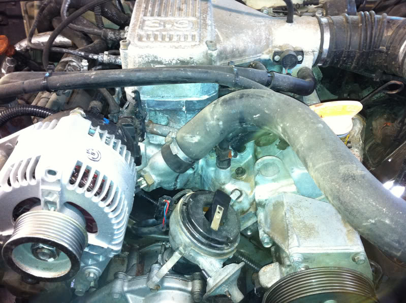

Moved on to the distributor and radiator.

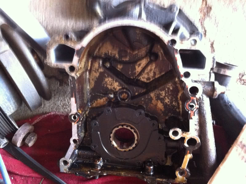

Removed cover with oil pump:

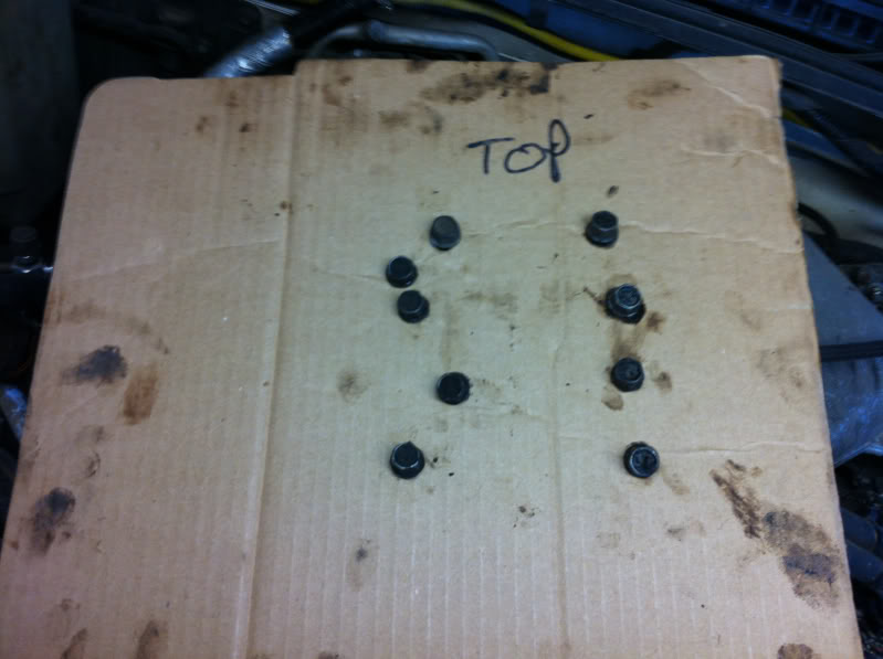

Made a bolt diagram to make sure I put the 3longer bolt back in the right spot I highly recommend this:Name:  1875781e.jpg

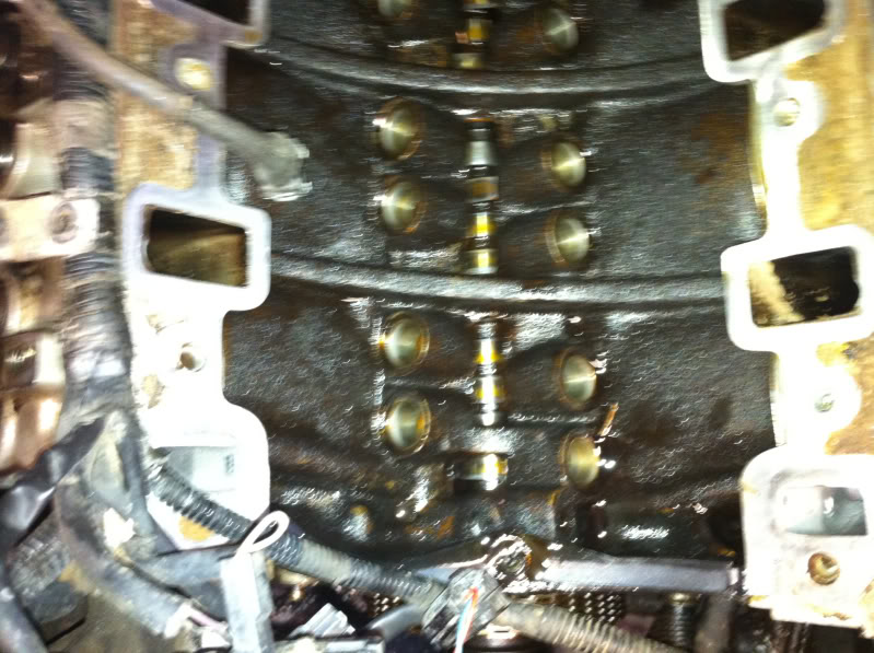

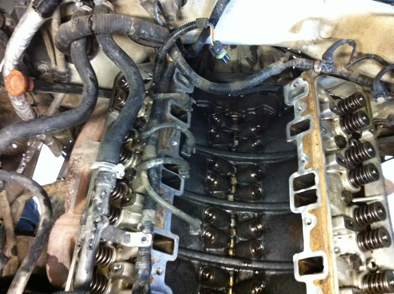

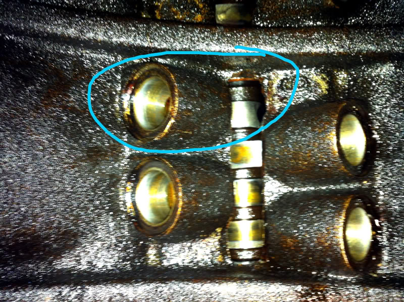

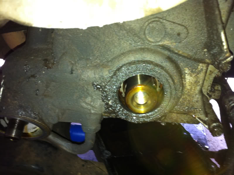

Follow these next 3 images as they zoom in on the second cylinder on the left bank.

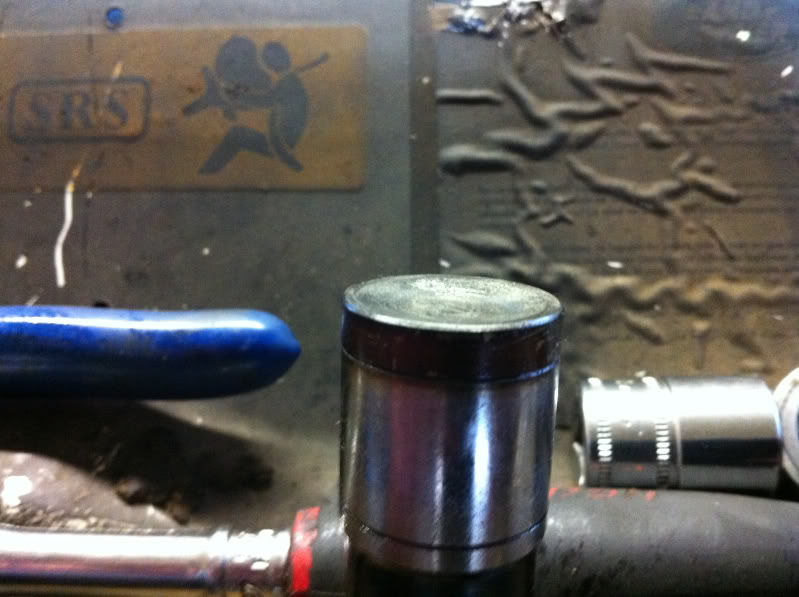

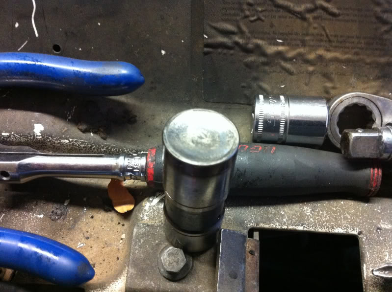

Blue circle is where this lifter lived:
Hello mr. Ticky Ticky!
