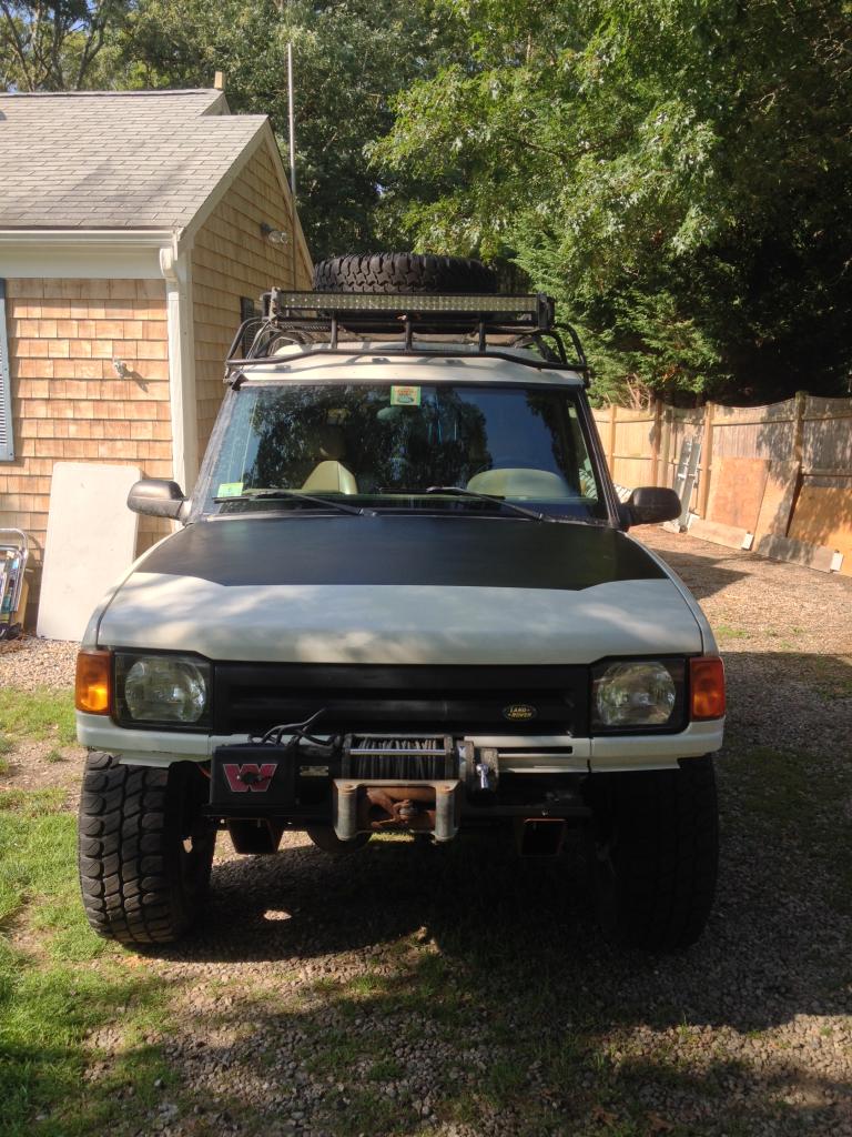

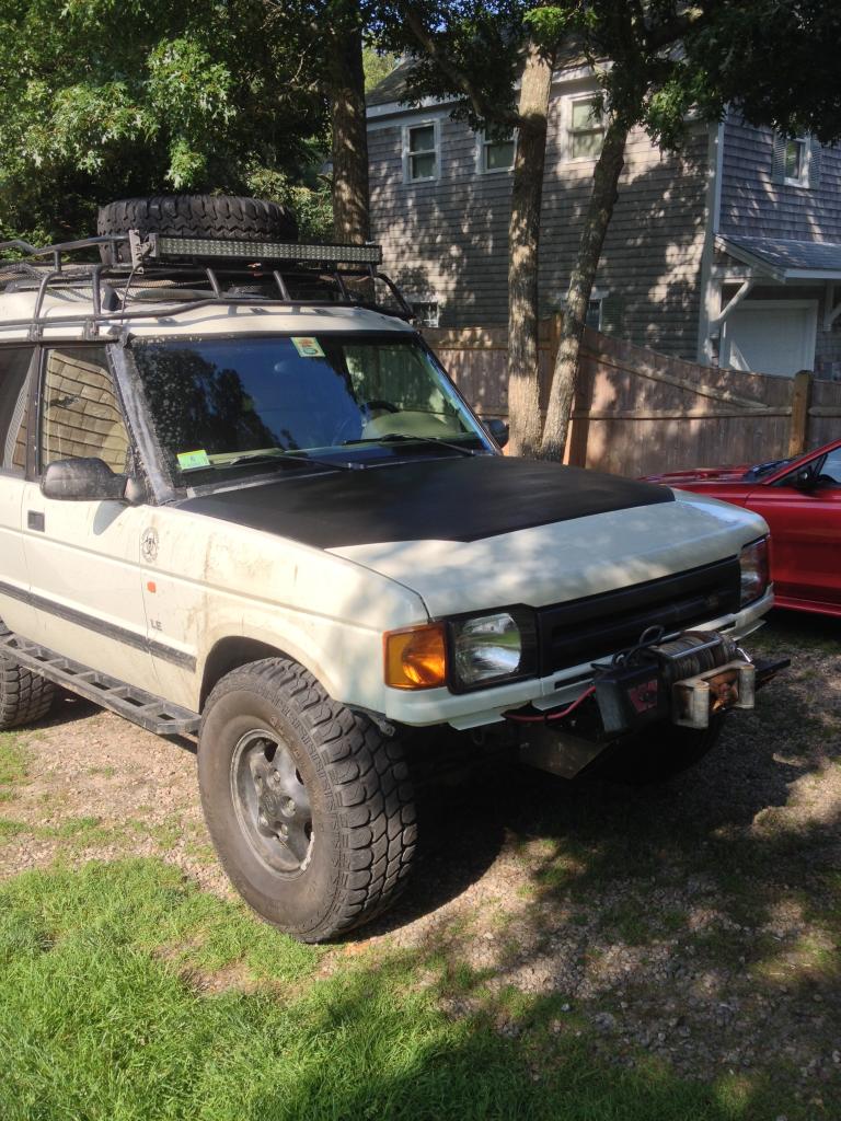

I was starting to notice that the 3m hood blackout sticker was starting to get really crappy so i decided to remove it and replaced it with some bedliner that i had left over from doing the floors. It came out a lot better than i thought it might, I'm very very happy with it. I didn't want to follow the original lines cause for one it still left some paint exposed that had some deep scratches in it, and for two it proved harder than i thought it'd be to tape off. i also removed the faded LAND ROVER sticker, i plan to get a newer version of it with the raised ABS letters
