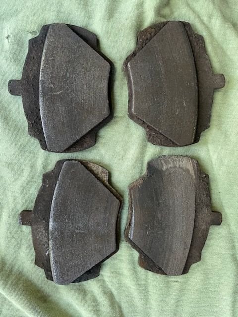

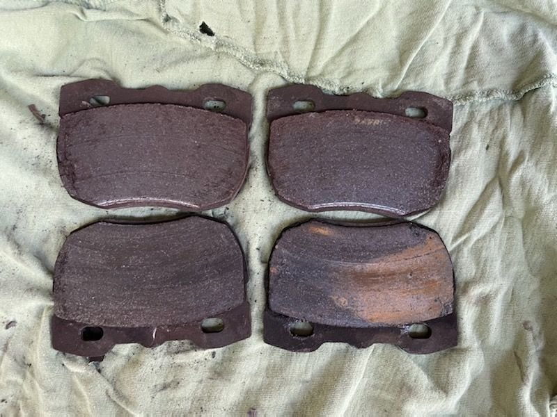

Today, I finished flushing the DEXCOOL out and put the GREEN 50/50 mix in.
Yesterday, I changed the radiator hoses and T-Stat out. I flushed the system out once.
Today, I flushed the system out six heat cycles and felt this was good enough.
Next, I changed the front and rear brake pads. they were all at “end of life” for sure and U G L Y ! ! !
One rear pad was down to metal. The rear pads are LOCKHEED which leads me to think they are the originals as the calipers are LOCKHEED
or Dealer replacements. No matter, all the life was used up.
Tomorrow, I may flush the brake fluid, again, this time with CASTROL brake fluid.
CHEERS!
