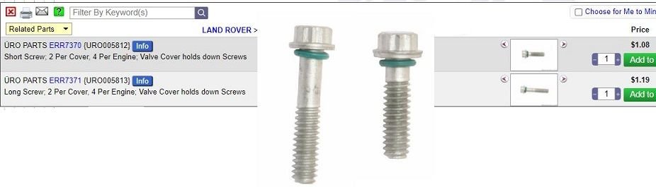

Originally Posted by wes_in_va
Not really o rings but on my bolts there was definitely some material that had degraded and when I look at new bolts from Atlantic British it looks like there’s kind of a seal/o ring thing there?
Agreed. It's not an O-ring per se, but there is some sort of rubbery material there under the head. See pic.
I suppose trying O-rings that fit would be worth a shot.
https://www.roverparts.com/engine/he...dware/ERR7371/

Oh wow. Wild. I’ve never seen a new valve cover bolt. Hmm. I wonder if something like Hylomar should be used in its place.

Could you fit a dowty washer, that a steel washer with a rubber seal on the inside used on hyrualic systems

Just a wipe of silicon under the bolt head would work just as well. Or truthfully I've never used anything under the bolts, never had a leak from that specific location.

I wonder if they had a lil rubber on the bottom of those bolts from the factory, to help keep them from loosening up all the time. Doesn't seem like there's a need for a seal there as the valve cover gaskets takes care of that issue, but those lil bolts do vibrate out easily enough. I used a dab of blue Loctite on mine instead, I also mark the bolts with viz-torque so I can tell if they loosen up at all. So far so good, but I doubt that with a fairly coarse threaded bolt, that anything will completely stop them from loosening over time. Unless someone made a locking bolt, like they have for exhaust headers, I think these will always try to loosen up as they are to small and coarse threaded to stay put long term
