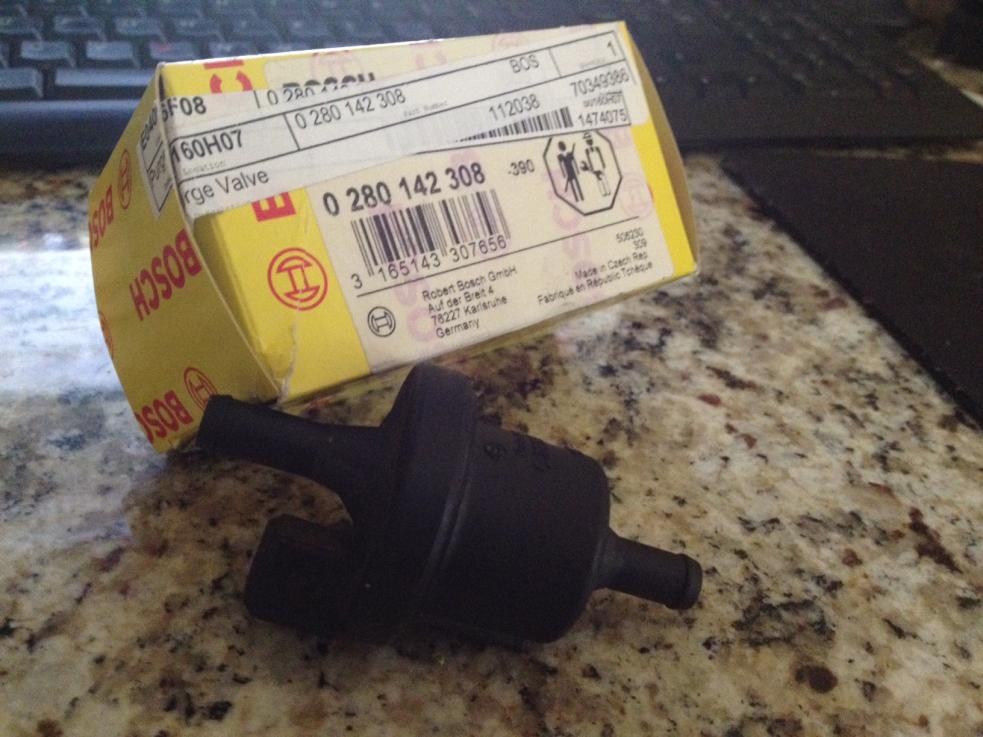

Replaced my Fuel Purge Valve this afternoon with a genuine Bosch (made in Czech Rep) one. Have read of people replacing it with the cheaper Hyundai one, but figured I'd stick with what they put in the vehicle (Bosch)... especially seeing it was only $72 (bought from BP Utah off eBay). No more P0440. Hardest part was removing the factory clamps.
