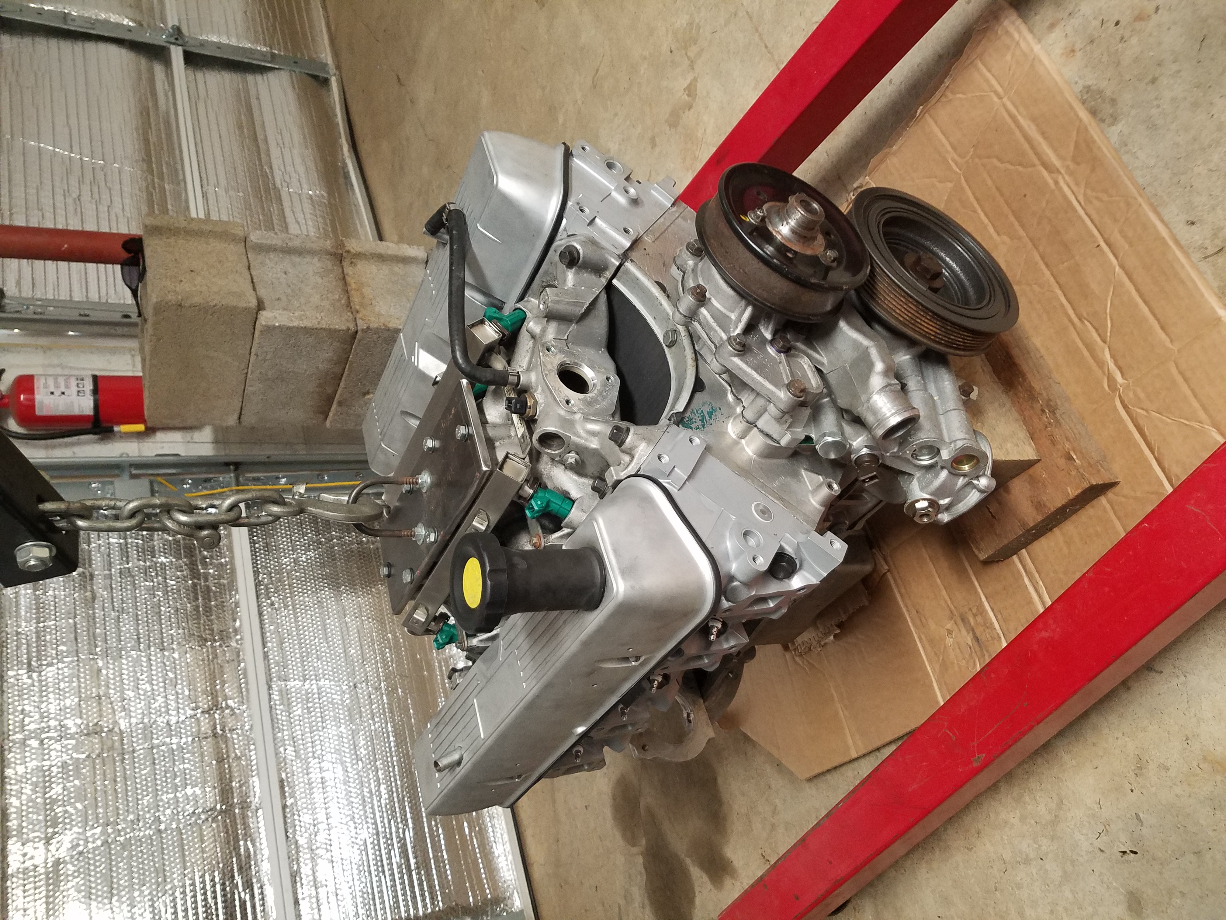

Getting ready to put engine back in

Engine looks great sixpack.

Originally Posted by CollieRover
That drove me nuts. The Fel-Pro's actually lined up.
Thank you sir...I just hope it runs that way too, lol.

That motor looks amazing six pack. I’m excited for you.
Thank you sir!
Now, only about 80 more small jobs to do, put the engine in...and hope it runs.
