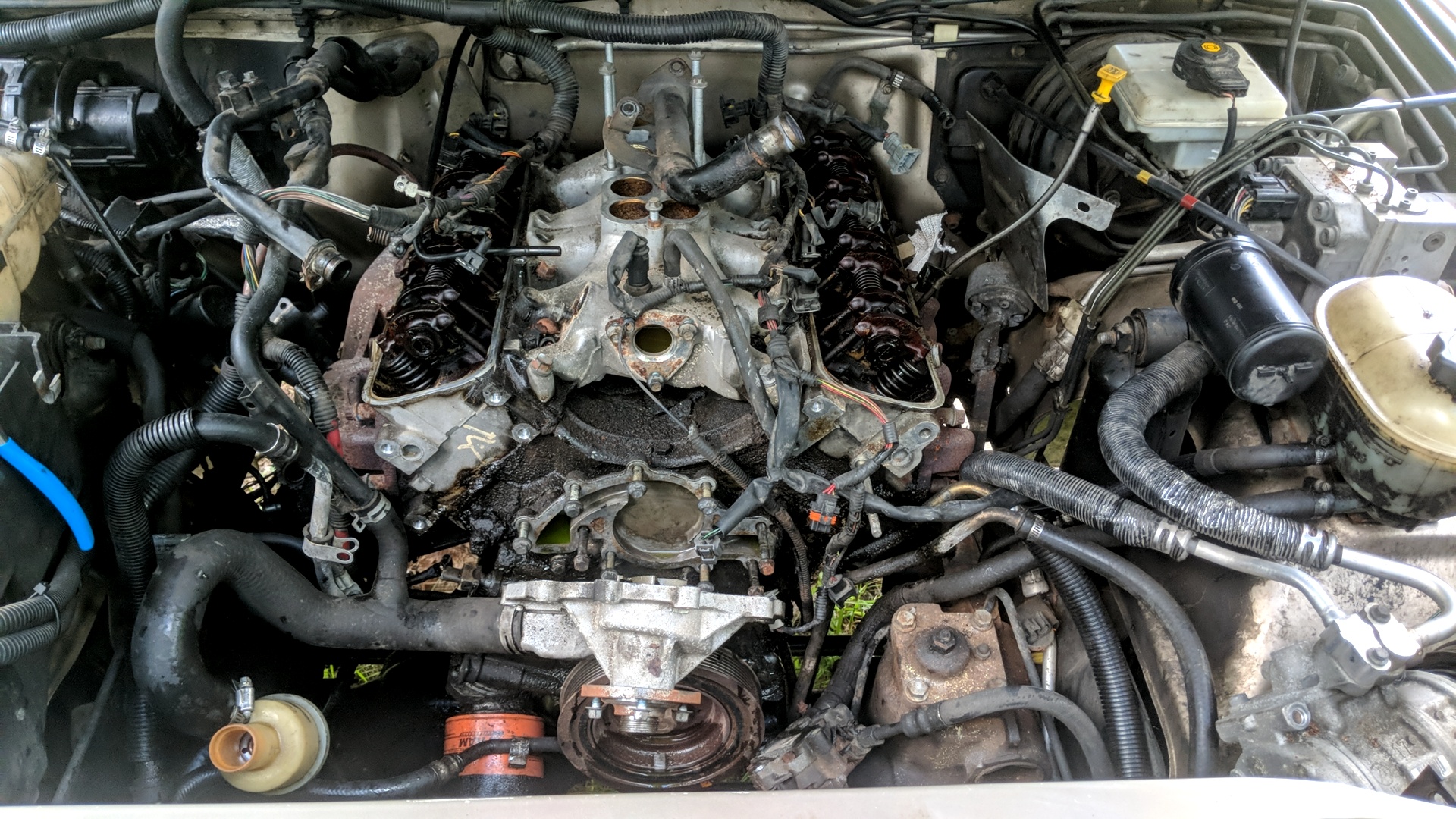

Making some slow progress every few days. I hope I can speed this up soon. I've still gotta get mine apart, too, since I'm swapping the heads and cam over.
