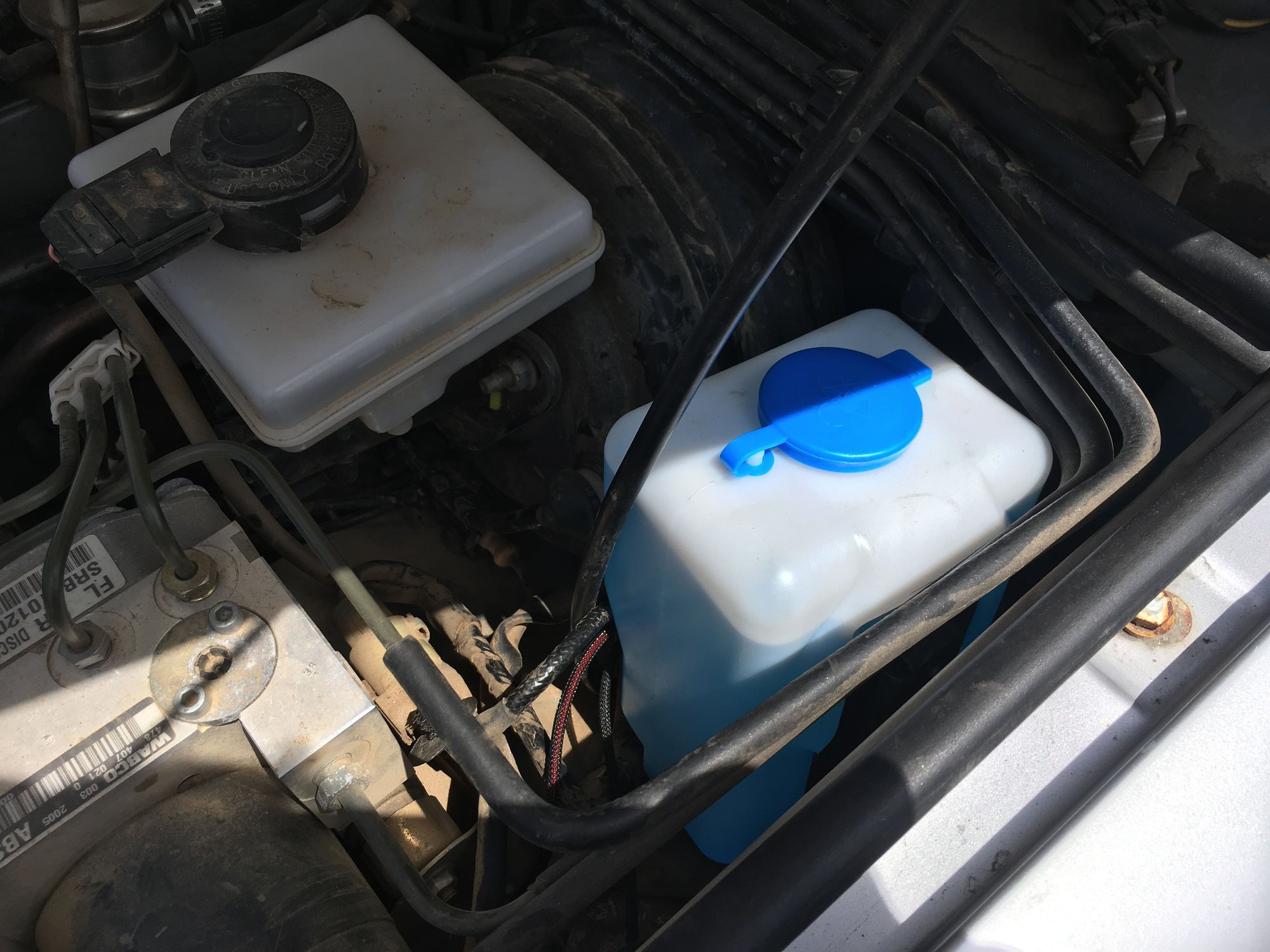

I didn't use any silicone, nor the original rubber seals. I replaced them with those amazon links and they fit perfectly, no silicone necessary
Today I deleted the washer reservoir due to tire rubbing and put in a smaller tank. Saved about 22 pounds (terrafirma bumper washer bottle guard + reduced capacity)
In progress I am working on fitting rear hydraulic bump stops and new springs
