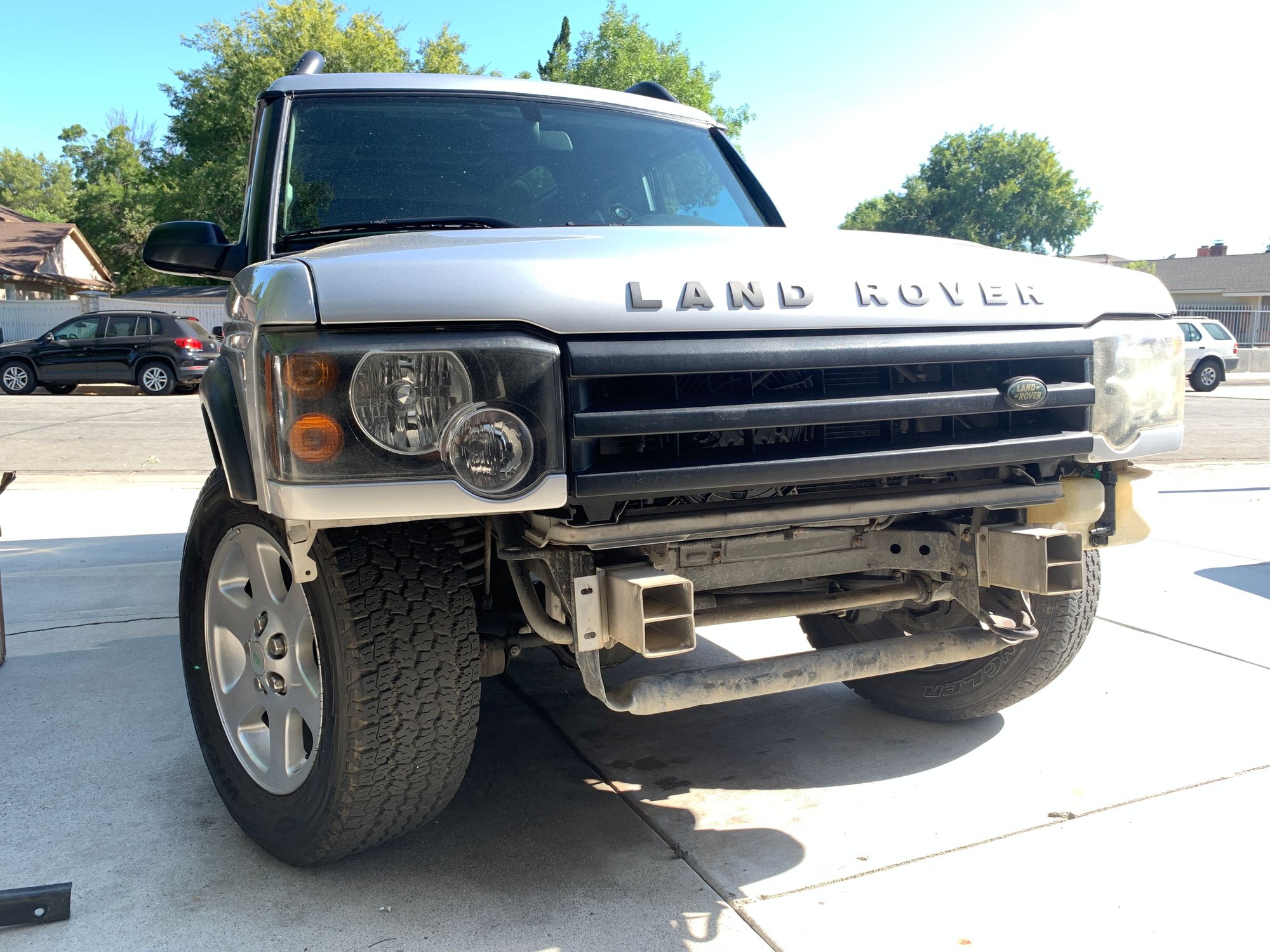

Replaced my front cracked bumper with a used replacement. I was actually very surprised on how little protection is in there. Very pleased with the final outcome.

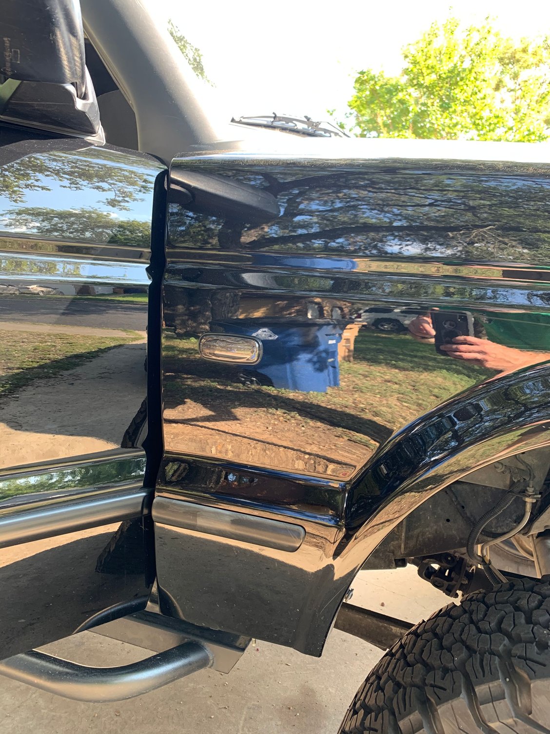

Installed 3 black door cards. Now just need a driver door one and installed these led turn signals from eBay:

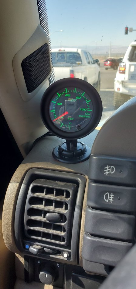

Finally got around to 3000 mile oil change(15w/40 Rotella) while installing the Glowshift oil psi gauge with the sandwich thangy for the sending unit, the Mann oil filter I picked up was too long to fit with the sandwich plate so I threw on the K&N filter I had in the truck.
20-23 ish PSI hot idle, Good Great Horrible i dunno, runs about 50psi down the road at 190 deg
