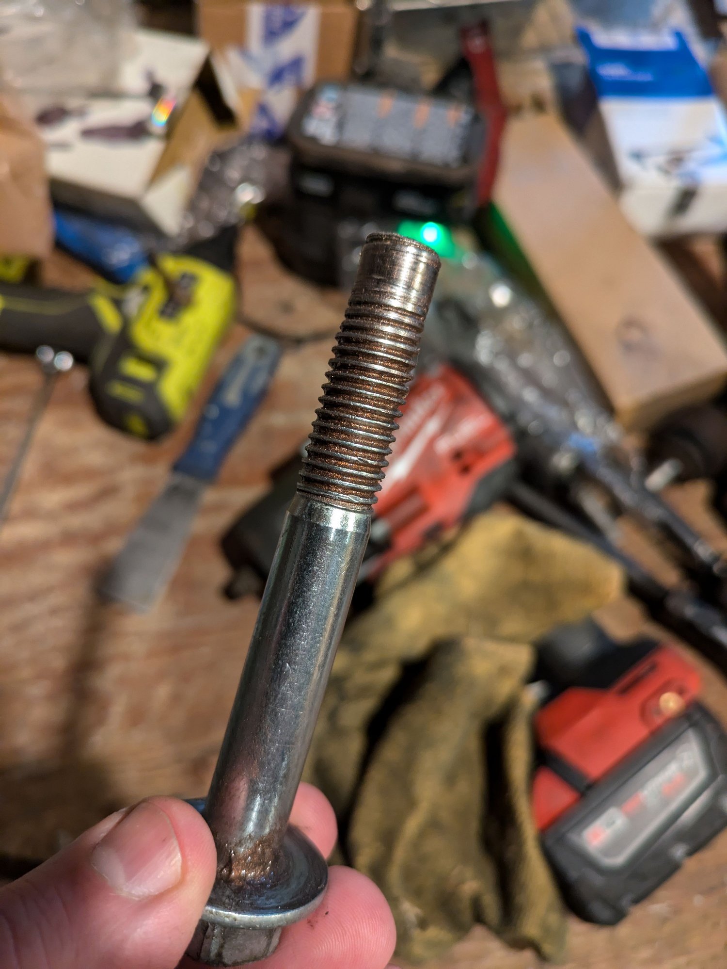

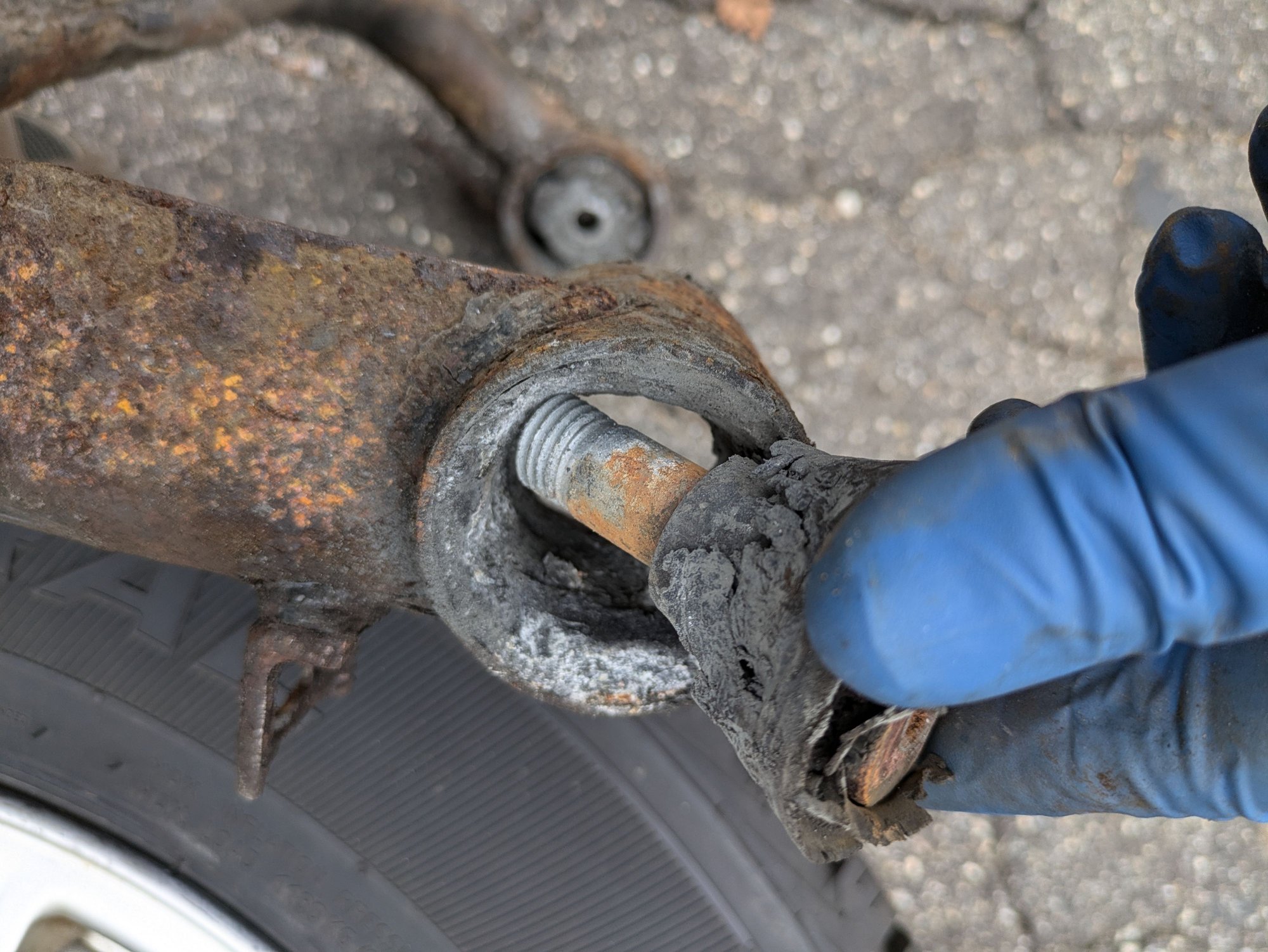

Default Replaced all rear control arms
Replaced all the rear control arms and all four struts. Destroyed two new bolts from the Atlantic British hardware kit. Would not recommend they're hardware kits.

Agreed on the kits, inferior quality. Really need the OE Land Rover hardware.

When I did my rebuild I ordered from LR Direct and got all new OEM hardware when possible with only a few nuts or bolts and such being from Britpart - which often ends up being OEM anyway. That is really disappointing to hear about AB!
