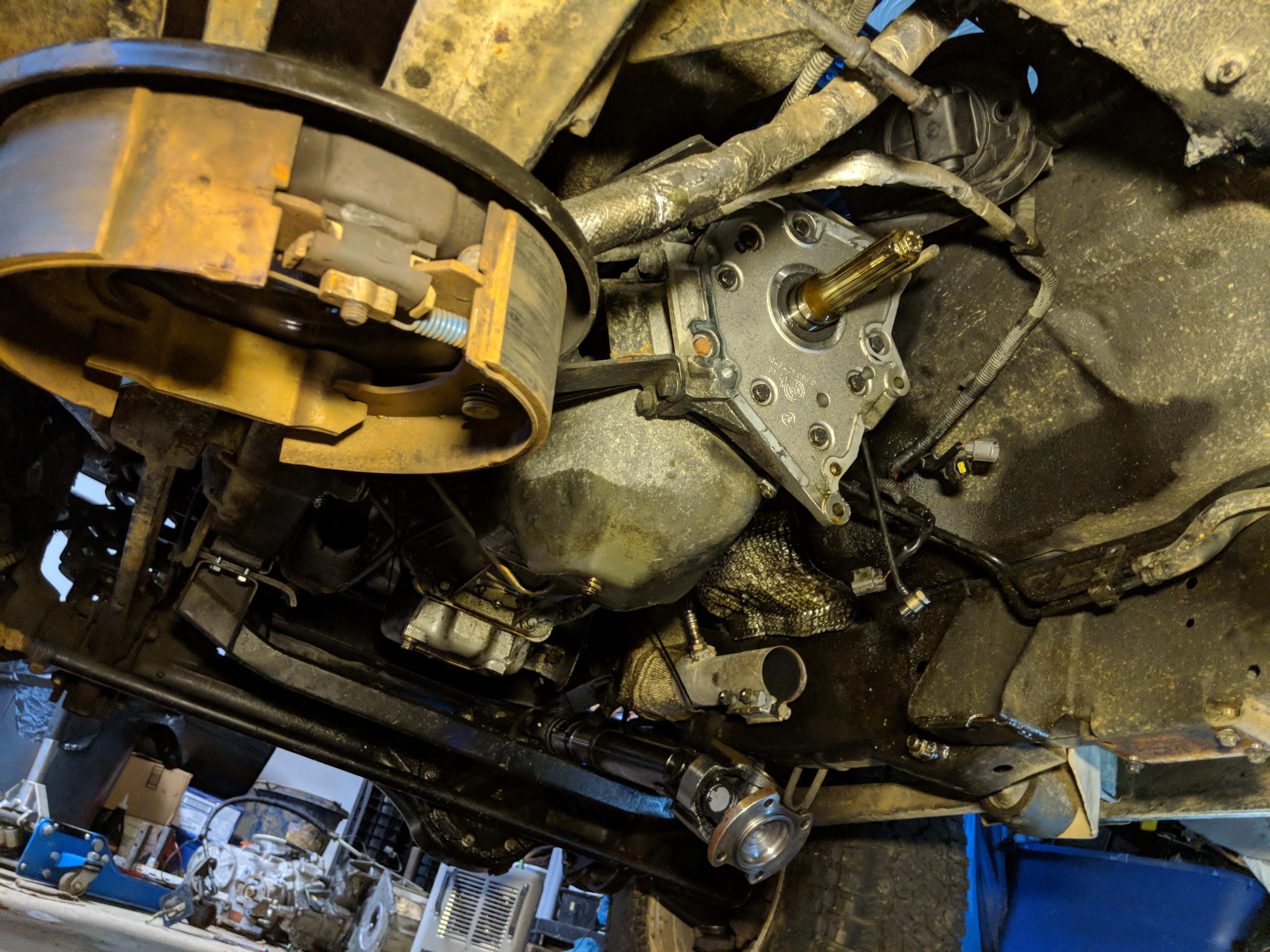

Finally got the transfer case out of my 03. Gonna have some lunch and go try to get the 04 transfer case in.
