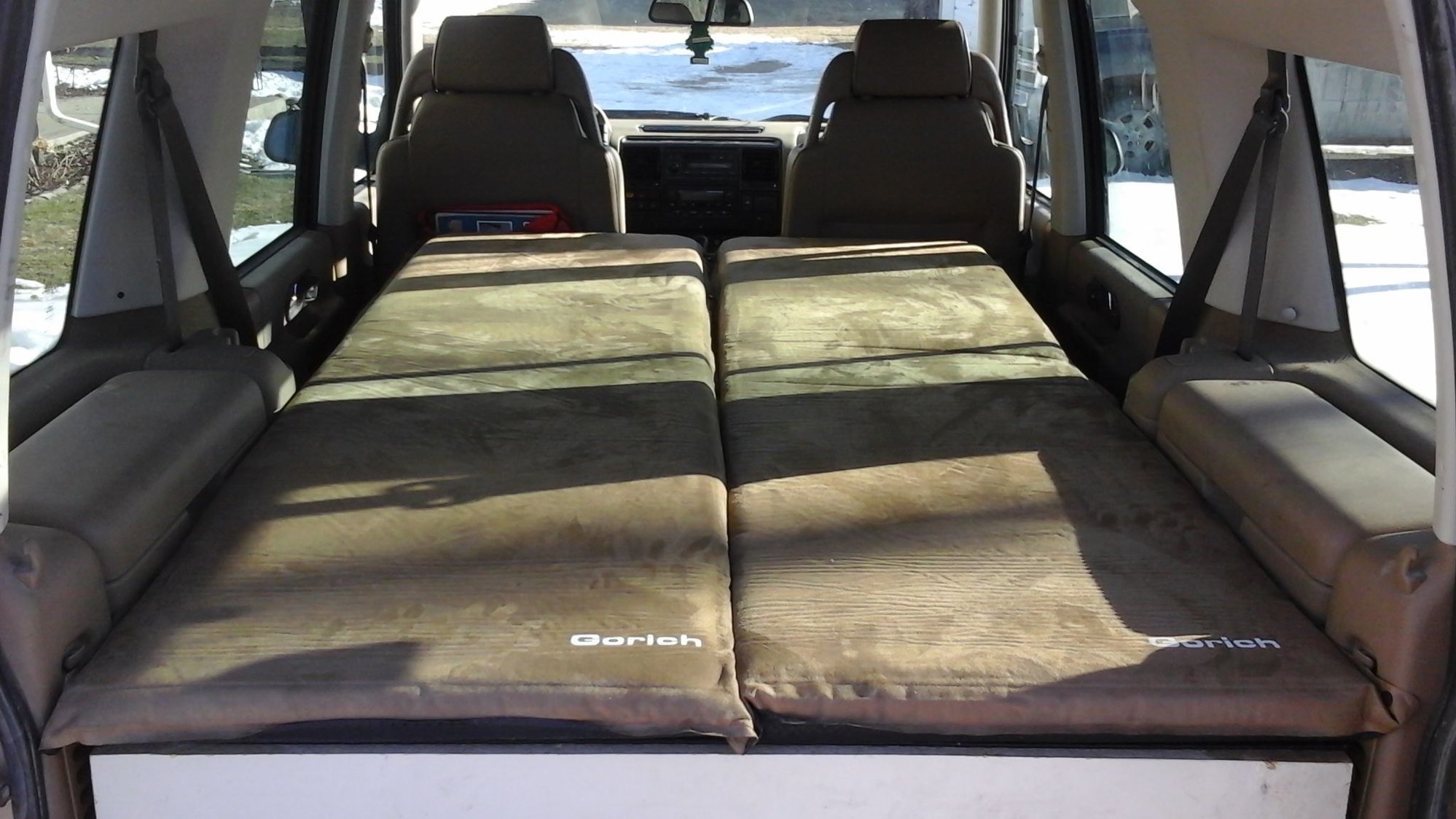

Default Added roof rack, ladder and sleeping pads.
Roof rack.
Ladder.
Sleeping pads, self inflating.

Looks awesome Brian!

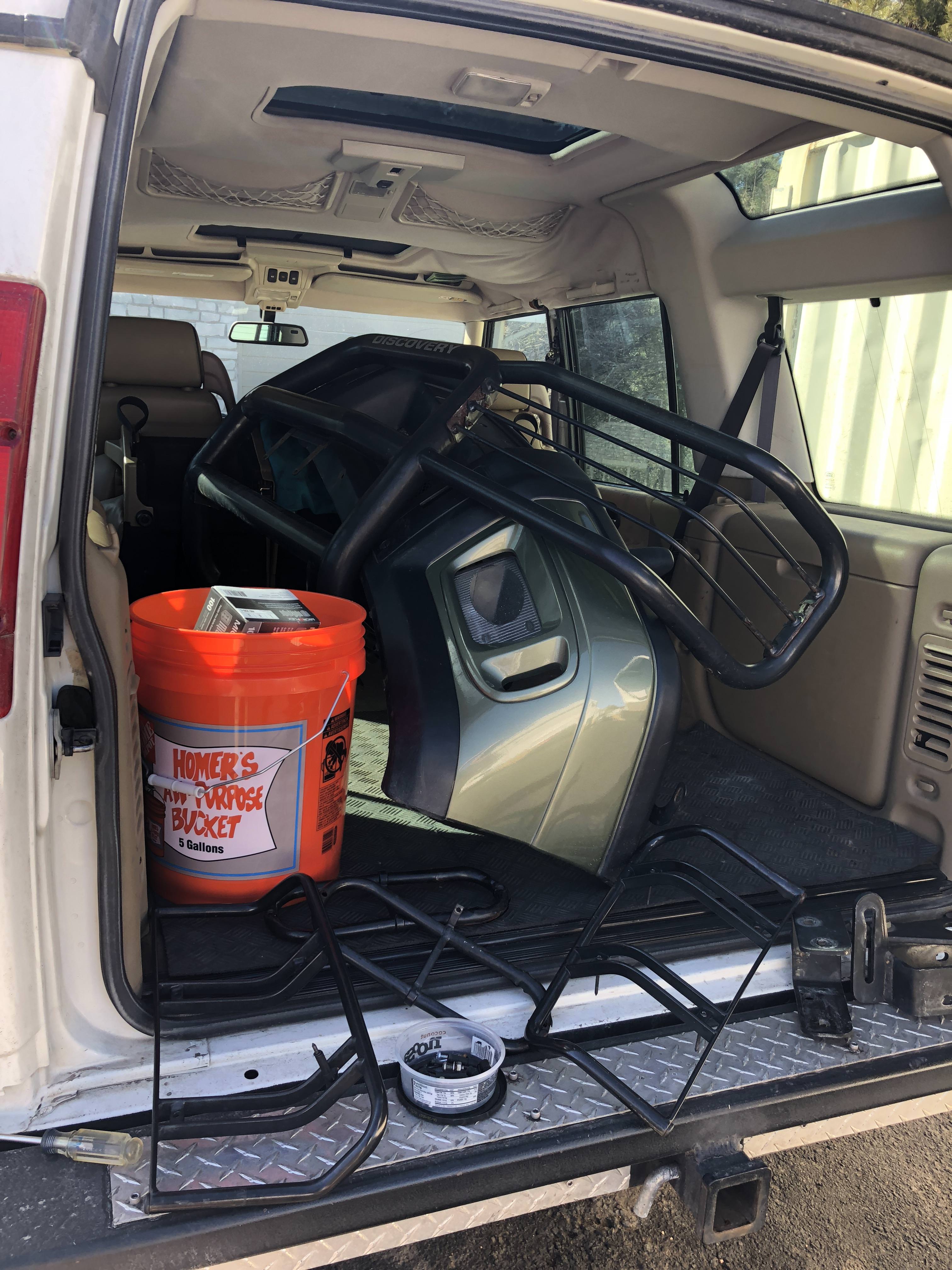

Look what $95 got me today. MagPie is getting a facelift. Overheated twice to get the parts sooooo.. Ordered a new radiator in hope the one in MagPie is the original and probably dead.

Awesome deal^^^^^!!!!

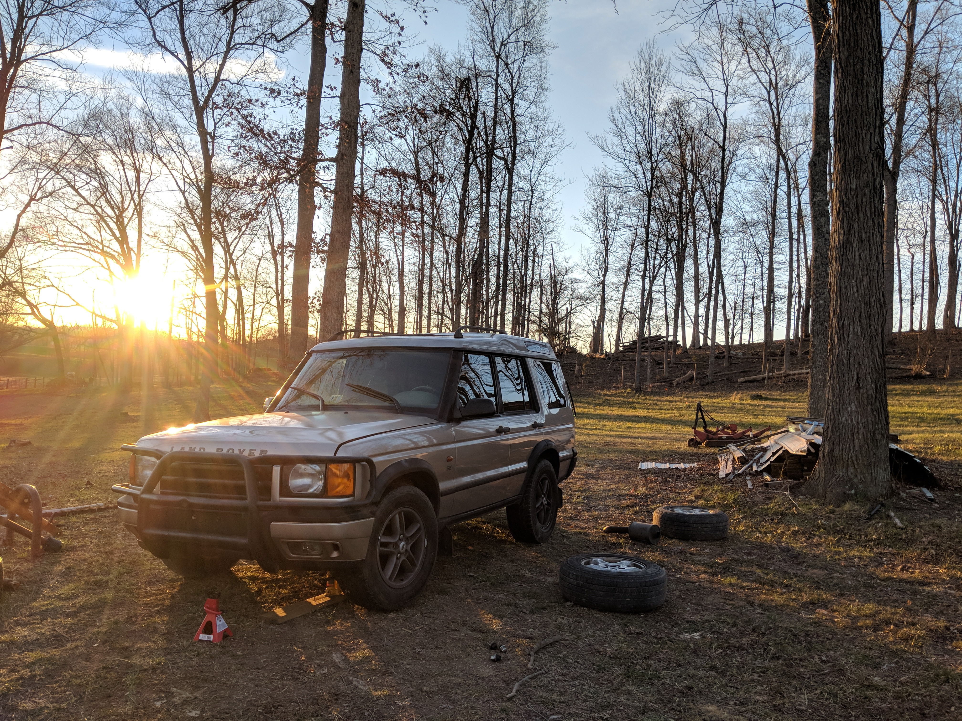

Got two of those 265/65r18s on the little lady's truck. Not a ton of tread left on them, but enough to get through the summer. Better than the ones that had worn down to the bands on one side. Looks a whole lot better, too.

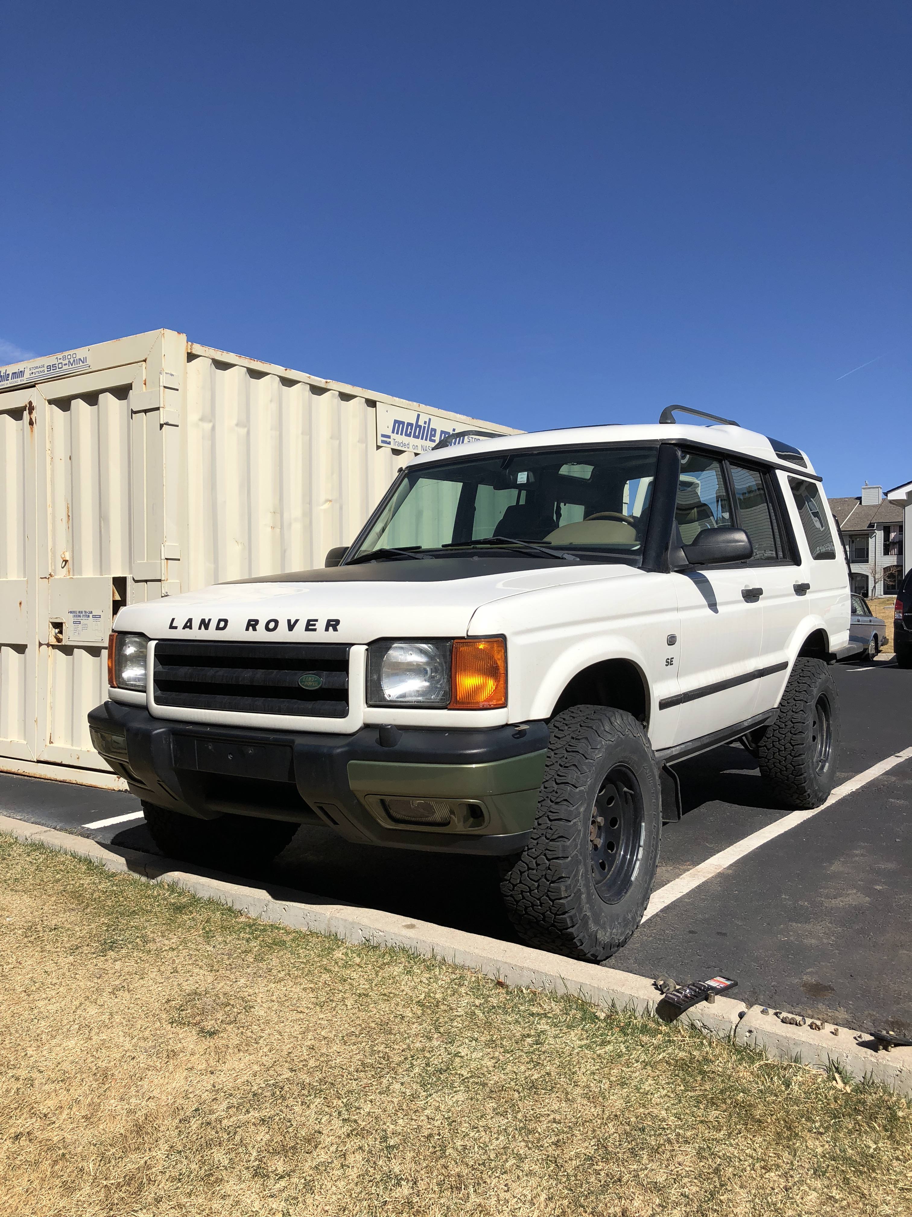

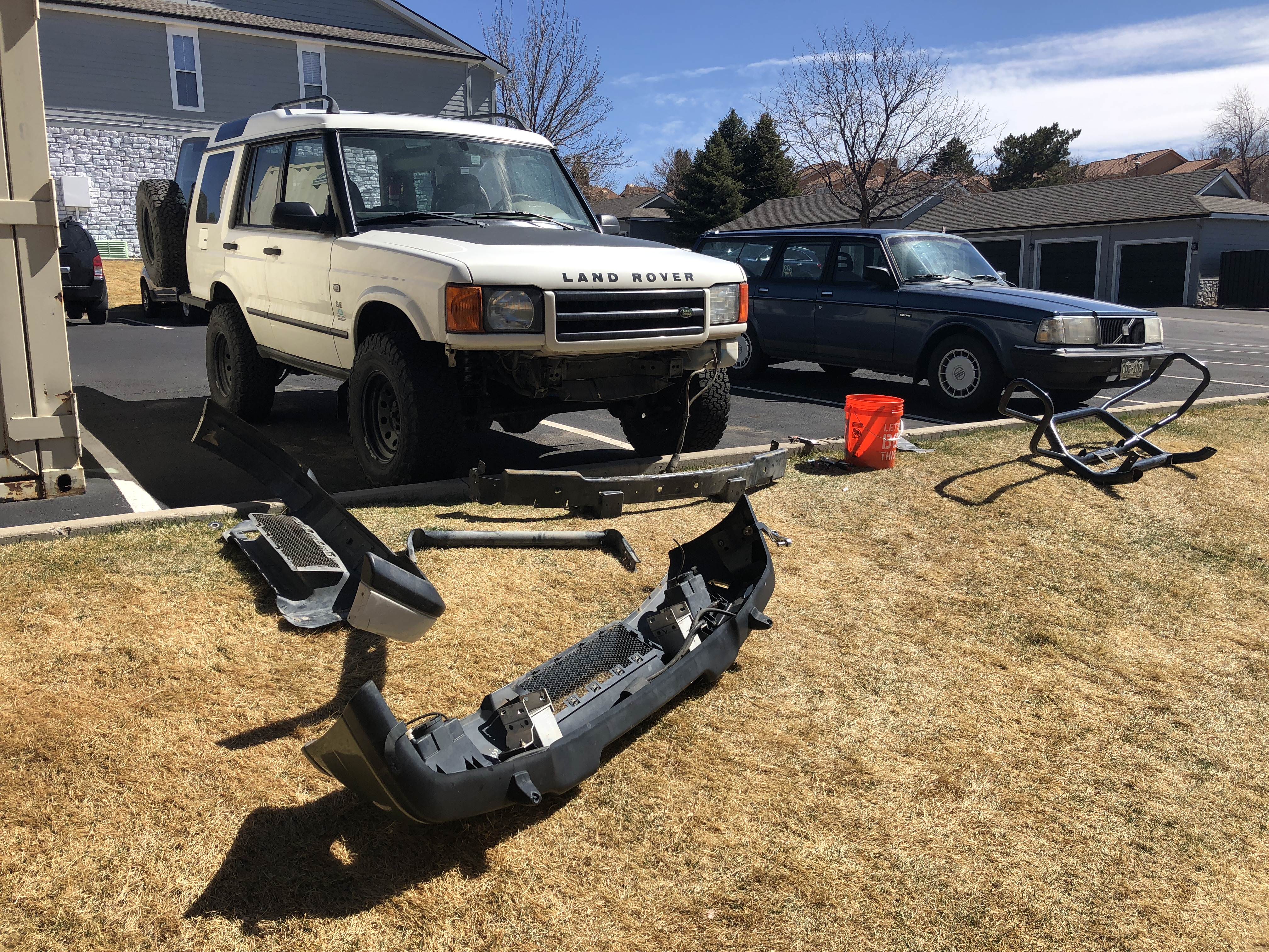

Played face lift today. Kind of annoying to do this job alone but the Wifey came and helped right at the end. Have to do some fabrication to the brush guard so that'll go on at a later point. I kinda dig the 2-tone

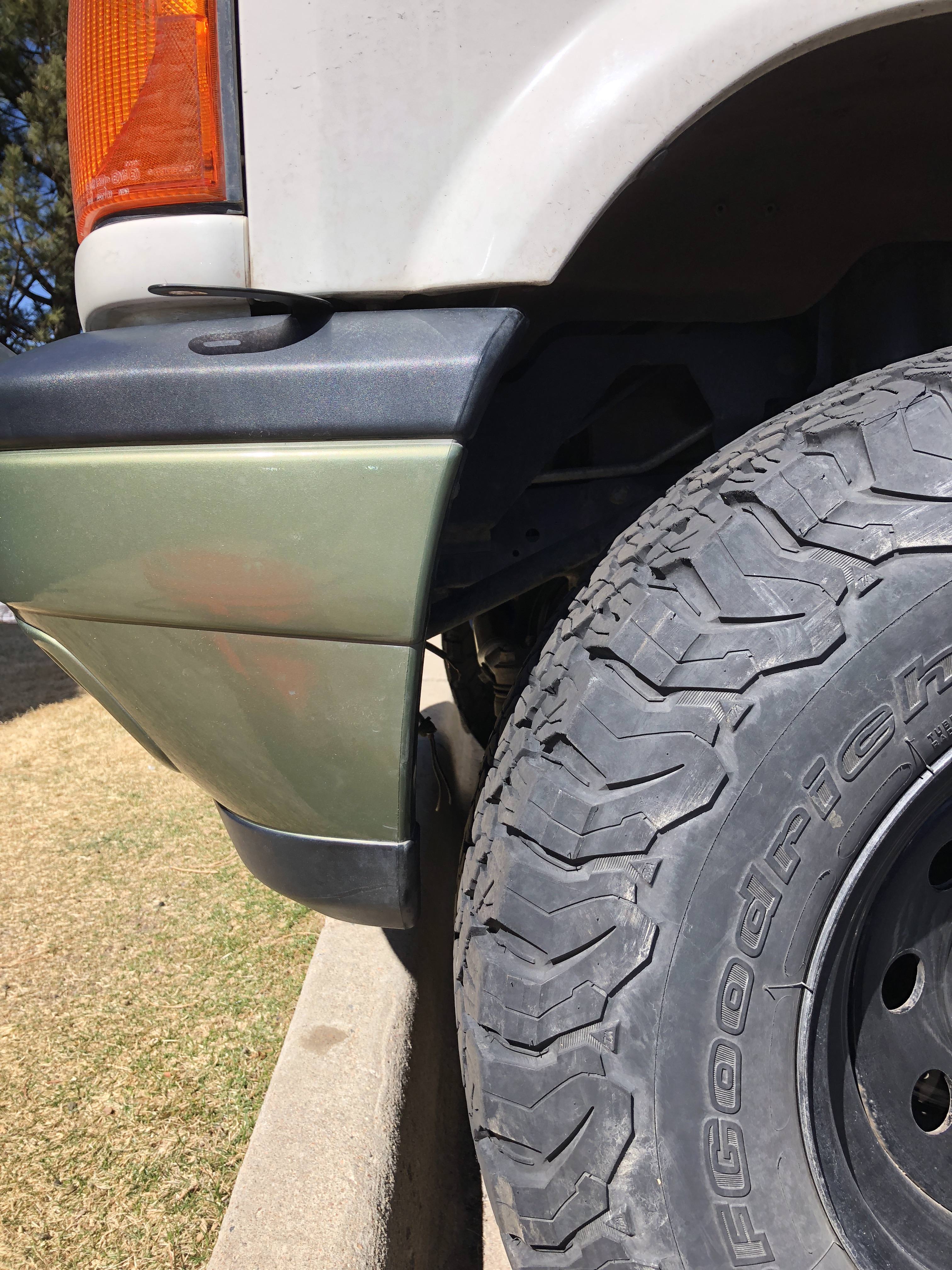

Gotta do some trimming.. Any tricks or tips or just go at it carefully?

Milwaukee 6 in. Folding Jab Saw and sandpaper. I can't remember the grit but I used two. One to remove the edge from the saw cut and the other a fine grit to smooth out the edges. Actually, block sandpaper for the smoothing of the edges. Painters tape to tape off the line you want to cut. I removed my end caps from the bumper and did the project from a tabletop. I also practiced my first cut on a spare end cap before cutting the one's for the truck. Now, if you aren't a perfectionist and just want to cut the suckers off, use whatever you got and let er' rip.
