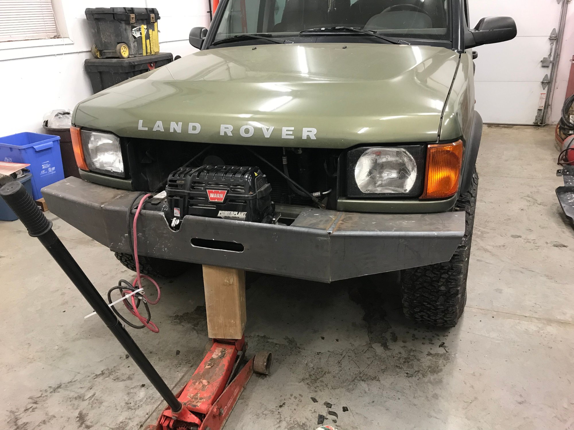

Lol it will actually push back in at least 3 or more inches when it’s mounted, it is only on jack stands to help locate stuff. I might even trim the grill to recess it in further. I do want enough real estate there to stand on. It’s always easier to grab a winch cable by standing on the bumper than in the mud.

It took forever for final positioning, got it as close and as high as possible without cutting up the rad support, I will definitely be cutting/trimming the grill to clear the winch. I almost raised the whole bumper another 1&1/4” which would of brought it up to the bottom of the headlights but I feel it would of put undue stress on the frame as it would of brought the winch mount above the bottom of the frame rails
